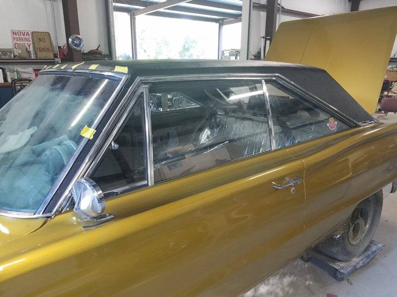

I've never had the opportunity to get a close look at a 66-67 with a vinyl top. Would anything be required to install one on a car that originally didn't have one? I know some other cars have different trim to accept/hide the edges. Thanks

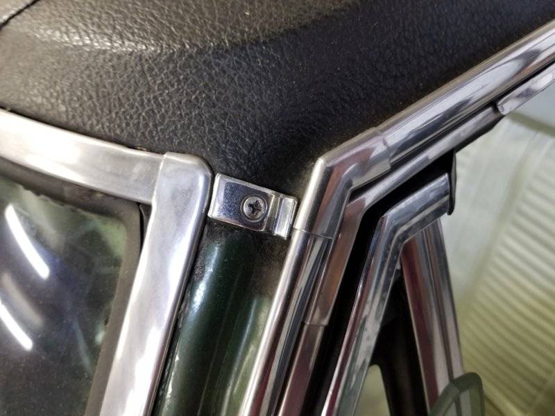

The only thing needed is the trim pieces at the top of the A pillar.
Thanks guys, that's what I figured. Can only blow up images so much.
You can run the vinyl down the A pillar I think makes a better look. Just my opinion
You also need the sail panel trim. I have a burnt 67 that had the dealer installed vinyl roof like 66`s.
The sail panel trim is the same regardless of vinyl top or no vinyl top.

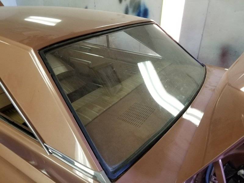

I was thinking of the long trim that goes past the bottom of the rear side glass towards the trunk, don’t know if I explained it correctly.
For the lack of a better picture.
Ah! I was thinking Charger. Did some of the 66 Coronet and Satellites have vinyl going all the way down the A pillar?
Not from the factory. I have seen this done on restorations.
