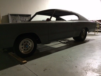

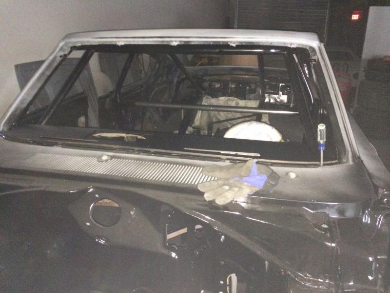

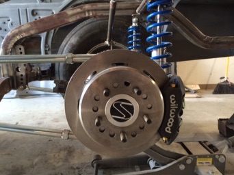

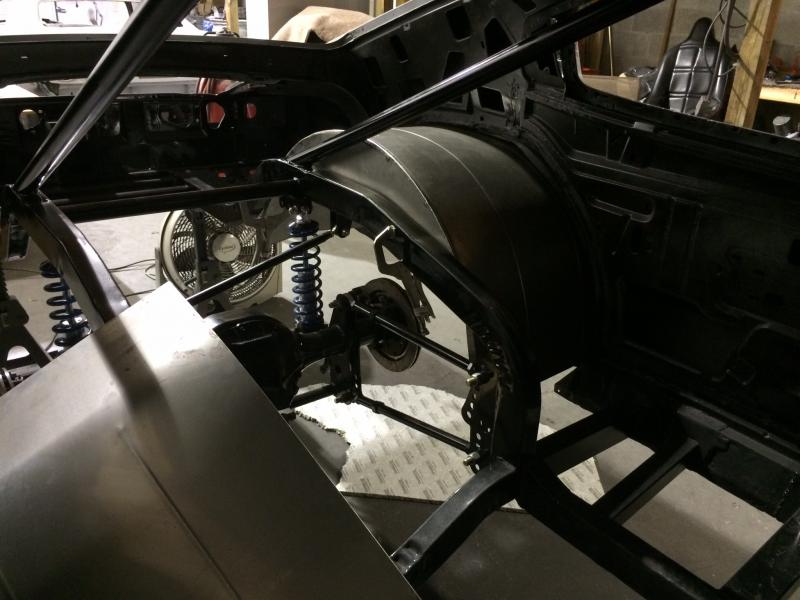

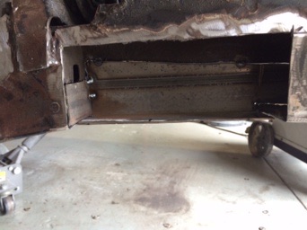

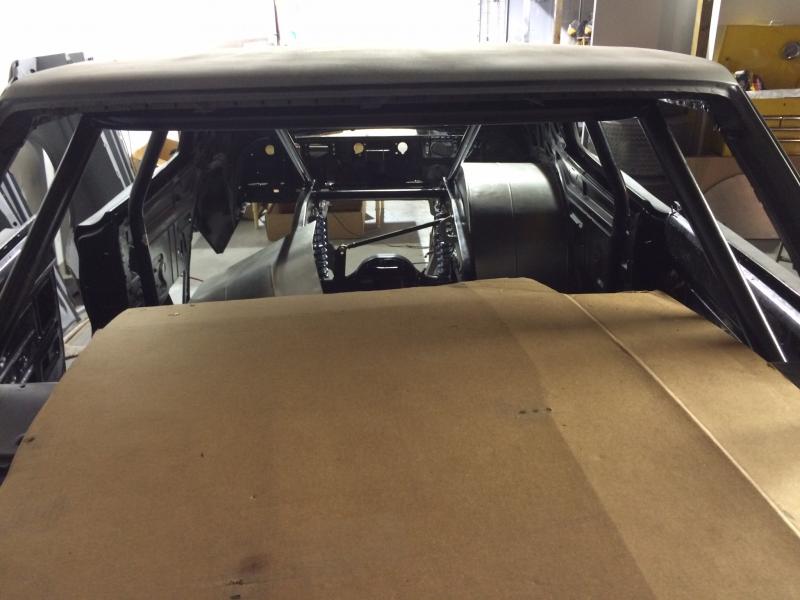

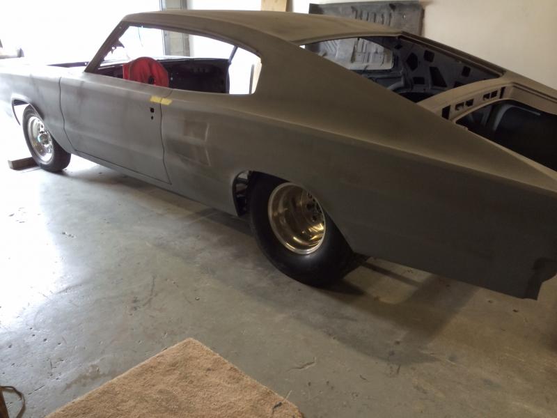

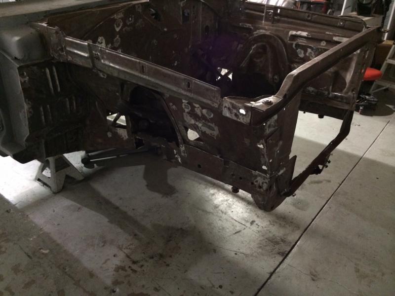

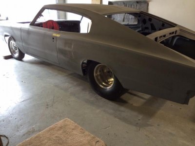

image.jpgimage.jpgimage.jpgimage.jpgimage.jpgimage.jpgimage.jpgimage.jpgimage.jpgimage.jpgimage.jpgimage.jpgimage.jpgI have not posted about this car in almost a year. Work family and money, mostly work getting in the way..... First car build,

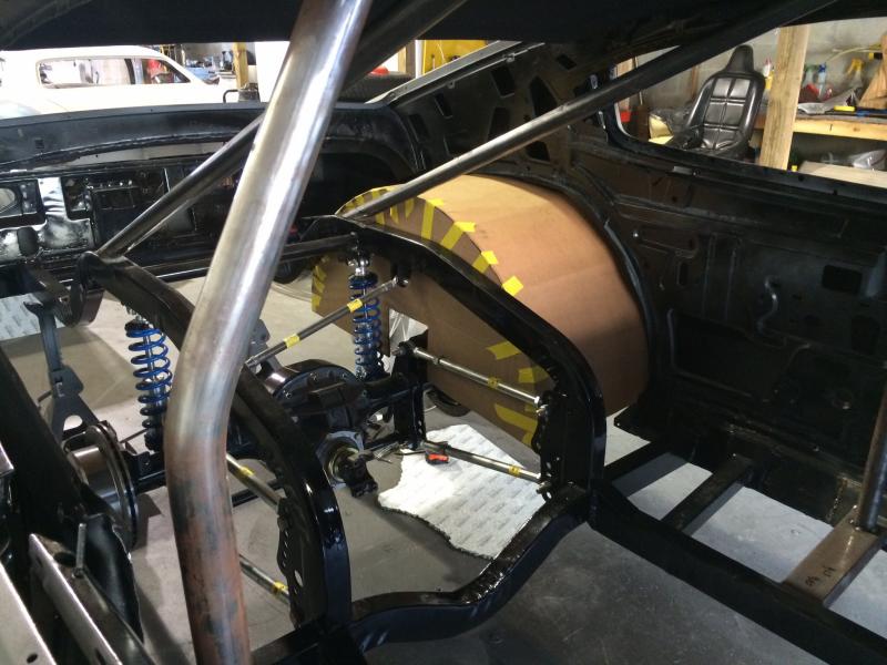

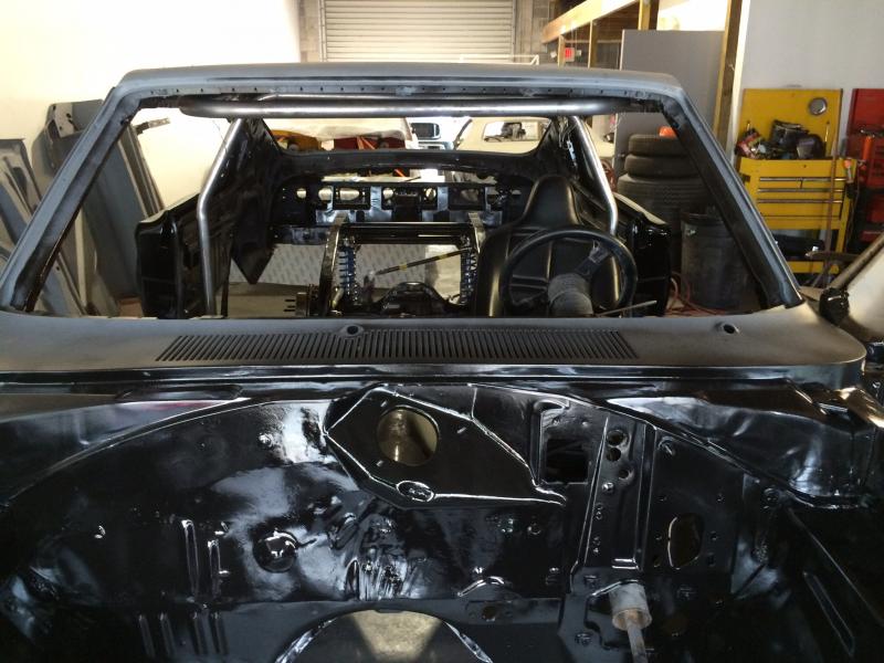

trying my best. Almost ready for paint. 440, 727 auto trans, wildwood disk brakes, S&W back half kit, 4 link, S&W narrowed 9 in. Strange center and axles, 31 spline, 355 highway setup and 411 strip setup. Qa1 coil overs, stock front setup with wildwood disc coming soon, 33x19.5x15 mickeys, 10 point S&W roll cage tig welded, will probably add more supports. I would like to setup with nitrous, not sure when, and yes cut the chrome off the sides of the car, looks better in my opinion. I purchased the car as a former race car, could not be saved as original, but pro street was halfway there.
Will be black on top and silver down the sides. ONE DAY AT A TIME.
