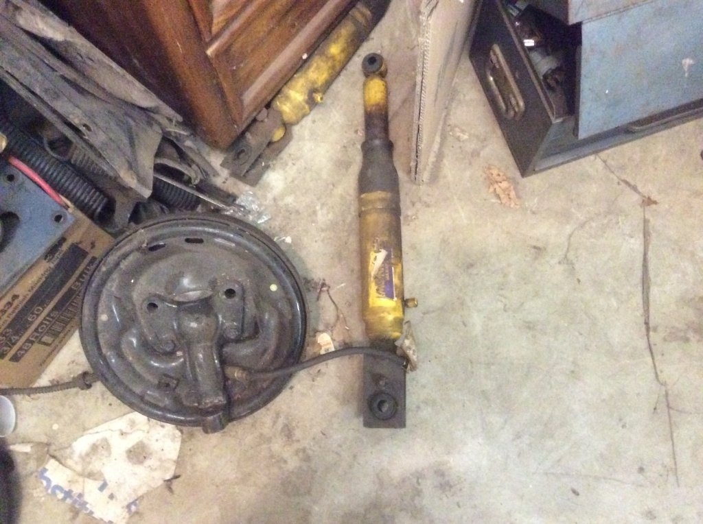

Thought I'd add a picture of shock extensions. I mounted mine on the top of shock. Most people mount them on bottom. I don't like the way they look, UGLY IMO. I'd dog ear the upper corners. Used air shocks because I was running L60 15's and needed to raise rear an inch or so.

I need measurements to make my own shock extensions (was going to ask PurpleBeeper but he has a full inbox). I need some exact measurements for the holes and such. Anyone else have some available to look at? The only source I found that still sells 'em won't ship to Mexico, so going to fabricate some. Thank you.
