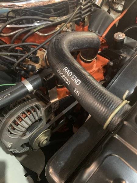

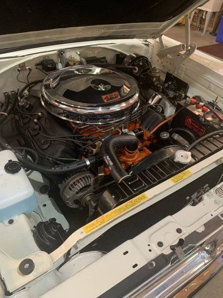

I kind of wondered about that from Frans pictures of it. I noticed it looked to have a wider spacing from the radiator fitting to the thermostat housing than the other one. Looks like it gets into the fuel line pretty good too.
I did what GTX6970 did. I got the AC Delco hose pt# 22025M. Closest one that I can find. It Works with no kinks or issues
