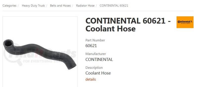

This number is the date code and the plant where it was produced. So I believe 341'st day of 2002. The AU used to be the Lincoln Nebraska Goodyear plant. If anyone has noticed-you don't see Goodyear hose or belts anymore. They are now Continental. Another hose that has the dip in it is the Continental 60621, if it's available yet. It fits in the same place as the 60664. That angled water neck make the 60664 not fit as well as it should.

Just ordered one 60621 the last they had. Hope for the best.

I’ll be curious how it lines up. The upper part that connects to the radiator looks pretty short compared to mine and others who have posted. But just because someone stamped a Mopar logo and part number on mine doesn’t mean it’s molded like the originals.

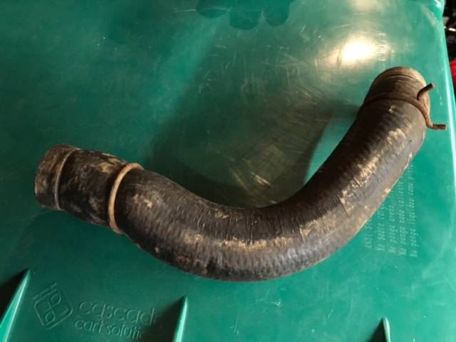

I dug out the original. It's really spongy and I don't see any of the original markings on it due to it's condition. I didn't spend any time trying to clean it up - had to remove a bunch of white crap from the driveway.
Which end is the radiator end - any memory on that?
Hose may not be right. They're drop shippers $14+in handling fees plus $16 for the hose. Tried to order 2 but that was the last one was thinking you might want one.
Edit: $14.50 Fedex $5.50 handling charge.
I’m having a hard time figuring how that hose would fit but maybe so.
