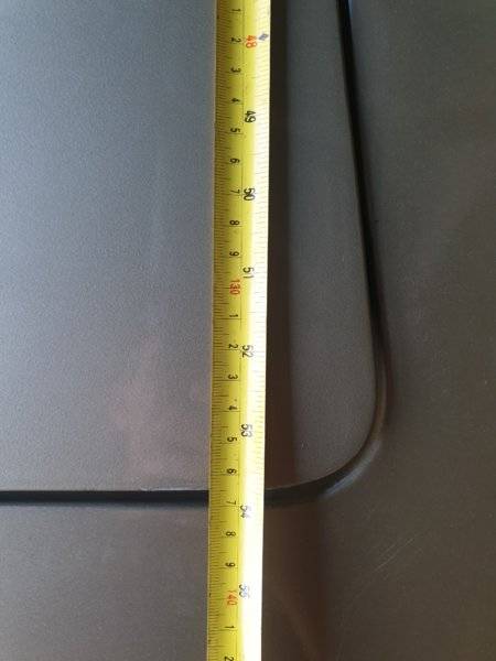

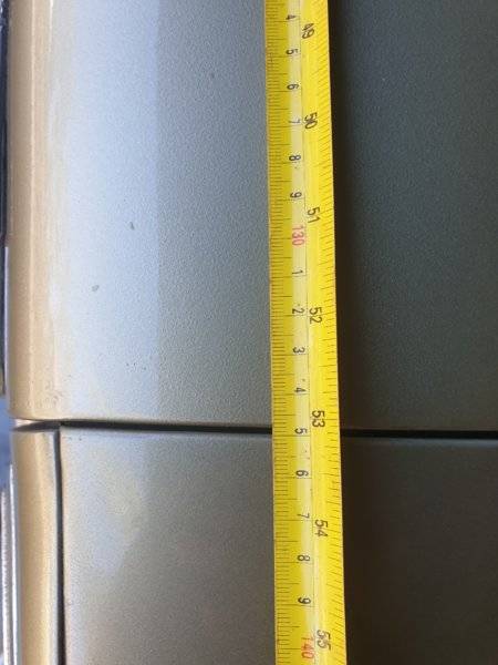

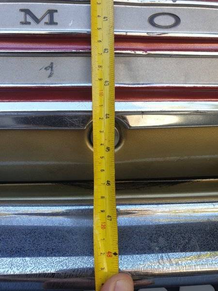

Measurements as per attached photos, rear of lid first
Thanks for all the input. I compared the measurements, they appear to be the same. FBBO has great members who provide a lot of help and knowledge!

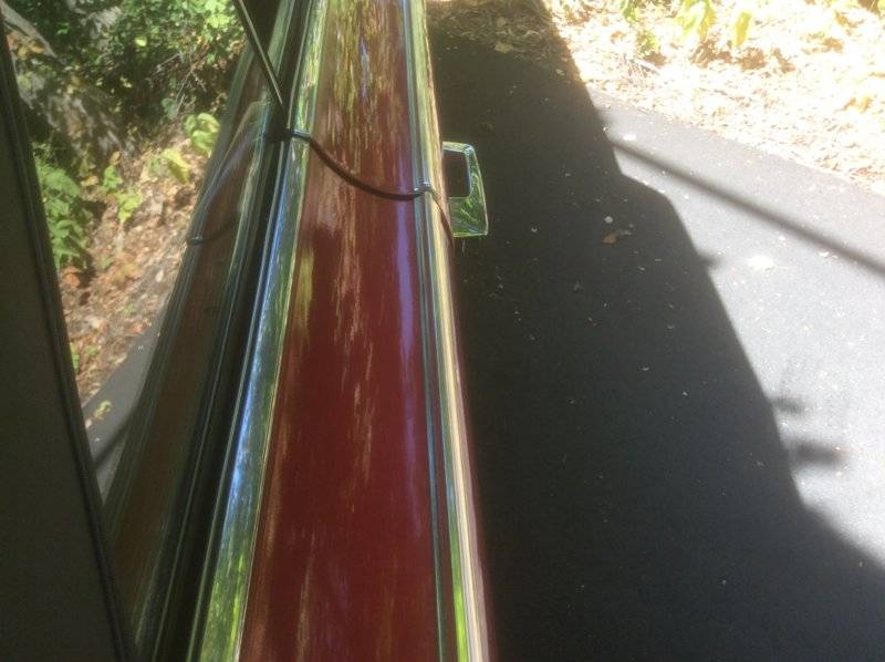

Just to completely answer your question are the deck lids the same? YES looked in my parts book only one number 2576191. Rest easy. The only body panels that are different are the quarters which isn't hard to guess. I go crazy when questions like that pop to my head. How is the fit of trunk lid to quarter driver's side corner nears rear window. Mine is horrible 1/2" gap at corner. Should have had that corrected when I had it painted 40 years ago.

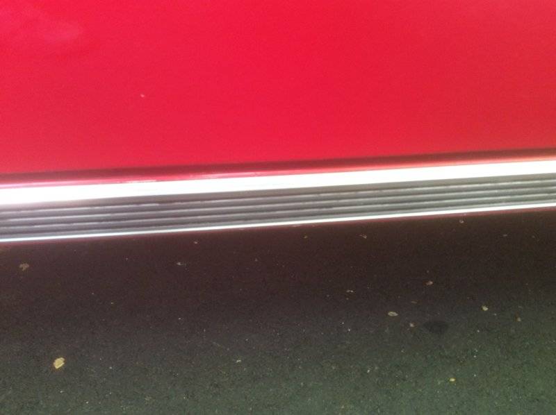

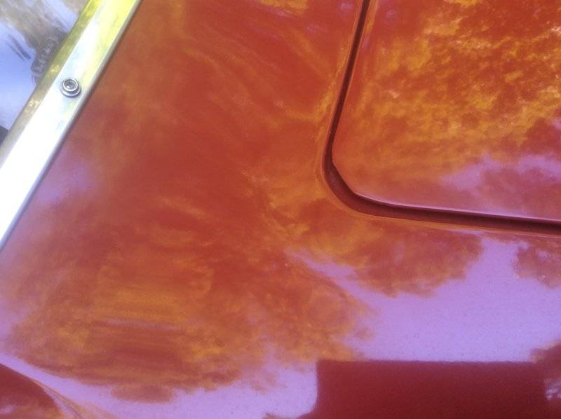

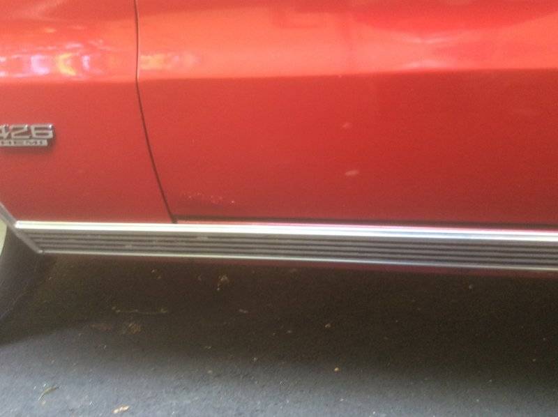

My trunk lid is rotted at bottom from water leaking through truck panel holes. Bought a lid to replace it 20 years ago. The fit of doors and trunk is piss poor as you'll see in pictures. The doors and trunk have never been off the car, check door gaps on bottom and top of passenger door. The trim holes I think are part of the problem. Are yours the same? My car is a St Louis as all convertibles are March 8th production date.
