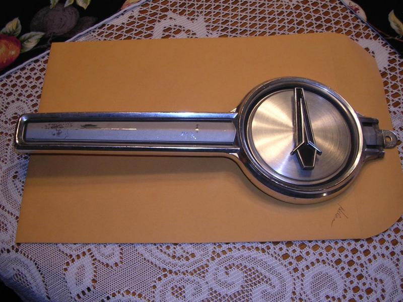

Has anyone tried to replace the gas cap on a 66 Belvedere II (with the side trim) with a 67 quick release gas cap. I don't have the 67 measurement so I don't know if it would tuck in behind the 66 trim piece and fit within the circular area of the trim and still work.

Never tired that but being the 66 Belvedere II trim is there and the 67 does not use similar trim as the 66 and the quick release cap fits to the body panel, I would say the quick release cap from the 67 will not fit with the 66 Belvedere II trim in place.
I tend to agree.
The large, round trim for the 67 cap is an integral part of the operation, and contains a second, thick seal.
This ring actually is clamped between the gas cap seal and the thick rubber seal I just mentioned, by the spring pressure of the cap seal. The thick seal seals the trim ring to the filler neck on the other side.
It would be very difficult, to say the least to use the cap without the ring.
You could trim the molding before and after the new flip cap might look cool but it will not fit for sure. I had two 66's that original emblem gas cap got stolen once .some ******* !! A+a+a+a+a+a+.jpg I like the stock hidden look good luck
Thanks to all for your input. I have an extra trim piece and can pick up a 67 cap cheap. I may try this out just for the hell of it. I'll post pics if I do. Thanks again
