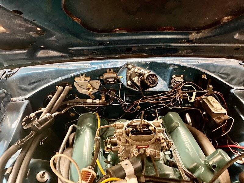

I have a 69 Super Bee with the 330 hp version. Previous owner, now deceased, had the engine and 4 speed trans rebuilt, and I thought he simply did the wrong color on the engine, aqua instead of hemi orange. Evidently this was the norm for some models, don't know whether it was because it was a factory a/c car (with a 4 speed, rare combo), or something else.
I have a 69 Super Bee with the 330 hp version. Previous owner, now deceased, had the engine and 4 speed trans rebuilt, and I thought he simply did the wrong color on the engine, aqua instead of hemi orange. Evidently this was the norm for some models, don't know whether it was because it was a factory a/c car (with a 4 speed, rare combo), or something else.View attachment 1109919
