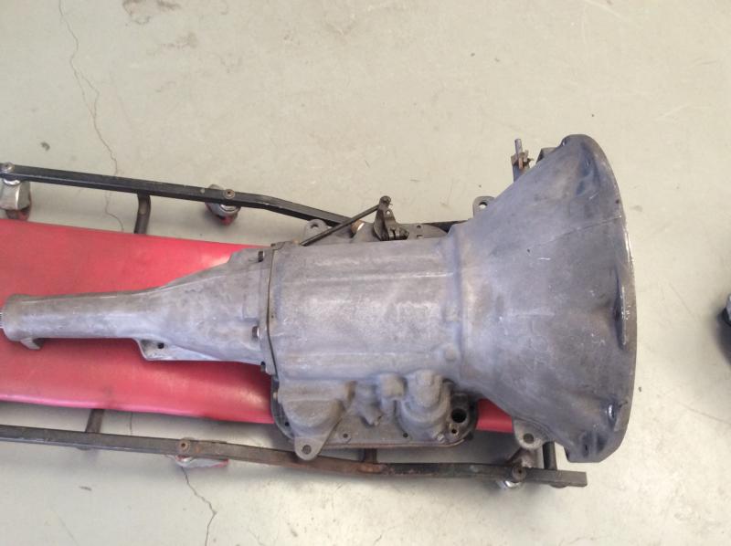

According to the thread "Your 'Guide' to the 727/904 transmission" it is a A/LA engine A727 (top two mounting bolts 7 3/4" apart). The gasket shows a 904/A500 (square with one corner angled). The overall length is about 31 1/2 (mounting face to tail shaft seal). And the shift lever is straight like the 727. Spline count is 18.
I'll try to post some pics.
Here's the tranny.

A-727 transmissions from their inception until 1966 have 19 splines on the input shaft. Non-lockup 727 transmissions from 1967 onward have 24 splines. Lockup 727 transmissions that debuted in 1978 had 23 splines. A-904 transmissions from their inception until 1967 have 18 splines in the input shaft. Non-lockup transmissions from 1968 have 27 splines. The spline count and pan gasket you gave
says it's a 904

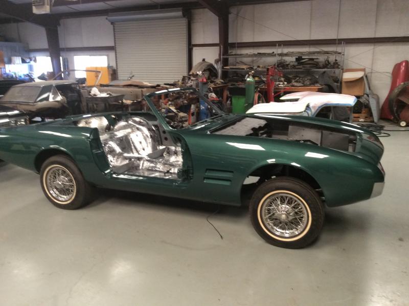

Beautiful car, thanks for posting the picture.
says it's a 904
Thanks BK. The spline count was confusing me. I counted the splines a dozen times trying to come up with 19. Now it makes sense. I have the correct crank and 904 trans but a 273 torque converter. Thanks to everyone for the help.
