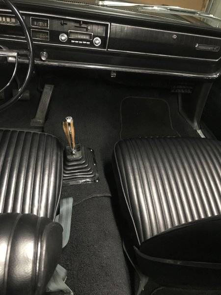

I was told to ask this ? in this forum. (I am a new guy). So my car was originally a 318 with a 4 speed. It now has a 383 with a 4 speed ( sorry I don't know the particulars on the tranny) The previous owner told me that the postion of the shifter as it comes out of the tunnel is different from the 318 cut out. Can anyone tell me if/what console will fit this. Picture is attached. Or any other options for some type of console/arm rest etc.

Maybe it's a rear shifter mount install?? Never seen something like that

Might be mounted on the rear tail shaft boss. I believe E-Bodies used that mount. Might be an E-Body shifter,. So no console is going to be an exact fit. You would need tunnel mods, a B-Body shifter with a counsel shifter handle. Then you need to find counsel mounts and all the counsel parts. Easily 1,500 by the time your close to done.

I have never seen a 4-speed behind a 318 in a B-body. Either automatic or 3 on the tree. 440 series Coronets always had bench seats. Buckets and console in Coronet 500 or R/T. If your car does not have factory floor reinforcements near the transmission tunnel, it never came with bucket seats. It looks like E-body transmission with rear shifter mount. Stock shifter for '67 B-body would be farther ahead with long Inland handle with "T" reverse lock out, regardless of engine. This car has been monkeyed with.

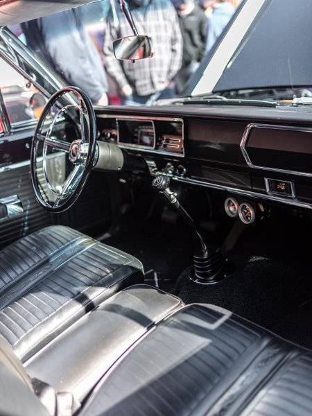

What it should look like. Plymouth version.

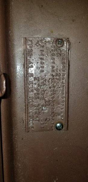

It shows the 318, but no 4-speed, that would be shown on the fender tag, if it's still with the car.
Bottom line WP 23 41 5
The 5 indicates a automatic and a 3 in that place would be a manual transmission.

View attachment 1432375Bottom line WP 23 41 5
Ahhhh so it was a automatic originally.
The fender tag is missing unfortunately. Thank you Jerry.
