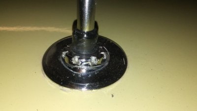

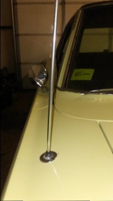

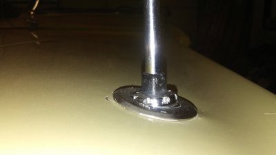

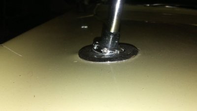

Here is the antenna on my '66 Coronet. The base is canted to the slope of the fender, and the mast is perpendicular to the floor. Hope this helps.

Thank you for the photos Patrick. They explain everything. My mount is much further outboard where it's more flat. Probably done after production. Yours looks like the bezel Herb's supplied. Decision time.
