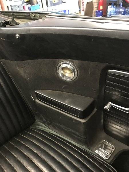

I want to paint the rear/backseat interior panels. They are currently flat black. Any specific paint I should use or prepaprtion of the panels prior to painting them? Also where should I buy the correct paint.

Are these metal panels, or the vinyl covered door panels. What color do they need to be? Are you freshening them up or changing color?
Then the semi textured paint will work but you will need two part flat clear over the textured for wear resistance.

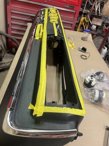

Option 2 is adhesion promoter ppg dbc base with sl1999 additive for texture and dx57 hardner blended in base for improved durability. Then flat gloss or low gloss ppg clear coat with Hardener 3 -4 coats works like a champ. The dash was done with ppg and looks really nice.
