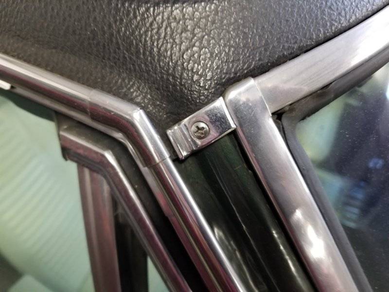

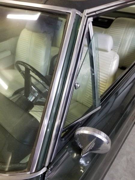

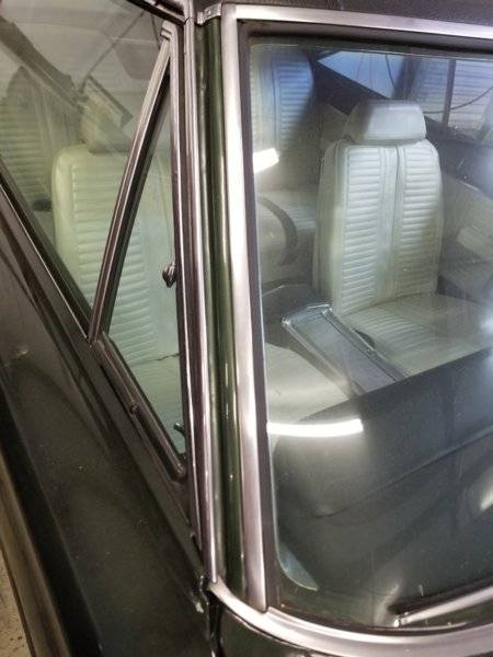

I will get you a picture this afternoon. I'm not with my cars at present.
This is an original vinyl top on this car. Car has only had a respray of the original green, about 25-28 years ago.
