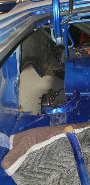

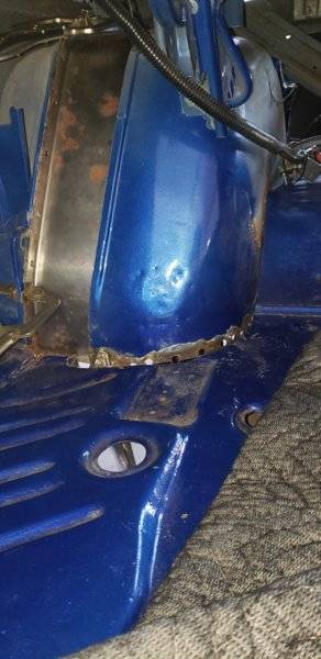

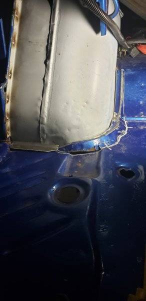

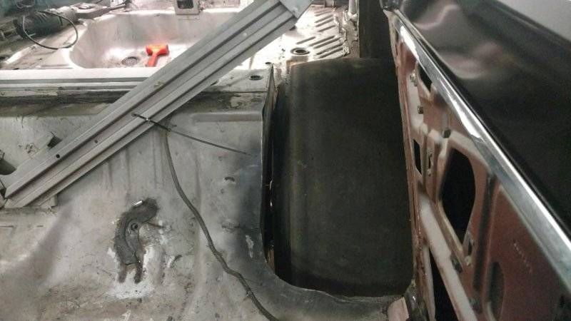

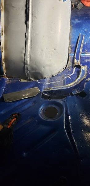

Made a little progress on the mini tube, kinda wanted to make it look as original as I could..

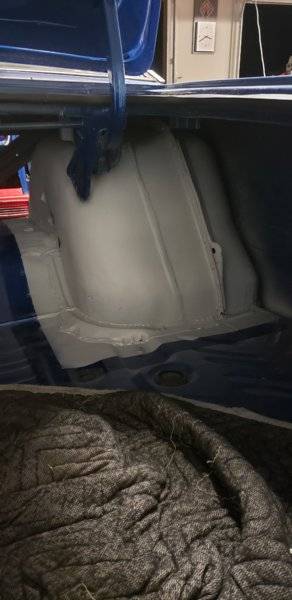

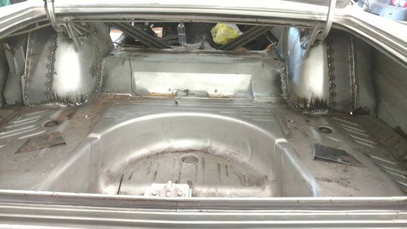

Just noticed that I cant close the trunk lid. The hinge is hitting the wheel well.Made a little progress on the mini tube, kinda wanted to make it look as original as I could..View attachment 791886 View attachment 791887
Something on the back side of the hinge is hitting the tub about halfway down when trying to close it. Are those supplied brackets just fillers to connect the hinge back to the tub? I'm an idiot, I welded those in to support the front side of the wheel well.it fit perfectly. Lol
Thanks![QUOTE="Are those supplied brackets just fillers to connect the hinge back to the tubQUOTE]
Yes that's what they are for...... I think there was something in the directions that said you can get in the trunk with a helper and close it then mark the spot it's hitting then wack with bullpen hammer

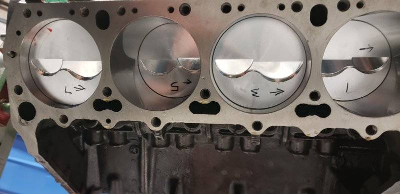

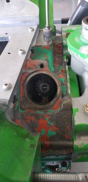

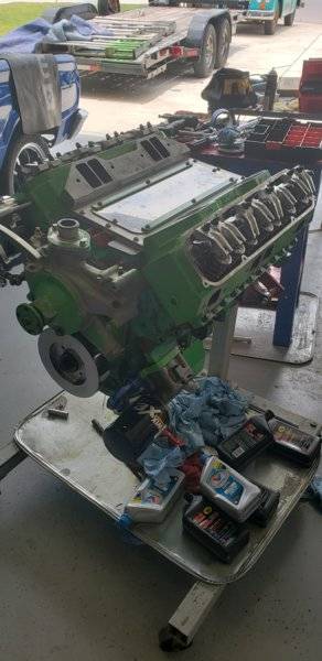

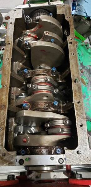

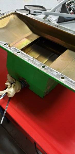

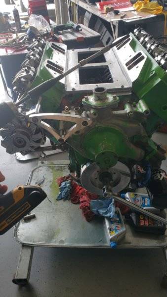

Primed it up, oil on both rocker shafts.dropped the pump shaft in.Got a little burnt out on body work so started putting the rotating assy together. Installed the bulkhead, filled the pan with water to check for leaks.View attachment 793036 View attachment 793037 View attachment 793038

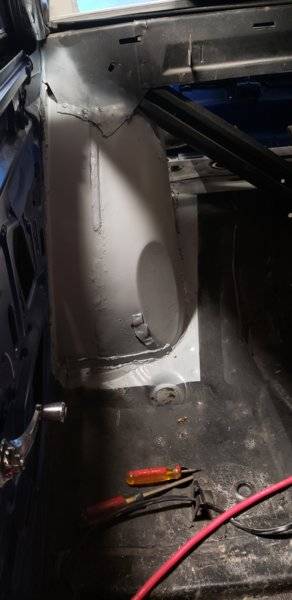

Working on the d/s now. How did it take to complete y'alls mini tub? I have probably 4 days in the p/s and 2 days in d/s. This is the first mini tub for me.Made a little progress on the mini tube, kinda wanted to make it look as original as I could..View attachment 791886 View attachment 791887
D/s is coming along. Just need to finish welding it up.Made a little progress on the mini tube, kinda wanted to make it look as original as I could..View attachment 791886 View attachment 791887
