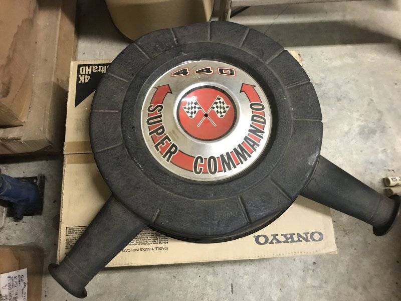

I'm no expert, but if memory serves me right, all the 67 R/T's and GTX's had the dual snorkel air cleaner. I believe the one pictured is for a C-body 440/350 horse, which had the Holley carb.
I had a early 68 Barracuda 383 4-speed with that air cleaner on it. I believe it was correct for 67 big block A bodies and maybe some others. The pie tin on yours is incorrect for the application I mentioned.

This large unsilenced air cleaner is most commonly seen on 1967 383 Dart or Barracuda. I have a copy of Engineering papers that announce the 440 Magnum for 1967. In these papers, it indicated that the unsilenced air cleaner would be used in 4-speed cars while the dual snorkel one would be on automatic cars. According to these papers, the B-bodies with 440 automatic would get a 9 1/4" rear end, similar to ones in some C-bodies ( never happened ) . Most 440 B-bodies received the dual oval snorkel air cleaner, but I have also seen the unsilenced no snorkel air cleaner on original cars. I think it depended more on what was in the parts box the day the car was assembled. There was also a dual oval snorkel air cleaner that had a higher top that would not accept the decorative " pie plate ". These were used on non HP 440 in C-body. Also, a dual round snorkel air cleaner is common. I think they were used on 1966 383 and 440 with 4-barrel. These also had the higher top and took a call-out decal when required instead of pie plate. 1968 air cleaners had a nipple on one snorkel for hose to oil filler cap, while the 1967 piece did not.

Never a single snorkle air cleaner on a 1967 R/T or GTX. It could be argued that either no snorkle or dual oval snorkel cleaner is correct. This air cleaner appears to be a 1968 piece that has a nipple for hose to the oil filler cap. Cap should be a tall one. No hose for 1967; hose for 1968.

Dual snorkel, and I'm pretty sure it had a pie plate with "Super Commando 440" on it.

From what I know, the dual snorkel was standard on everything except the California cars which got this unsilenced air cleaner. It was also used on the 383's. If it's a CA car then it very well could be correct. If not, then it was probably added at some point.

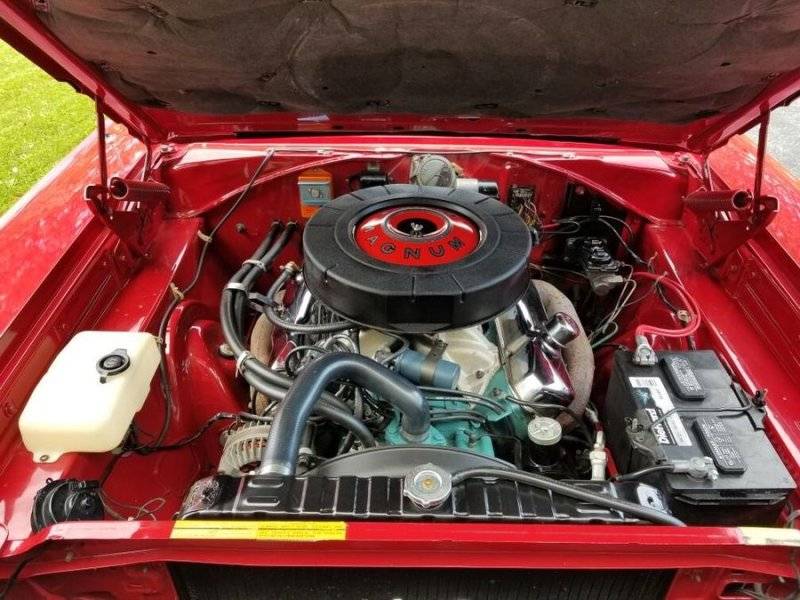

My 67 R/T is a 4 speed car. I know the original owner. The factory air cleaner is a dual snorkel, and the pie tin was the red 440 Magnum variety. (I replaced it with a matching re-pop many years ago because it was rough and scarred up.)
I have an original 67 Coronet R/T 440 4-speed that I purchased new. It has the dual snorkel air cleaner.

Back in 1984 I bought a completely original, unmolested 1967 R/T that was always adult owned, and still had the mag style hub caps and Certi-Card in the radiator support. All original, so I'm basing my comments based on that. It was an auto trans car with no A/C. It had a dual snorkel air cleaner with a pie pan ID plate reading "440 MAGNUM" and the original AFB carb was a 4-7/8" diameter air horn, so when I put a Competion Series AFB on it, I had to switch air cleaners due to 5-1/8" air horn. I went with a 68-69 style unsilenced model which looked great by the way.
