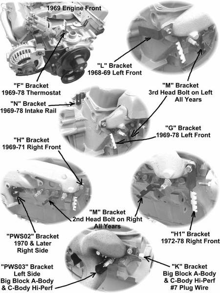

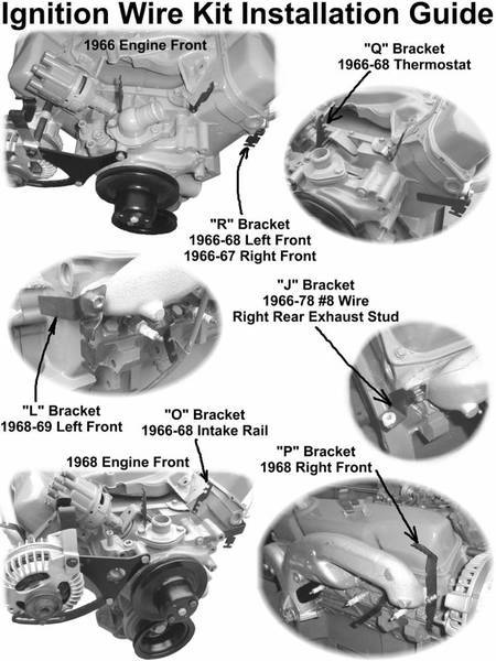

Any photos of proper wire routings (what wire goes in each slot) through these brackets on a 68 440?

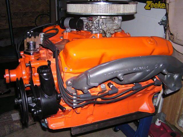

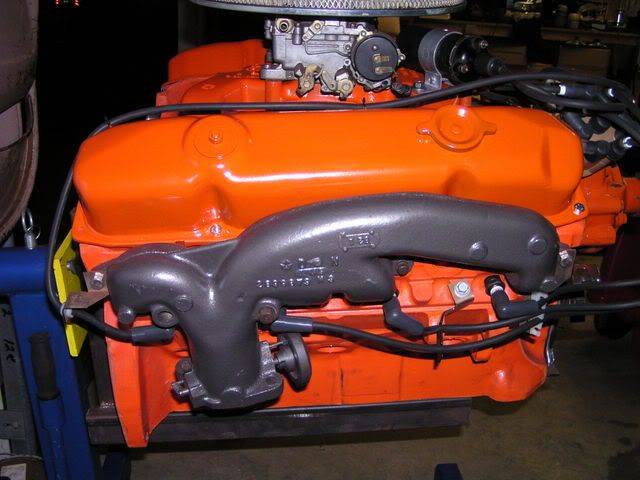

If you need any pictures of certain areas of the engine bay just ask. We basically use identical hardware, if you're after the as-delivered look for your car.
