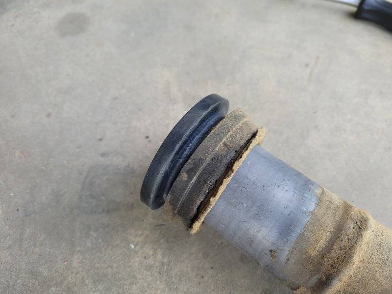

For the back of your mind... '70 had an improved grommet with secondary sealing surfacing.
Wife noticed I was pissing fuel last Sunday night when I got into it
Outer lip rotted out and yes the filler neck "brace" is missing.
70 left, 69 back on right.
Took about 4 minutes to change it. Popped the old one out with a big slotted screw driver. Coated the groove on the new grommet with a dab of PST 592 and threw it into place in the tank hole. What was left of the 592 on my finger went on the filler tube diameter and it slipped right into place.
