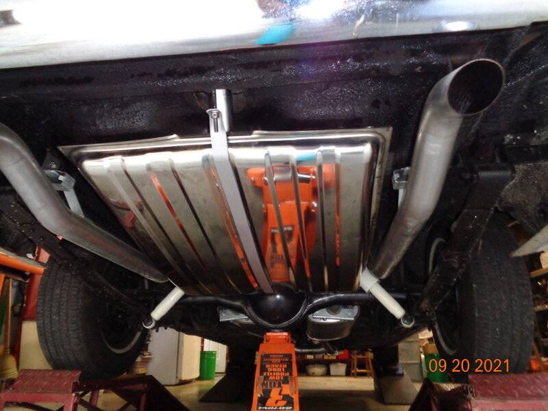

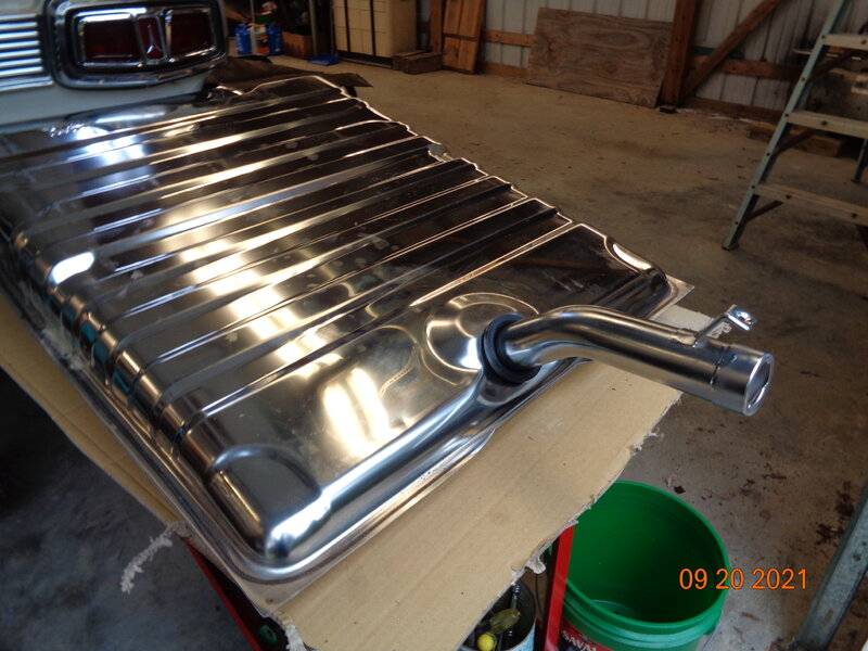

Well guys, I got it done today. I was correct, the no name seal from EBAY was too thick. As I measured in the previous post, it was NOT gonna work! I ended up ordering a seal from Inline Tube # INL 14517. It was a bit softer, and the groove measured at 2.355" on the I.D. I was able to insert the filler tube while out of the car without even any lube. I did slick it up with light oil when doing the installation. It all went together easy, and I even took the car out for a test drive this evening! I am happy! I also had better luck than I expected with the new pickup tube / sending unit. I will make another thread with my experience with that...
