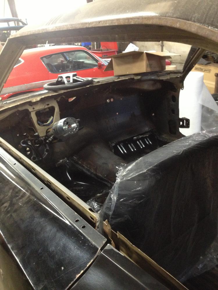

mocking up the steering, need to wait till I get my headers to finish. Next comes the seatbelt mounts and the center console, getting rid of the buddy seat bracket.

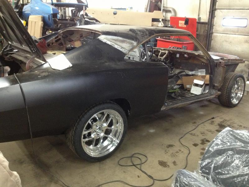

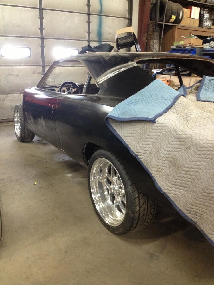

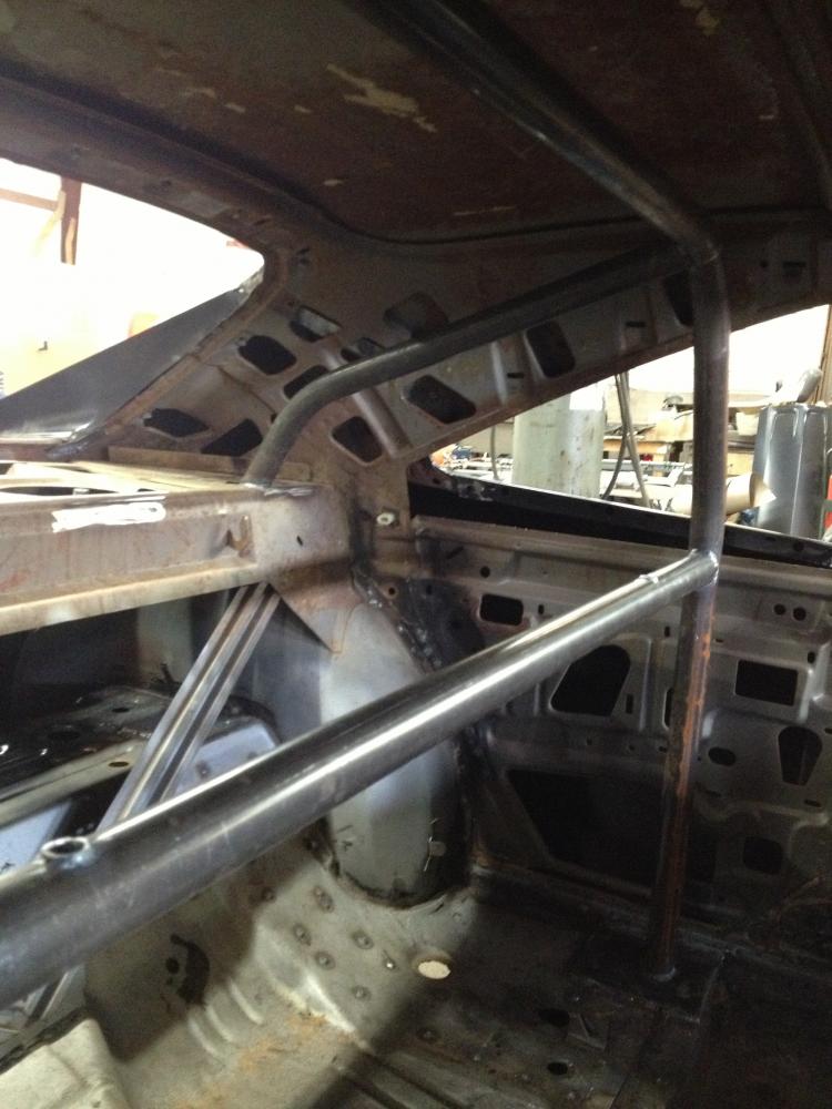

getting towards the end of the metal work.
turned out pretty nice

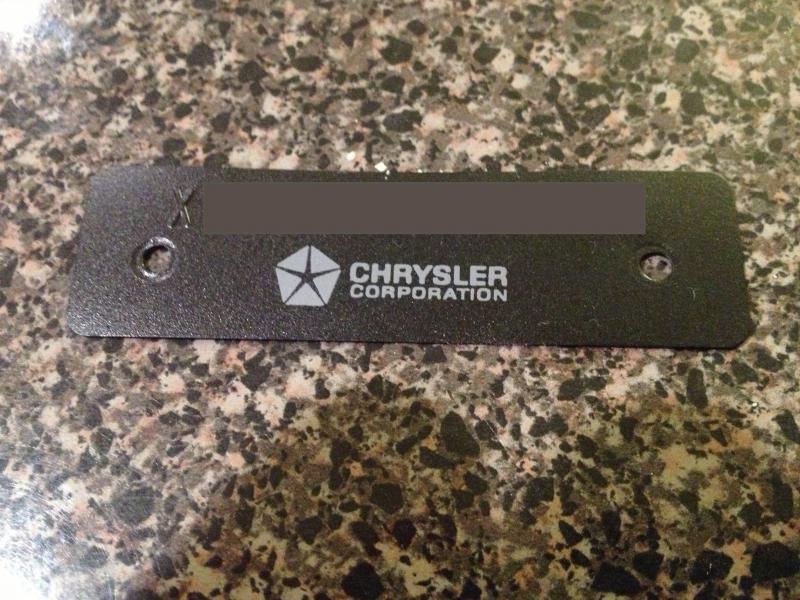

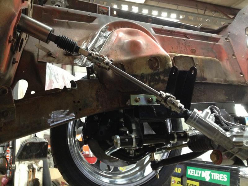

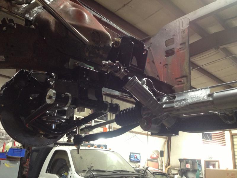

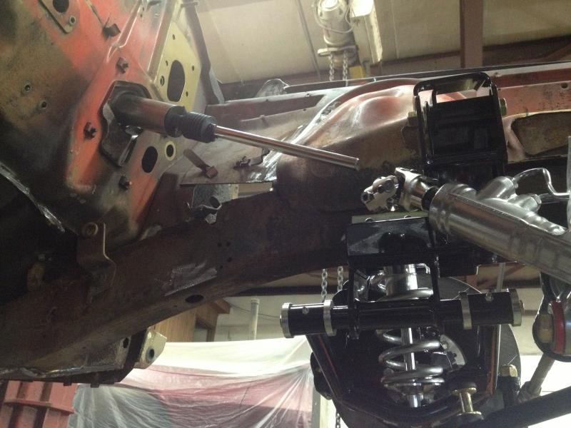

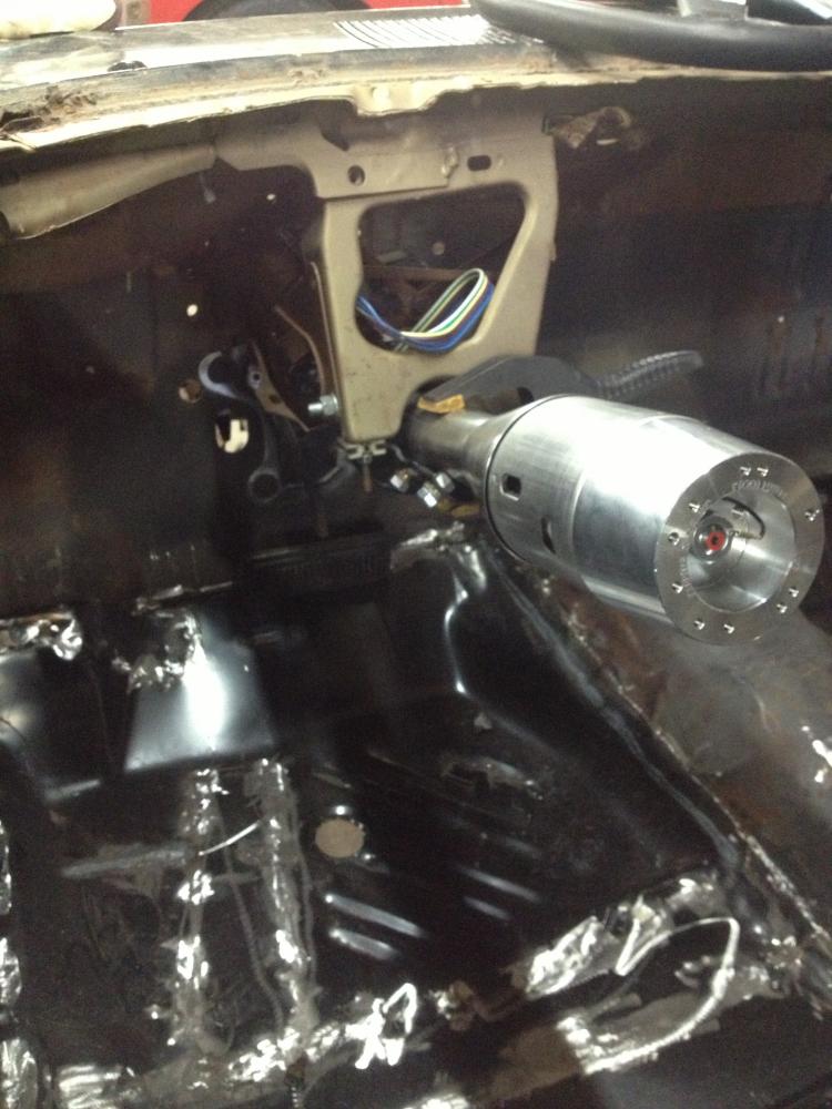

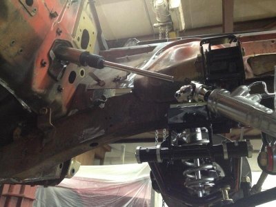

steering all hooked up
68 Charger is my all time favorite car and if I had one to do it would be along the same lines as what you're doing here! Love this build!!
word of warning on the steering column,the lower bushing is plastic,not a bearing like the stock one,,the exhaust will melt the plastic bushing & it makes the steering very sticky,we had a oil lite bronze bushing made & that solved the problem.
I'm going to have to look into that, the last thing I want is to have to redo that.
