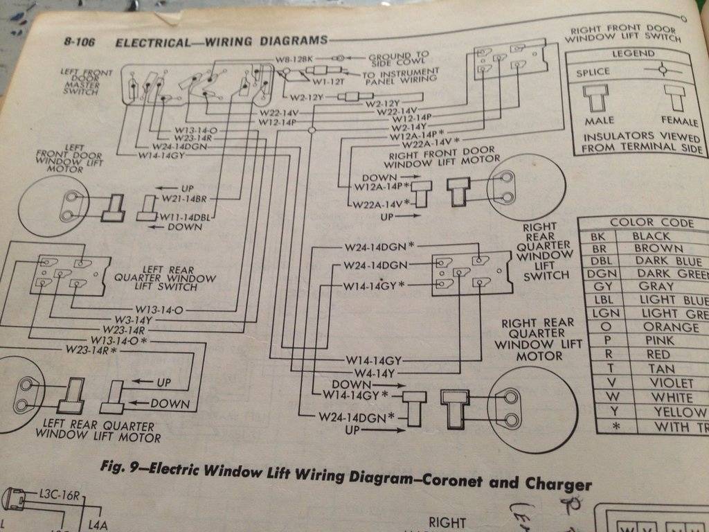

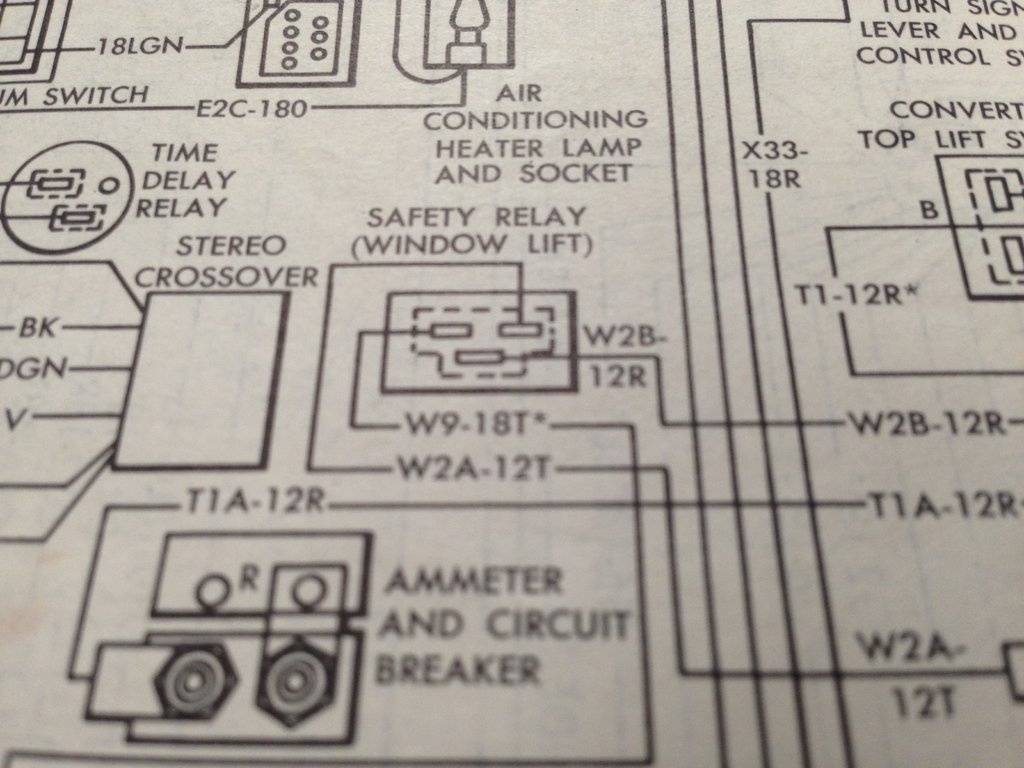

Team, i am nearing the end of a three year restoration of my 68 Charger R/T and I can not figure out the power window wiring to the relay. Any assistance would be greatly appreciated. Scott
18T*- to fuse block(hot,key on),,12T-to drivers sw.,, 12R-comes from ammeter/circuit brkr.
