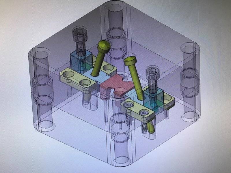

Curious: - Are you a toolmaker, or are you having it done by someone else? EDM into a MUD Base? If you can do this stuff reasonably - stateside - maybe you can be FBBO's "Injection molding source on file"?
....just a thought... I can also reverse engineer parts to Solidworks for the common good.

Hey Mark, and yes I have been a Toolmaker for over 40 yrs. now. I do all my own designing, engineering and fabrication. Yes you are correct, this tool requires EDM sinker and some wire work. I designed this tooling to work with the insert mold bases we use here for prototypes. If you have some parts that are needed and have 3D models, send them to me and I'll see what I can do (Parasolid files will do). Please understand I'm only doing this on the side, using machines that aren't mine...so lets be realistic because there's only so much I can squeak by.

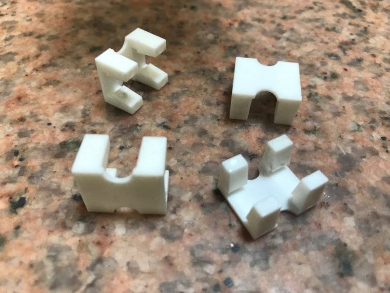

Looks like progress to me......Will you be using the white plastic like the originals? I know the black plastic is more friendly to heat for some reason. Not that it matters much to me one way or another since my car is not what the purists call correct anyway. Just a question.

Was planning to run natural nylon 6/6 (white). I was also considering maybe some Delrin/Acetal for shits and grins, they both have similar shrinkages.

Okay guys we have Steering column support clips available now

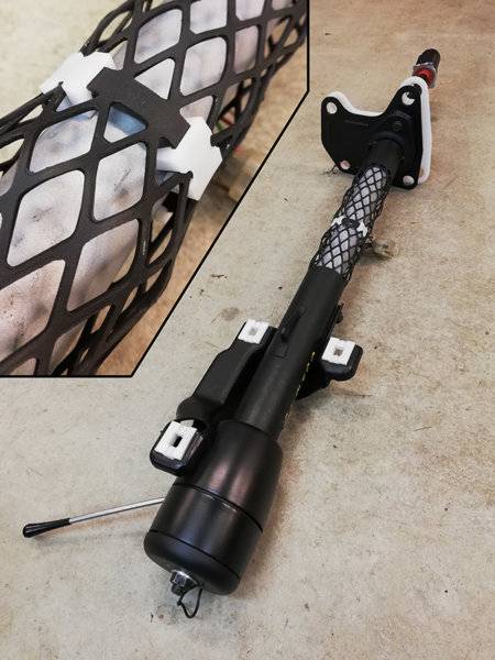

Got a set of clips for my steering column resto.
I pressed on one as hard as I could to make it fit, then I noticed that the inner tube was not centered.
I had to carefully pry between the inner tube and outer shell to center the inner tube. Then I could snap these clips into place.
So yeah, these clips are really needed to center the inner tube and Skips clips are really tough.
Awesome stuff!

Jonas you did a great job, column looks brand new

One thing brother, you have the bracket on backwards

Hah! Thats why it was so tight at the top when trying to fit it.
Thats what you get for taking the car apart in pieces and waiting a long time before putting it together again.
