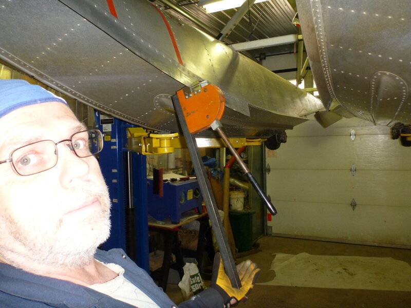

What are you building here? Looks like floats for a plane
Repairing a pair of floats to put on this..

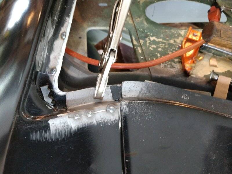

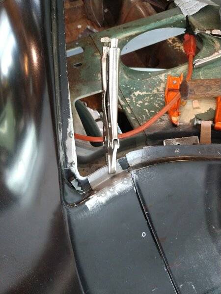

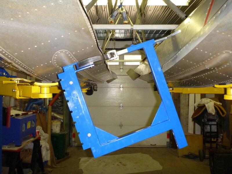

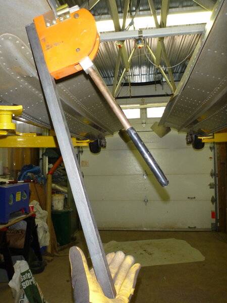

So progress continues....the portable metal stretcher worked great for reshaping the q-panel to match the dutchman. A couple more tweaks and it will be perfect. Also replaced a jacked up portion of the q-panel where it meets the window corner. 10 times better that the "factory" AMD panel
Down to one of the last modifications on this quarter before I glue it on.

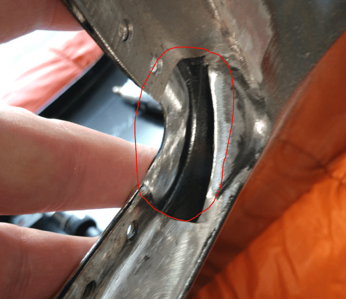

I came this far so I suppose I shouldn't rely on seam sealer to fill this gaping hole between the rear quarter and the corner reinforcement piece, aye?
