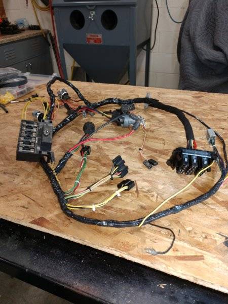

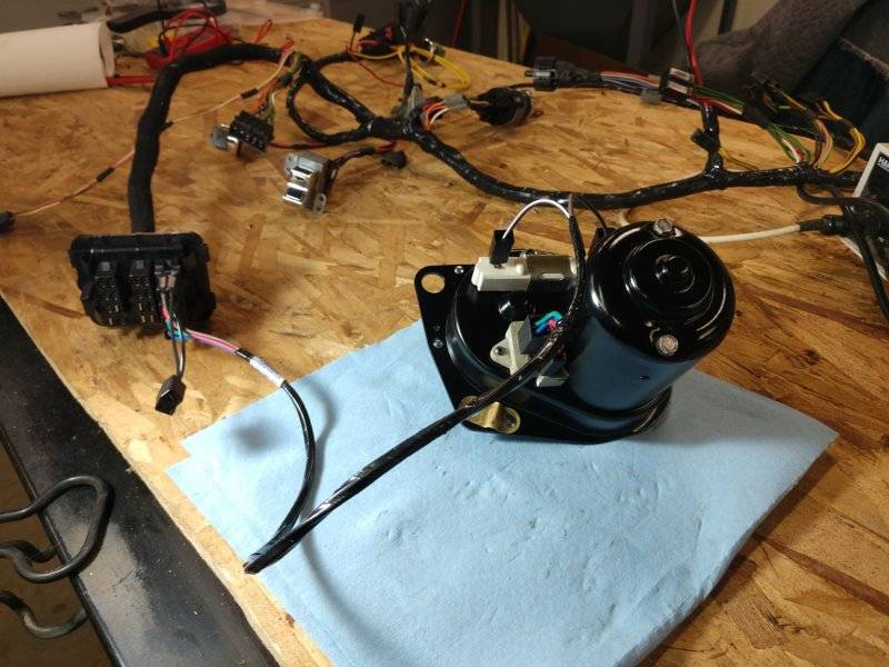

so some updates......underdash wire harness is in good shape but a few details to wrap up

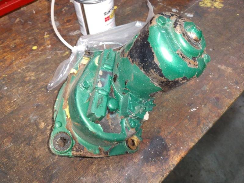

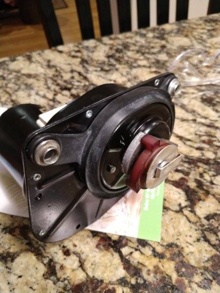

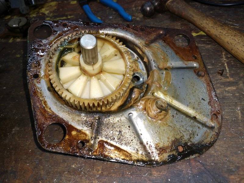

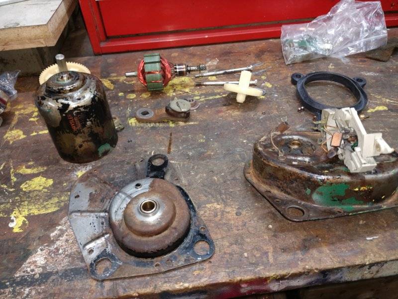

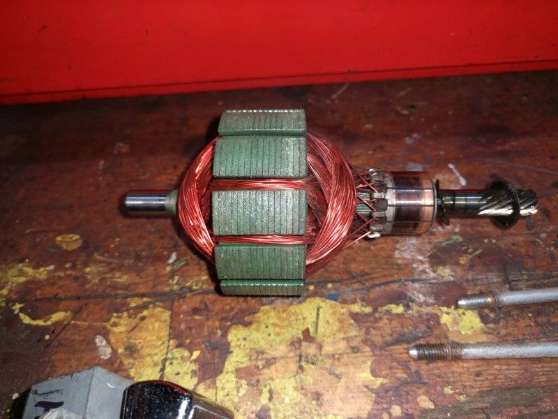

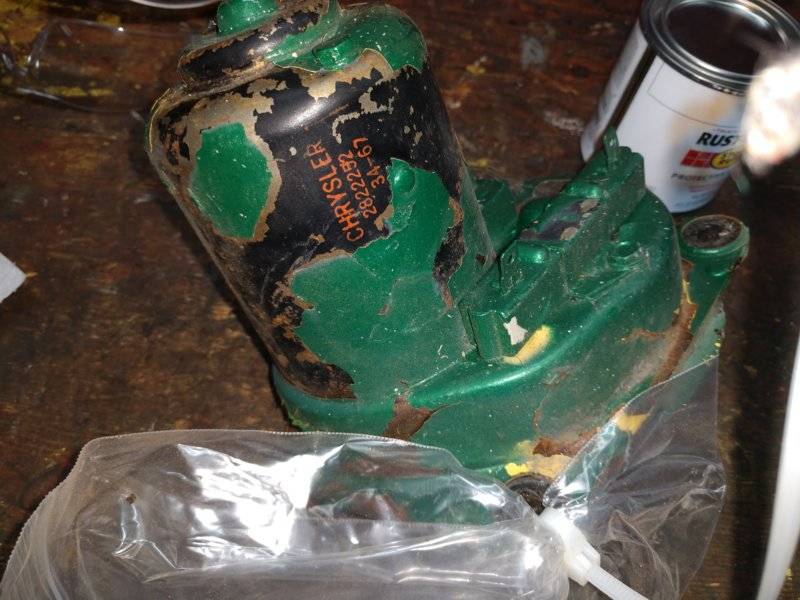

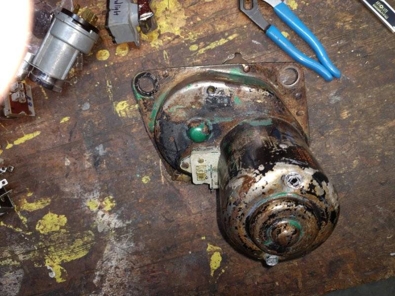

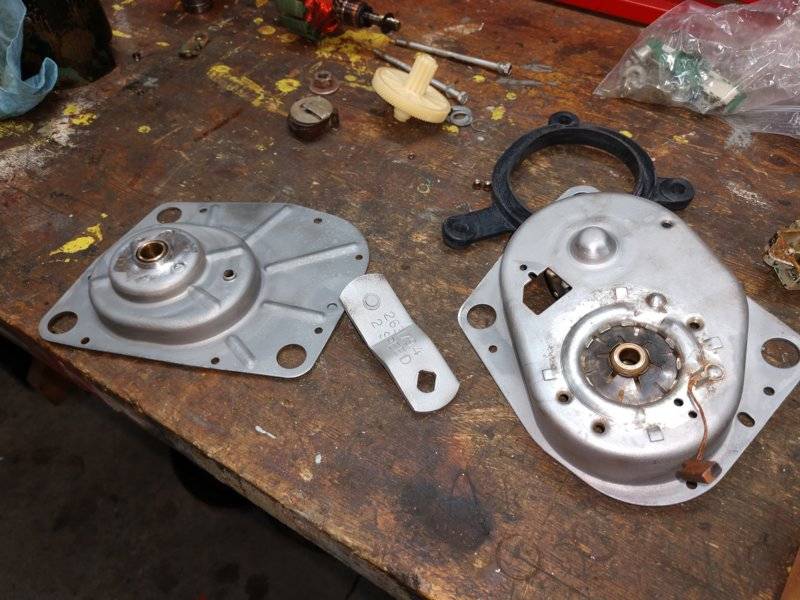

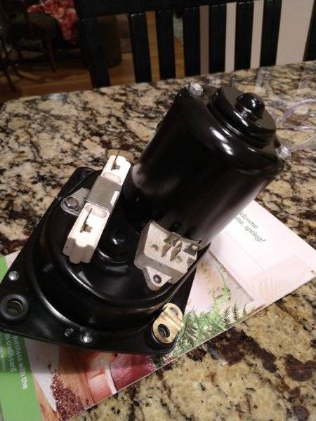

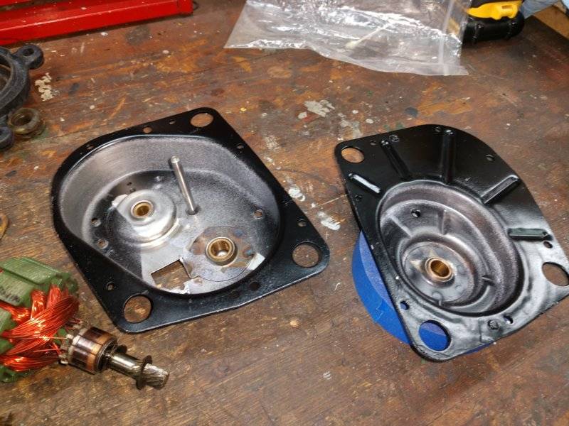

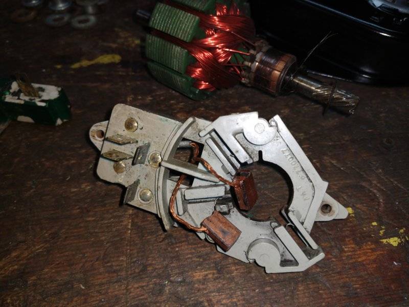

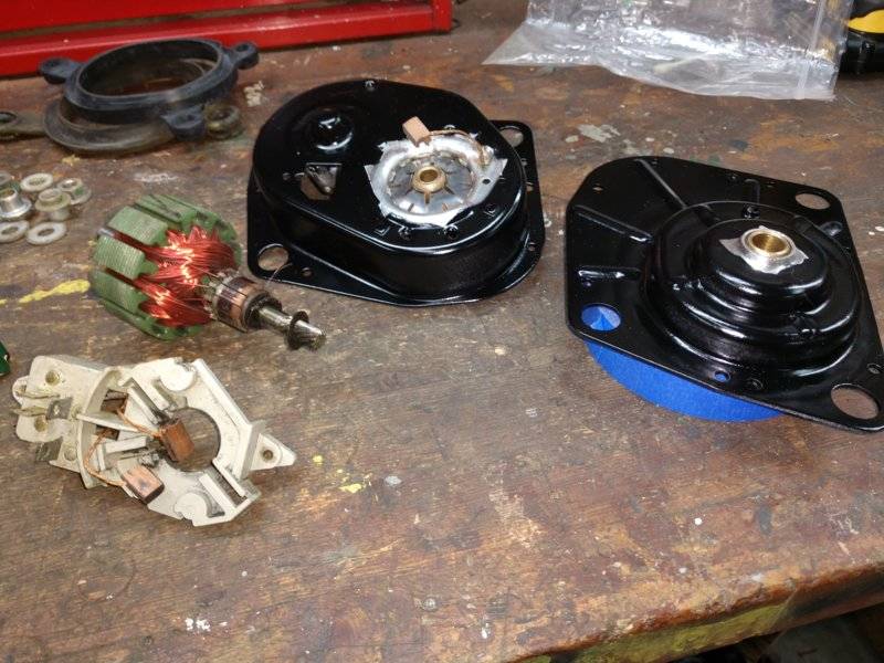

been working over the 2 speed wiper motor some......the motor tested fine, now doing some cosmetic work

ok, moving on, dash wire harness done and plans in place for the other wire harnesses. Wiper motor done, tested and working well. Giving it a week or two for the paint to cure before I wrap it up and put it on the shelf.

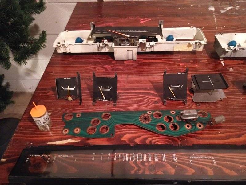

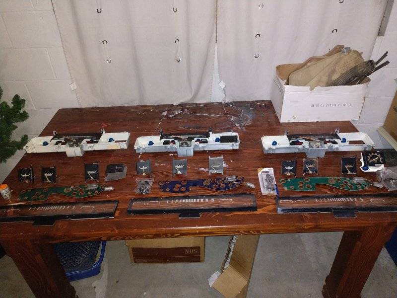

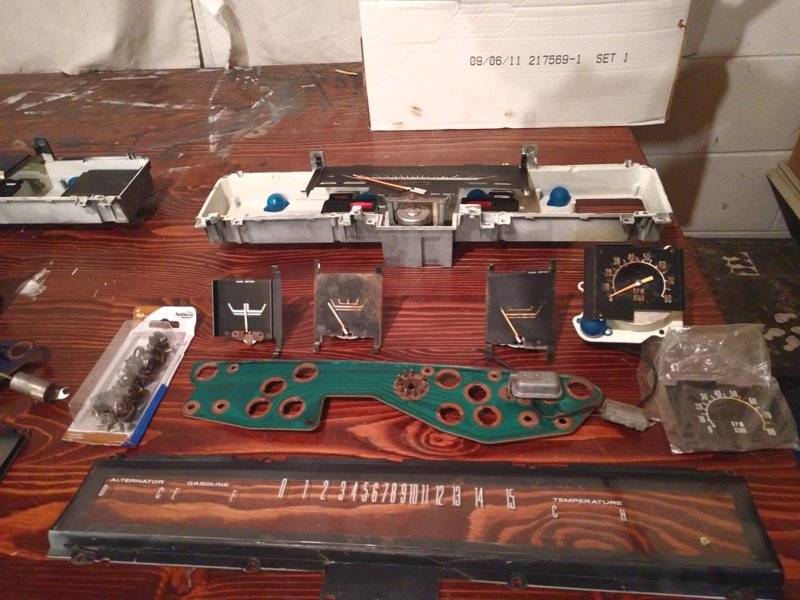

Now off for a fun adventure with instrument clusters!

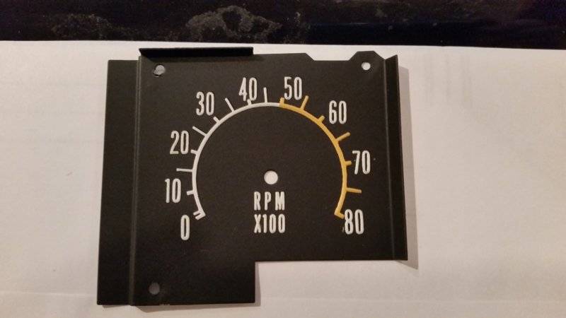

So curious, what does the world believe is the correct cluster for 68 'X? I pulled from my 68 'X a 120 MPH speedo cluster with no tach(see the middle cluster in the pix). For some reason I don't think this 68 cluster was OEM, but not real sure. I pulled from my '69 'X the one on the right with the tach and 150 MPH speedo with single/two digit (no zero) speedo numbers. The one on the left is a donor 150 MPH cluster I grabbed at a swap.
What speedos had the full 2/3 digit speed numbers?
See this for info...
http://www.performancecargraphics.com/Dash_Stuff/B-body_Standard_ID.htm
2. Very early 1968 (built in the period from August through about early September of 1967) GTX and Coronet R/T cars (all with 150 mph speedometer) had zeroes after each lens white numeral. These lenses are very difficult to read, due to the crowding.
3. Only GTX and Coronet R/T got 150 speedos, which is true for each year 1968-70
Note #3 should say "only and always"

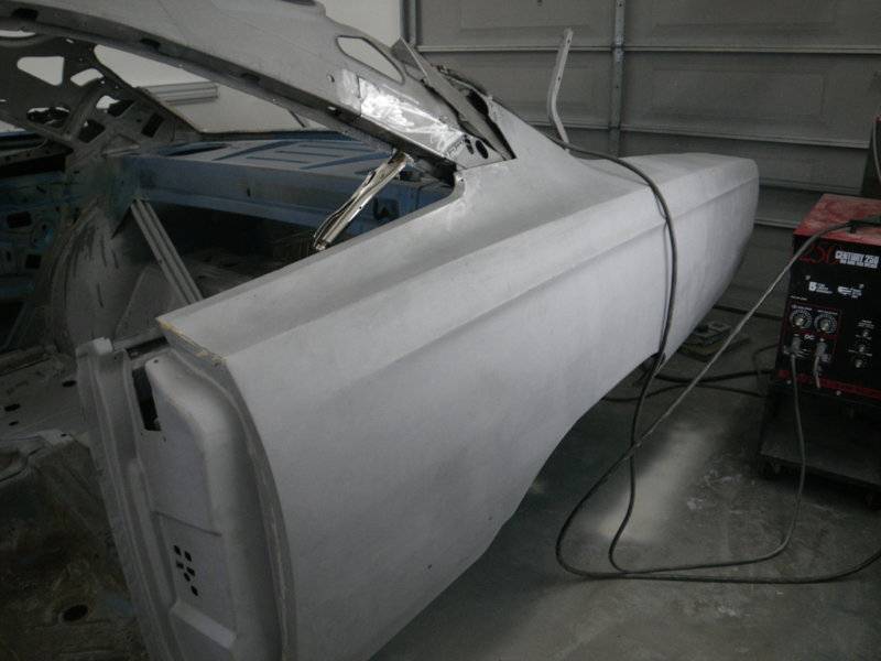

spring is here so I'm back to metal work in the garage!

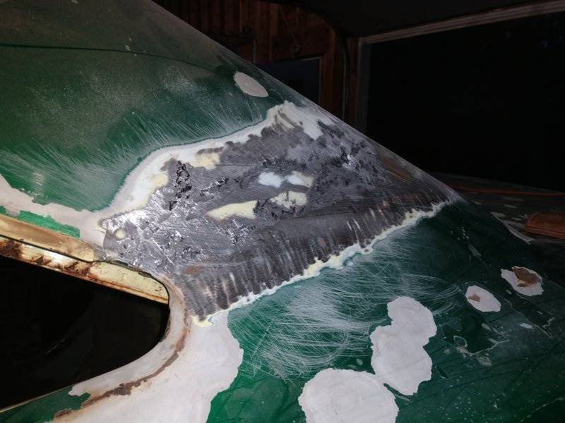

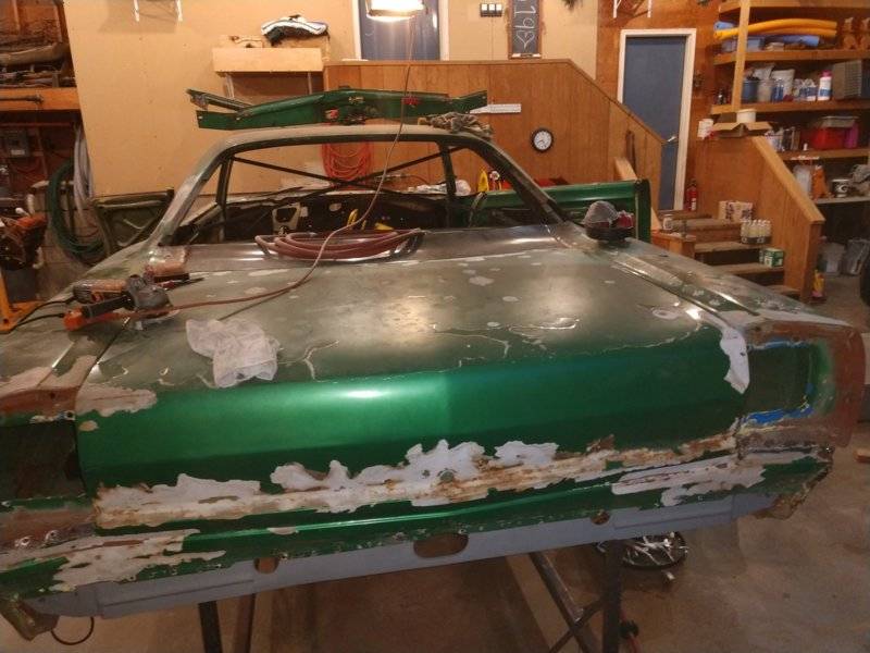

Time for the quarter panels.....

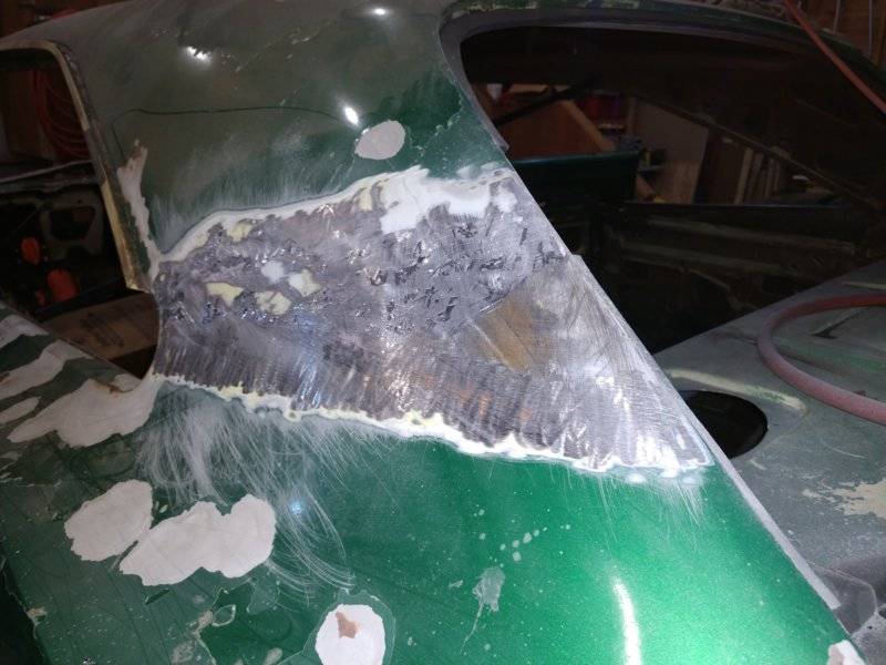

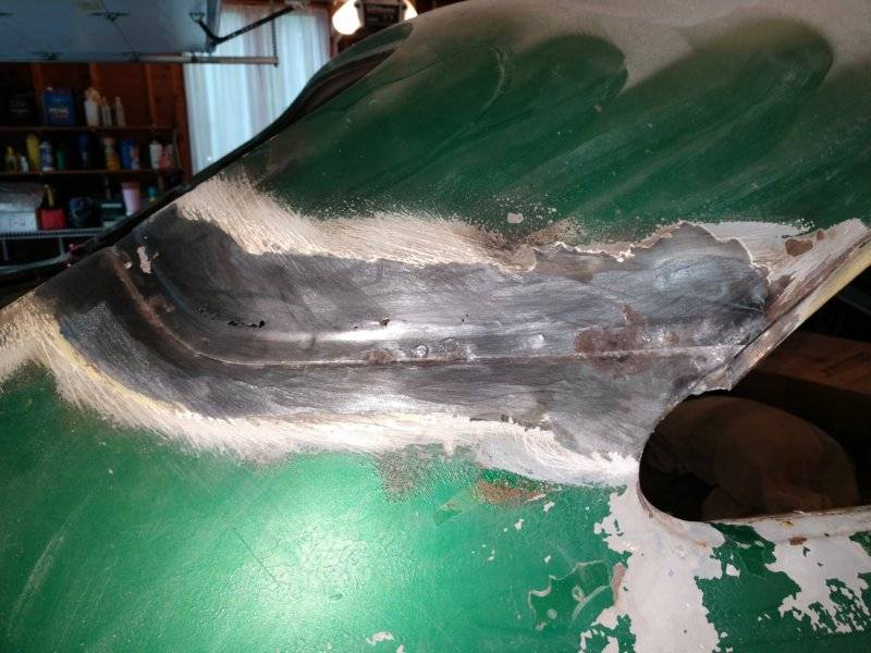

Any thoughts on approaches to disassemble this leaded seam?
Not really a fan of the idea of grinding the lead away. Melt it out maybe? That doesn't sound like fun either.
propane torch and a wire brush, eazy peazy.... where 1/4 meets the rocker too
OK, easy peasy is right. I hesitated melting all that lead and warping the panels.....not an issue.

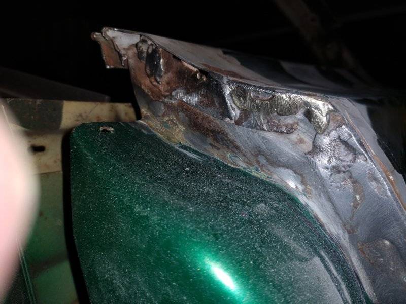

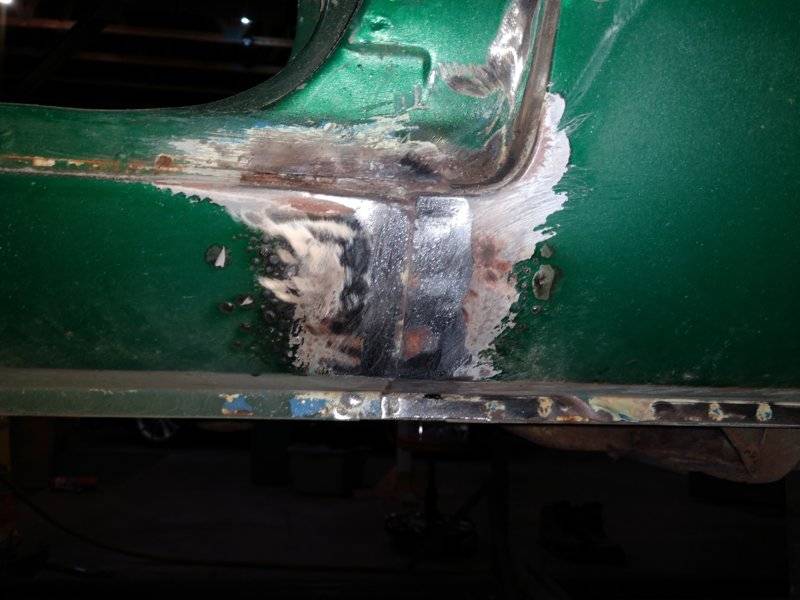

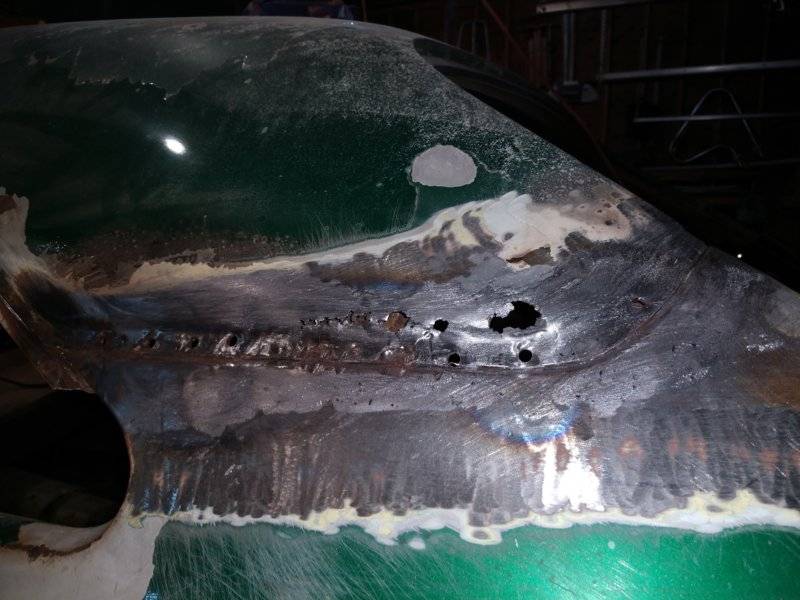

so after removing the lead my little project blessed me with some more metal work I was hoping not to find!
the rocker connection looks good (enough) on the drivers side

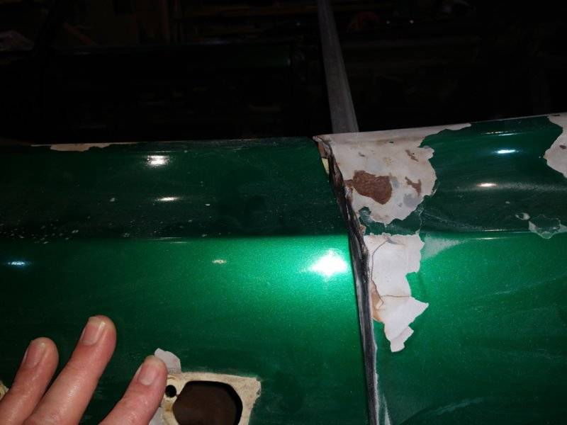

one more little surprise! after hogging out a pile of mud I found why my driver door gap was jacked at the top where the door meets the quarter. Must of been pushed back at some point and filled with mud! Grrr! :cursin:
Yep, I had problems in all the same places.

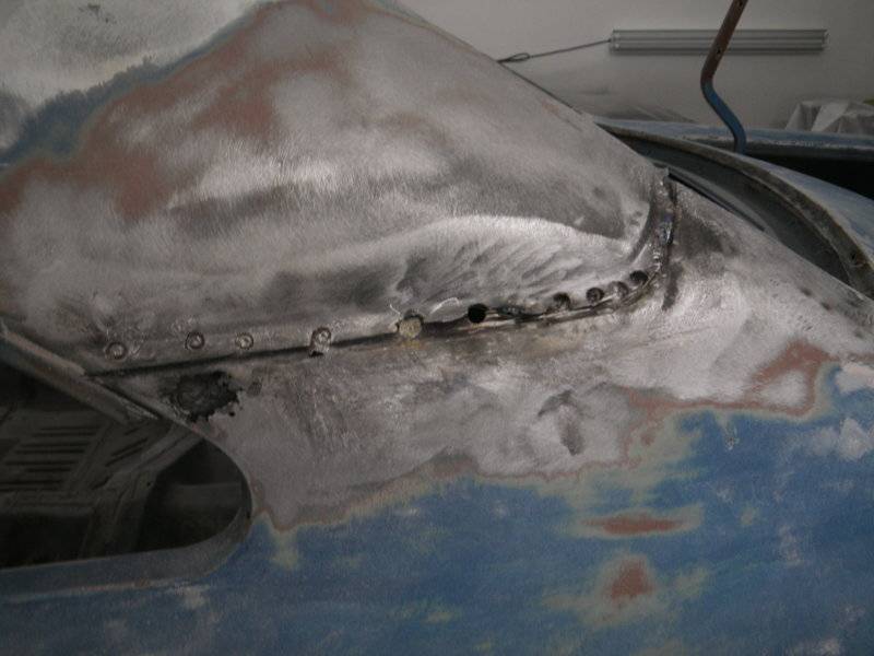

You can see the filler at the top of the door post.

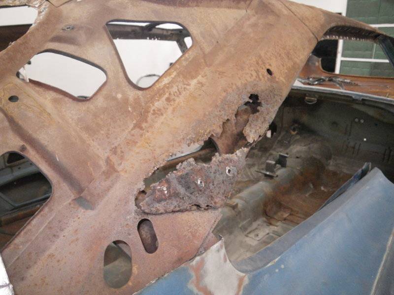

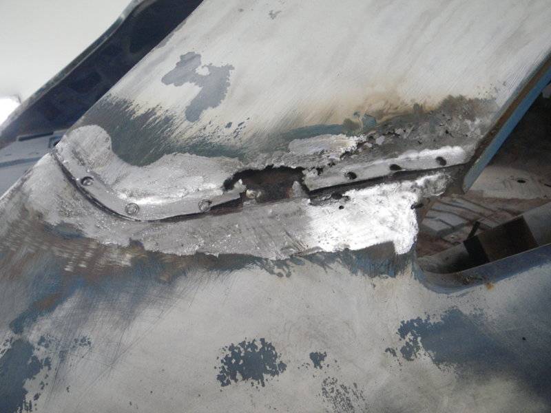

Support structure under the sail panels needed major repair. Ended up scrapping the roof skin.
