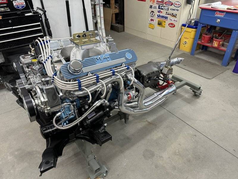

Both my B Bodies have motors putting out about 600hp. I'm using stock 11 inch cast bellhousings with 143 tooth flywheels. I know this is my weak link and should probably look at doing something different. I was just wondering if the QT was a direct bolt and go using stock clutch fork, pivot bracket, z-bar, starter, and driveshaft. I see it wouldn't fit my flywheels however.
Have you indicated the bore yet? If not you should...
I just posted this in another thread but it belongs here too...

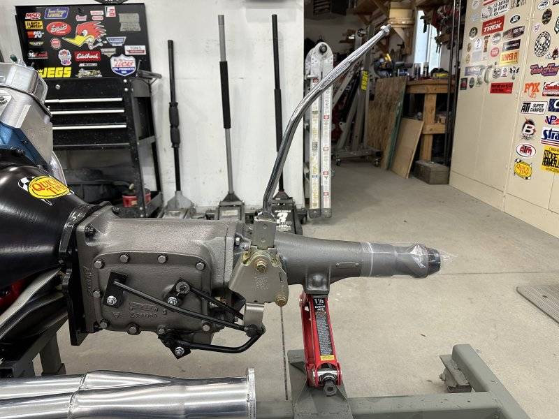

Did you get the standard bell housing? Or the Quick Time bell?
Local guy bought the Q/T bell & it wound up being over .060 out of alignment... I machined custom offset dowels to get if in the ballpark... Then the bolt holes needed to be opened up... He scrapped the Q/T & bought a regular bell, it was within .006 out of the box..
Yes, it's a Quicktime, we indexed it. .004" out of the box as stated earlier. The pic of few posts above that has the back covered with tape so I could mark and write measurements. I had to make a small steel plate to mount over the center of the flywheel as the dial indicator magnet doesn't work too well on aluminum. :p I had read that they were better than the Lakewoods out of the box. This one didn't disappoint.
Actually I think Holley owns Lakewood too now. Some of the paper work had Lakewood logos on it. Maybe they always have, I don't know.
The only thing I had to do was bore out the hole for the z-bar ball stud. The hole was in the correct location just not big enough and not threaded like a stock BH. Had to cut the threads back then nut it on the backside. I contacted Holley about it. I'm not the first to run into this issue. Time will tell if the Z-bar will line up but all of my measurements say it will. We'll see. So far no other problems. They come with two different adapter rings depending on the size of the tranny input bearing and two different clutch fork brackets. The only thing I don't like about it is that if you need to replace the clutch, you have pull the whole unit off the motor. Pain in the @ss. I suppose it's a minor inconvenience compared to cutting the car in half or my legs off. I didn't use the hardware that came with it, I put ARPs all the way around. Can't speak to using a stock driveline until the whole mess is in the car. I plan on having one made anyway. No concern there.
They seal up pretty tight. I bored a 1/4" hole in the very bottom so I could detect a rear main leak more readily rather than have oil pool in the bottom of it. No clutch fork boot. Holley said it's better to leave it open for cooling. In my research I haven't found where anybody has run into getting excessive debris inside. No gravel roads for this car. Again, time will tell.

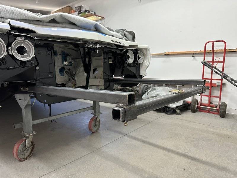

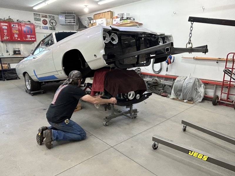

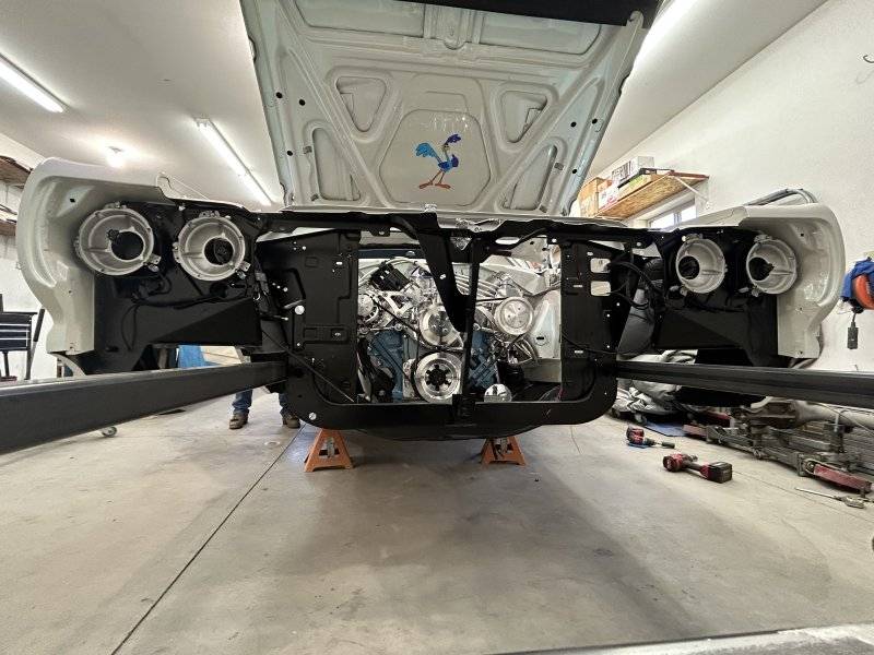

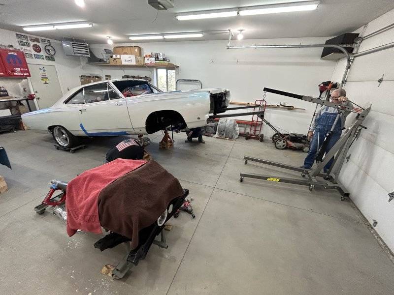

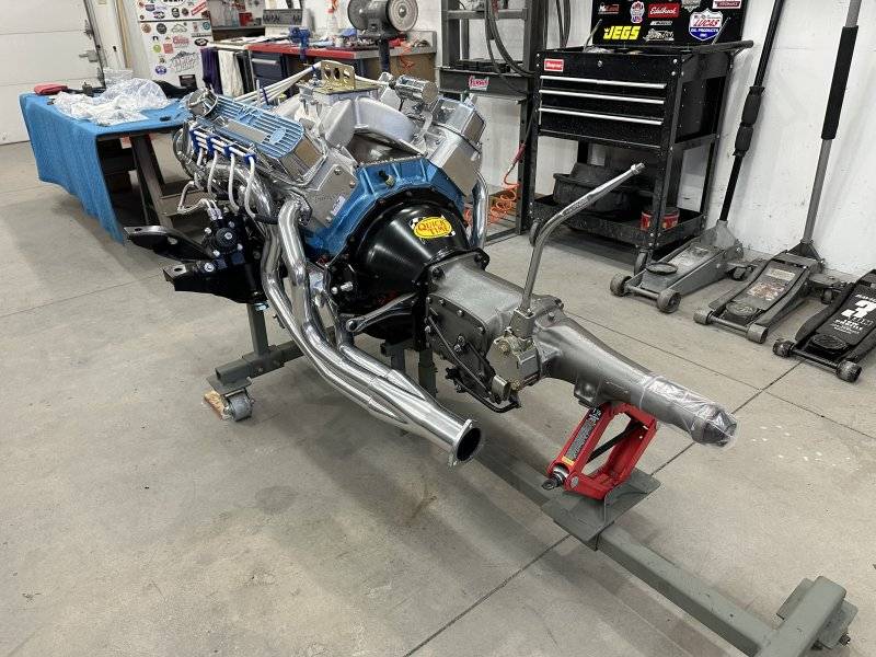

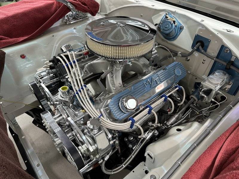

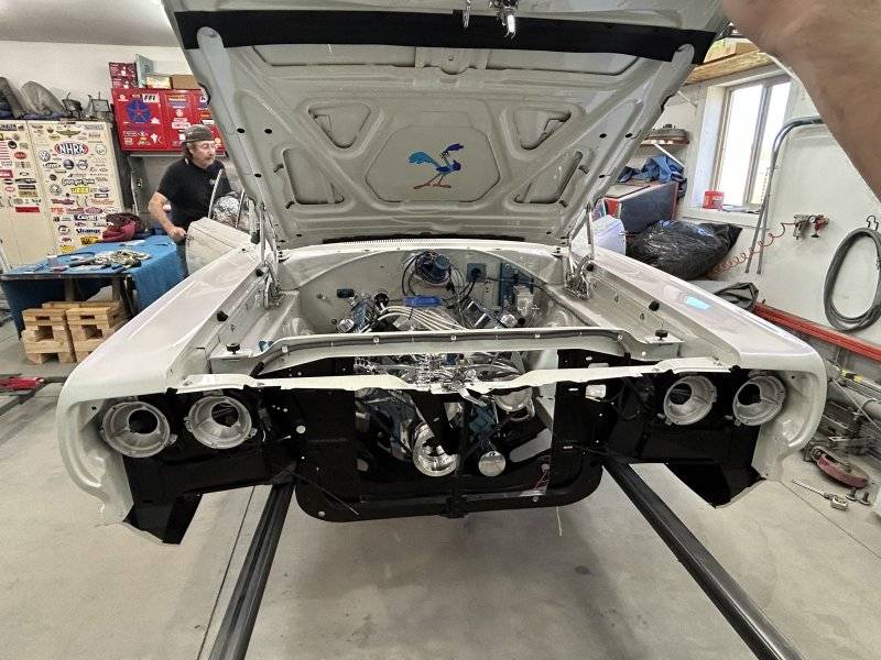

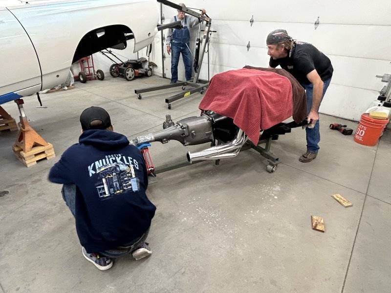

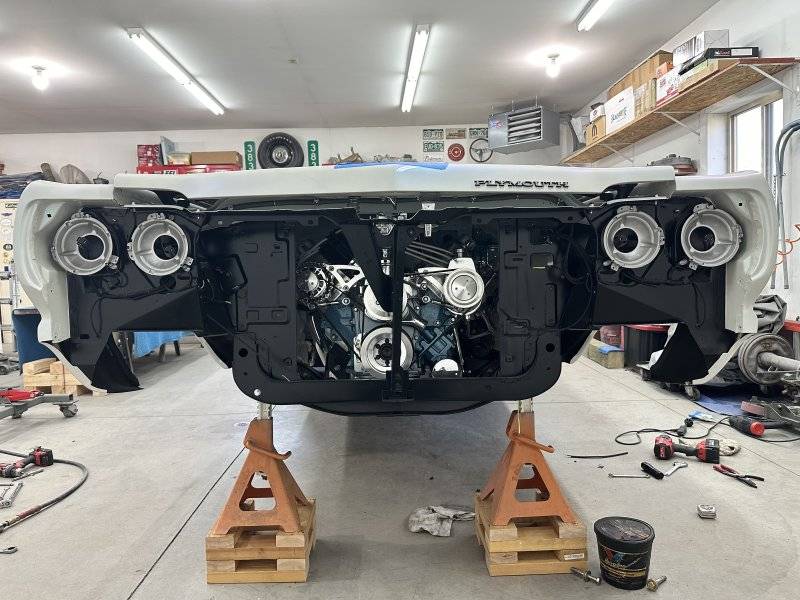

It was a milestone day last Saturday. We were able to stab the engine and tranny without incident. I was a little nervous to be sure.
.View attachment 1545507View attachment 1545508View attachment 1545509View attachment 1545510View attachment 1545511View attachment 1545512View attachment 1545513View attachment 1545514
Awesome! That's a major milestone for sure. That is such a nice way to install (or remove) a driveline, because it is nice and controlled AND you can mount engine accessories without fighting the tight confines of the engine compartment.
Looks great! :thumbsup:
Thanks Hawk. I agree. I have never done that before it went as smooth as silk.

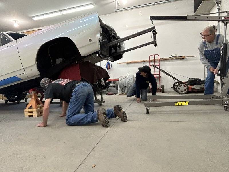

The good friend of mind that designed the specifics of the engine build, 73 years old and still races a 10 second wheel standing 65 Belvedere, had never done it that way before either. He is super intense about staying on top of the modern innovations of engine design. When we started this project he said "As long as you're writing the checks, I'll tell you what to buy". He didn't disappoint.
After the install he said thanks for letting me participate in the "proper" installation of a Mopar engine. Quite a compliment from a man of his experience. Always the gentleman and a well of knowledge with our cars. A Sage I suppose.
He's the wise looking one running the picker in the pic below.

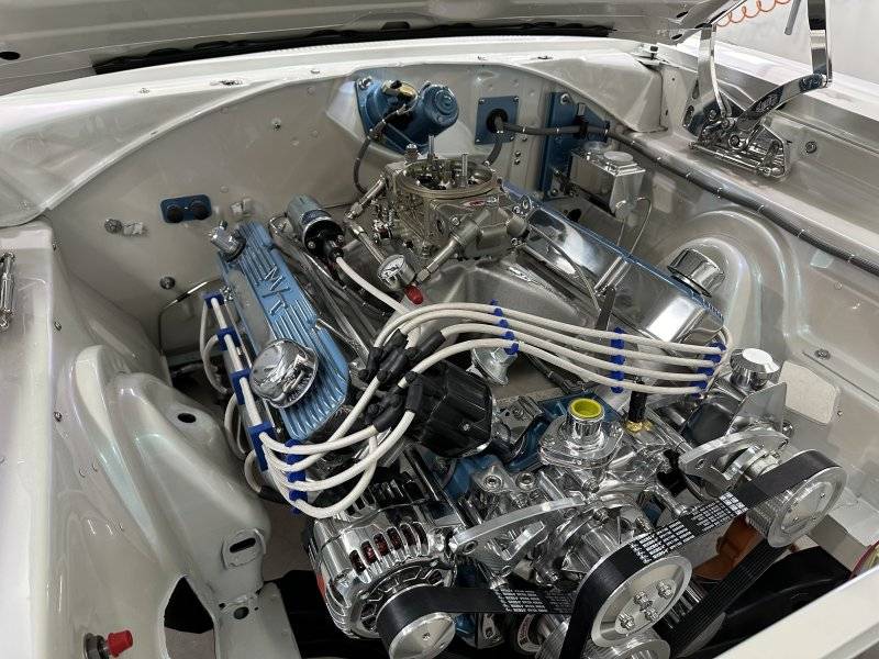

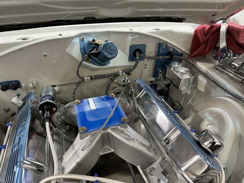

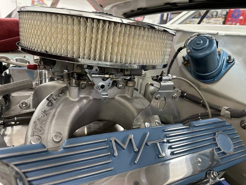

A 1.5" drop air cleaner base won't cut hood clearance with a 3" filter on the Trick Flow manifold. It just touches. A 2" filter will solve the problem.

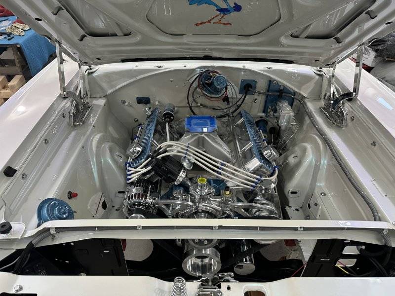

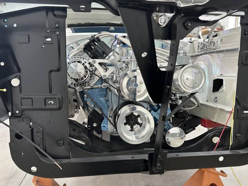

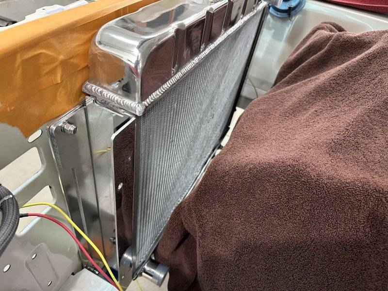

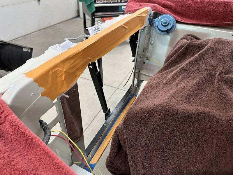

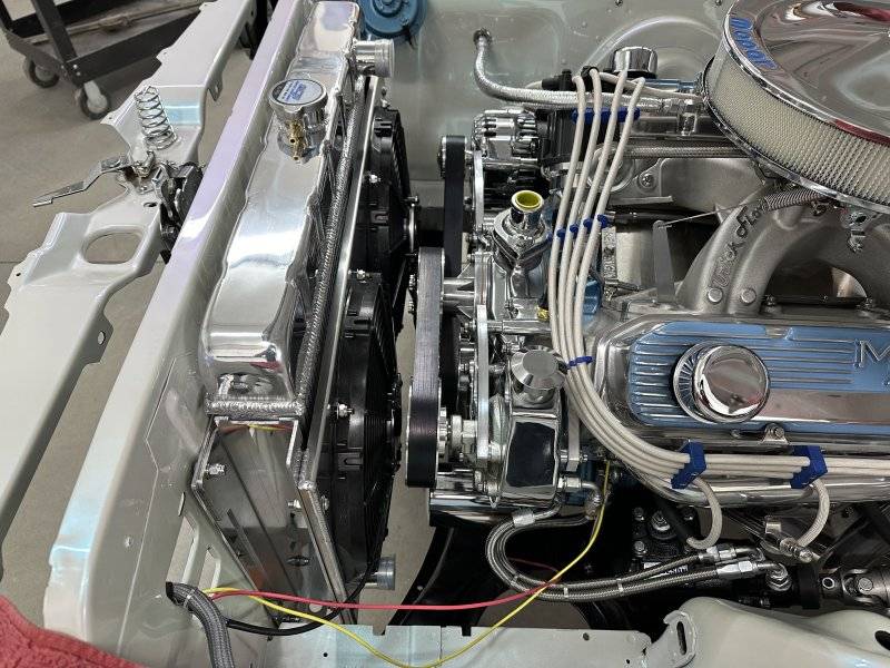

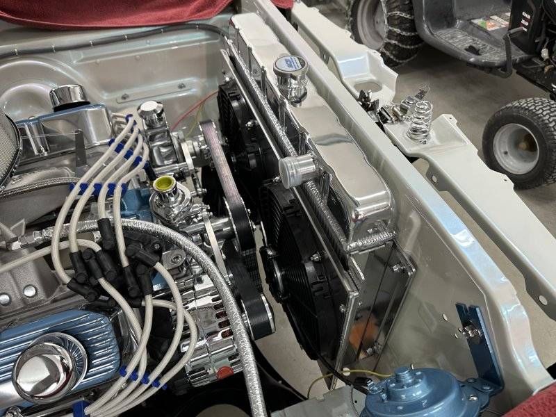

Got the 26" radiator fitted into the 22" original support with relatively minor modifications and a little fabrication. The fans are tight but should work well. Dual 13 inchers. Note the stagger between the two fans for clearance. Will finish wiring them in after I enjoy a few days with the family.

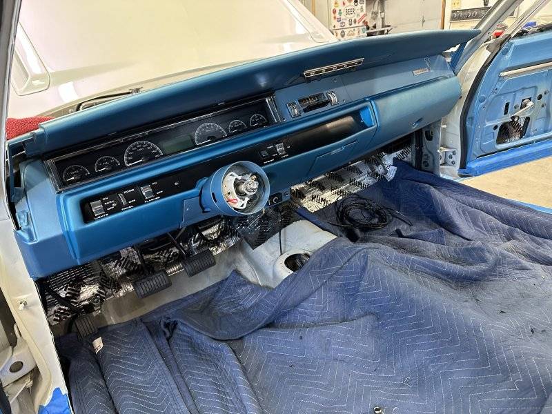

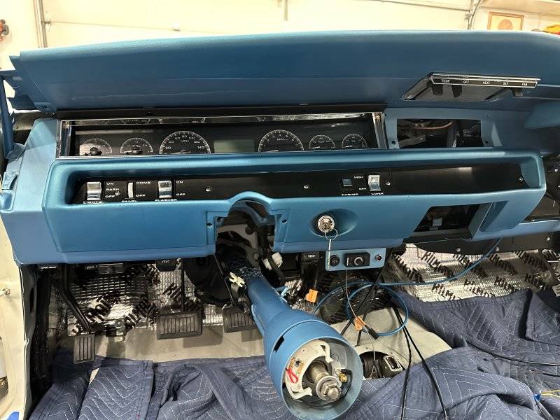

Putting the dash in this week while my extra help is home for the Holidays. Once I get that all wired in, looking forward to firing the 500 in the car for the first time.
Happy Holidays all.

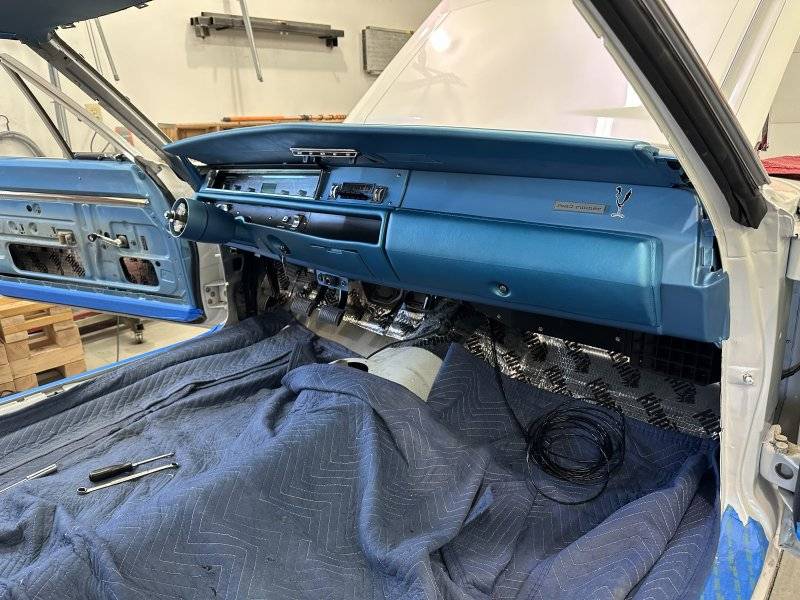

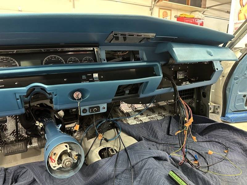

Inching away. Dash back in, hopefully for good. Testing every step of the way. All systems go so far.

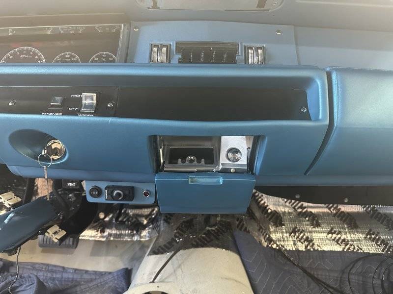

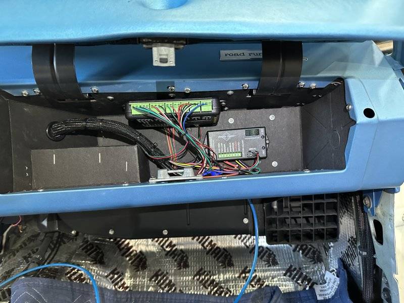

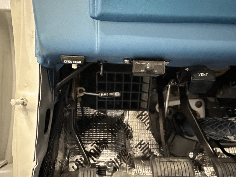

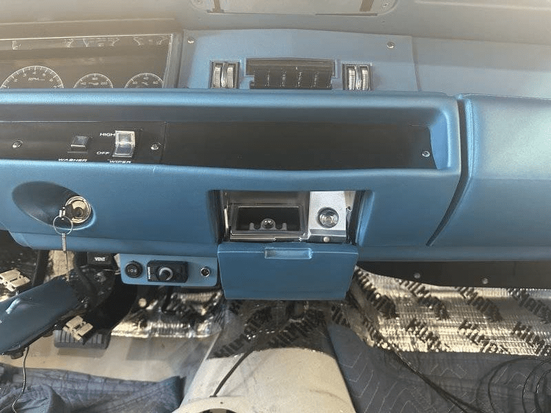

Second pic below on left side of dash, left to right, electric trunk popper, electric header cut out switch, stereo subwoofer control.
Third pic below on the add on panel below the ignition switch, left to right, Dakota Digital manual interface switch, Memphis Audio headless stereo manual interface, line loc indicator light.
I should have the Dakota boxes wired up tomorrow. Stay tuned.
Pretty much buttoned up today.

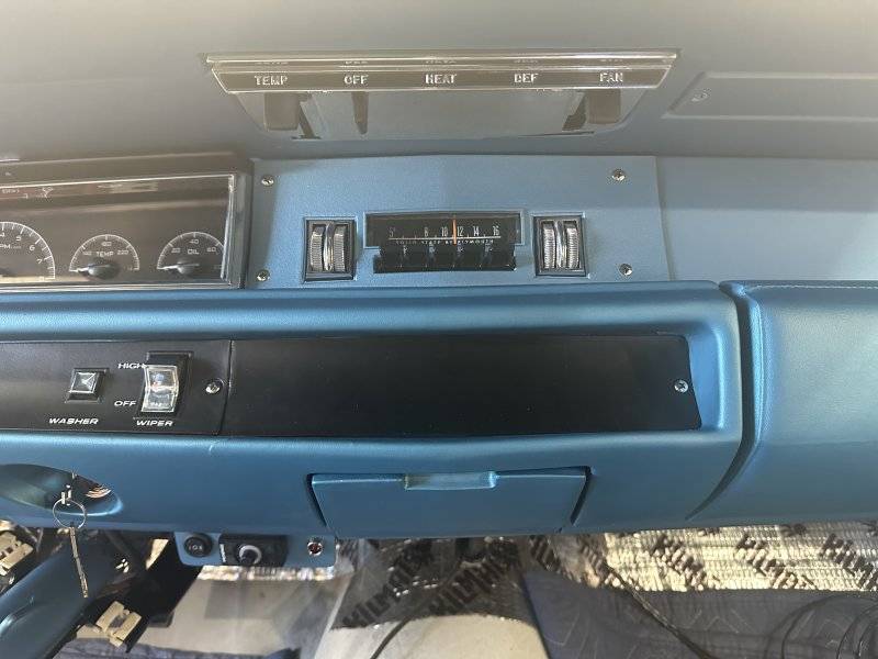

The Dakota boxes took some time. Many wires but should be slick if I didn’t screw anything up. I need to repaint the under column cover to match the pad. The dash and pads are two slightly different colors by design. Not sure what I was thinking. The lower pad is original. The crack in the pad below the wiper switch is from my hand slipping off the shifter in a hard third gear bang and slugging the dash years ago.
The coil of wire on the floor is for the header cut outs. Cant wrap that up until the exhaust system is in.
Oh my, an imperfection!!! :eek:
Seriously, I think small things like this actually add to a car rather than detract from it. The crack has a story, as does the car, and in my opinion it's cool to retain a bit of that when restoring a car.

Yes, my friends give me **** about that stuff too. Crap like that bugs me. I can't help the way I'm built. Part of the car's history I suppose. Your jab helps me accept it, thank you.

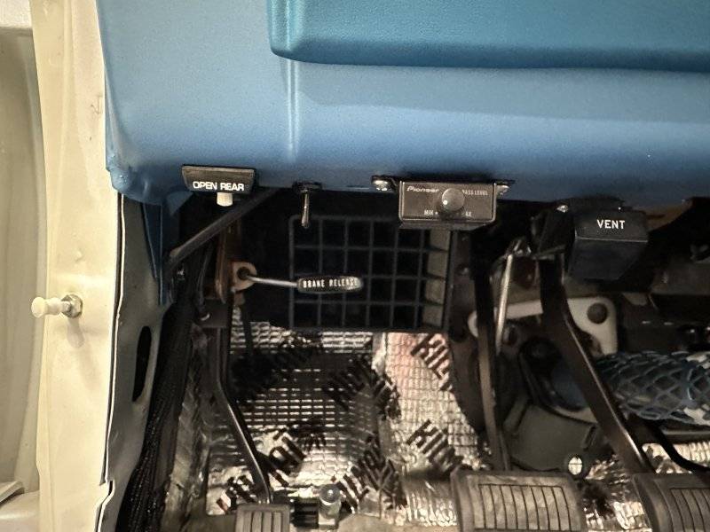

What's the Pioneer knob for?
And this one next to the ashtray...
Post 316 above RC.
"Second pic below on left side of dash, left to right, electric trunk popper, electric header cut out switch, stereo subwoofer control.
Third pic below on the add on panel below the ignition switch, left to right, Dakota Digital manual interface switch, Memphis Audio headless stereo manual interface, line loc indicator light."
