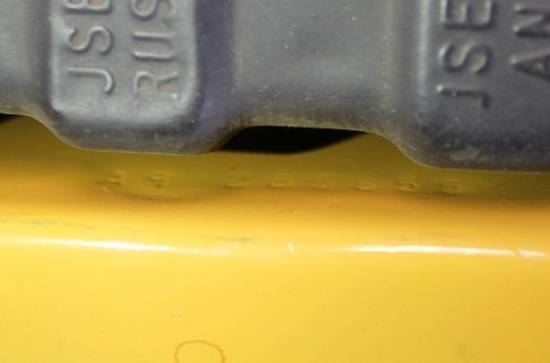

On mine, number on block and transmission matched the VIN. There is also number somewhere on radiator support that matches either the tag or the VIN. It's been a while since I looked.

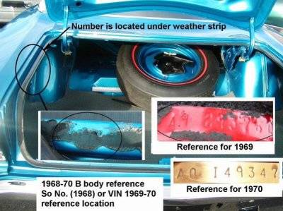

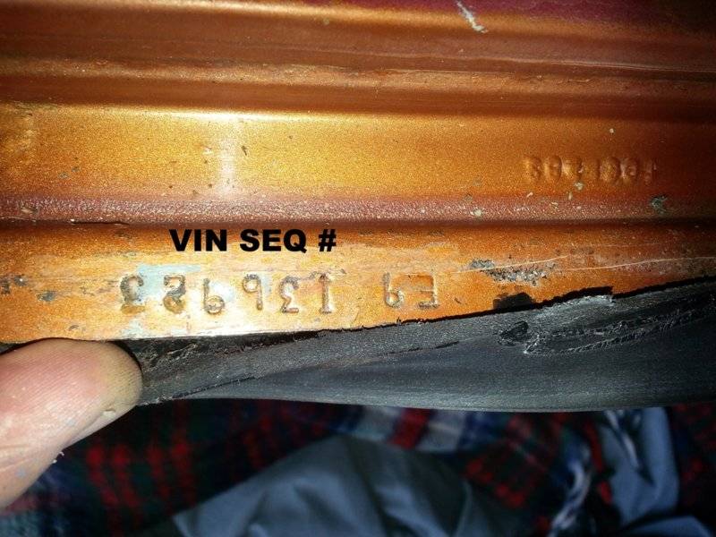

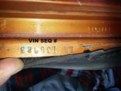

Examples of where the body numbers are located. 1st and 2nd pic are trunk. 3rd is the radiator support. Both should match each other and the vin tag.
