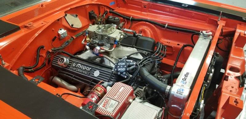

I recently did an 22" radiator shroud brackets fan and clutch for a guy. I believe he got everything from Mancini but I did have to weld the brackets on, 4 small welds and it cools great in Phoenix

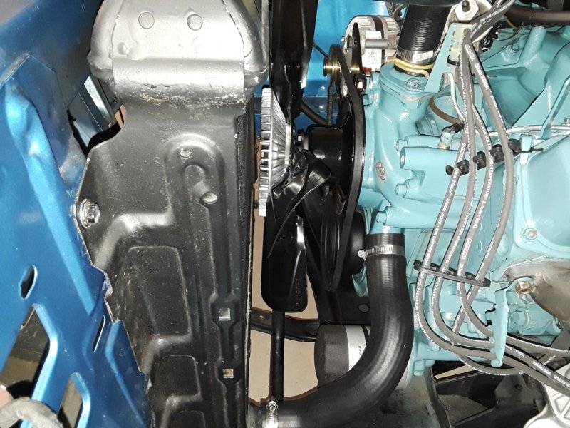

My radiator does not have provisions on the side to mount a fan shroud. If you know of a fan shroud and a mounting kit to attach it that will fit on my radiator please let me know because I have not been able to find anything yet. I could buy a whole new radiator and order it with a fan shroud I guess but I really would like to do something simpler. View attachment 848870 Thanks.

I believe the clutch senses changes in air temperature and requires heat from the radiator to function properly........ without the shroud, the clutch thinks the radiator is cooler than it really is; therefore it wont engage
I wasn't trying to be rude about it, just in my opinion , popping the hood and seeing the electric fan right there in front would immediately take away from the stock look. I agree the clutch fan may be a problem with the 22" radiator. for comparison sake, I use a clutch fan , with a small block 2 core 26" radiator, a 180* thermostat and a shroud with my 440, and it never gets over 205* sitting still , in gear , for what seems like days in 95* weather. maybe you should look at the thermostat too, I always test them in boiling water before I put them in. I had 2 in a row that did not open right out of the box , and one that barely opened before I went and bought an expensive one that worked.
I just recently bought an aluminum 2 core 26" radiator because I like the look, and I don't even need the shroud and it doesn't exceed 200* no matter how hot it is outside or how long I run it.
I tested a brand new 180 deg thermostat before I installed it and it worked perfect. I'm convinced the problem is the smaller fan and the fan clutch combined with the lack of a shroud. I was hoping for a simple solution like adding an elect fan in front (I've seen it done sucessfully on other cars). Sorry if I seem frustrated with this issue. It's been a long road to get the car to this point and there's only a few last issues dogging me keeping me from driving the car. Besides that I'm getting to be a grouchy old bastard anyway ;))

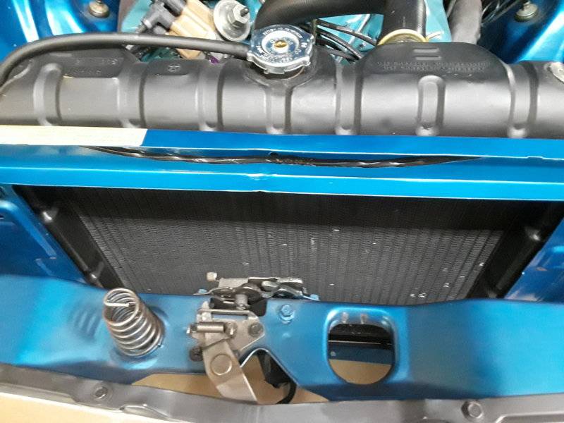

Shroud is absolute necessary. Do the basics. Flush the system, change thermostat. Do you have the plate @ the bottom of the bumper going to the frame ? By the looks of your pics , air is going where it wants to and NOT through the rad ! I am not an advocate of electric fans, sometimes diverts air rather than directs it. Big rad with shroud should do it if you want to spend the $$$.
Thanks, I already flushed system, new thermostat (checked 180), new water pump, radiator completely flushed and cleaned, all basic systems in good working order. Yes I have the plate to seal off bottom of bumper air.

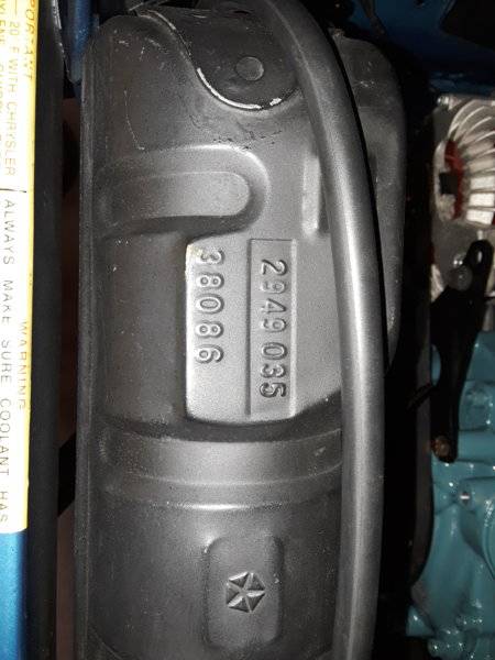

From the Govier book, I see
2949035 listed as a 22", 69 C-body, 383/440. For a B-body, 22", I see
2949053, also 383/440. I don't know what the difference could be
Ima thinking a 22"rad was borderline for stock 383 application, with no shroud.

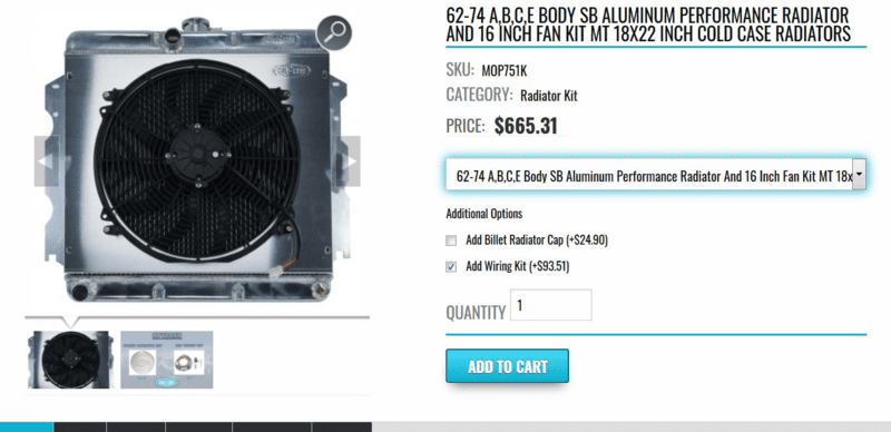

Turns out the mounting brackets & clips I ordered will not work on my radiator. Apparently no products available to attach a shroud to this particular radiator. I'm just going to buy a new direct fit radiator from Cold-Case complete with shroud and fan. They now make them with OEM style tanks to maintain that close to original look.
Also I want to thank everybody who contributed to this thread. I know some of you guys spent some considerable effort to provide useful information. Thanks again. RRDon
Cold Case Radiator kit Ordered from Summit. Will paint it black before installation.
