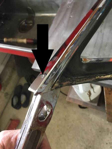

How do these come apart to swap out the seals? I assume the pin has to be yanked out - no luck with that so far. Can't see it being a bid seal if I just cut it off flush to the post. What bout the small screw ... is that an allen head or flat blade? If allen head, what size ??
That's just the screw hole for your door seal on the front edge of the vent frame. As for the restrictor pin on the pivot pin, I was sure glad the last guy that owned my Dart cut them off. Thanks to that I was able to pull them out and change things without pulling the entire vent frame out of the door. Changing the seal is shown in my Bee restoration thread.. I'll go look for the page..
