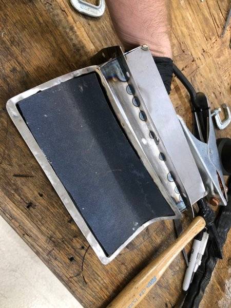

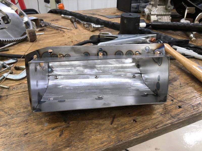

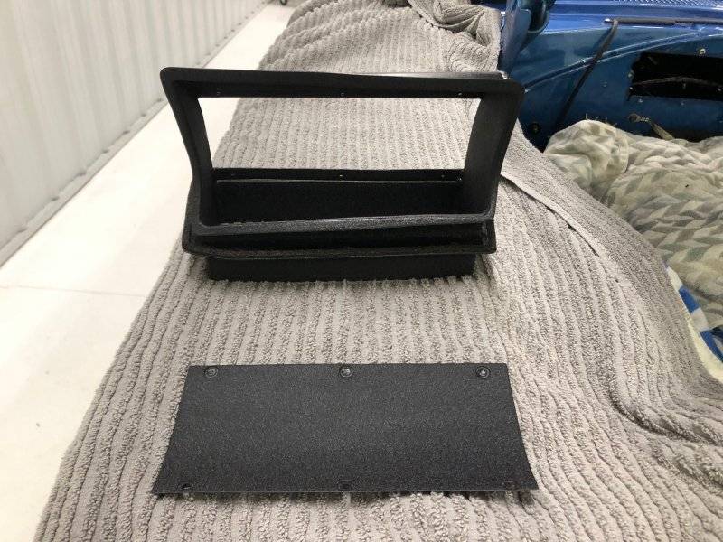

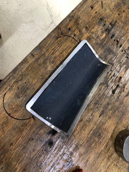

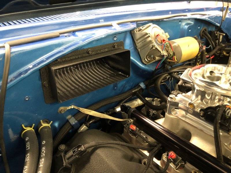

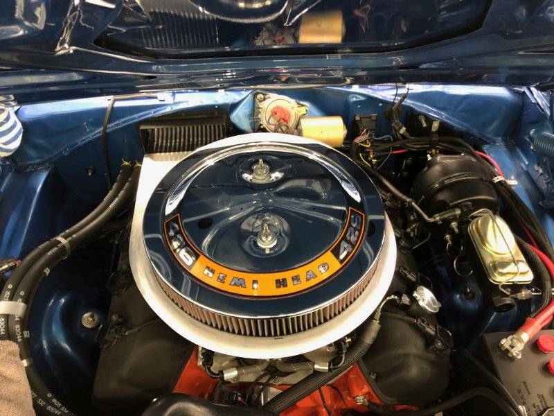

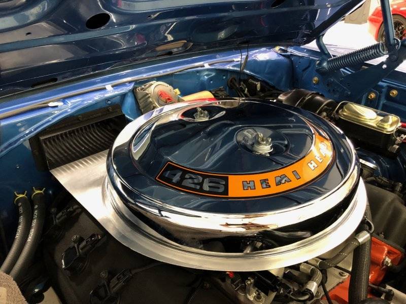

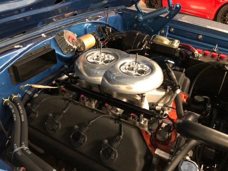

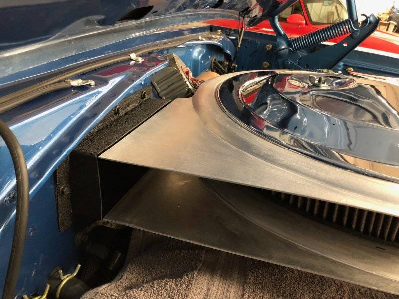

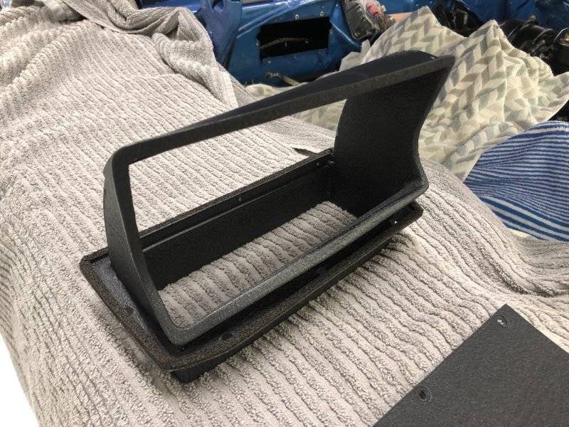

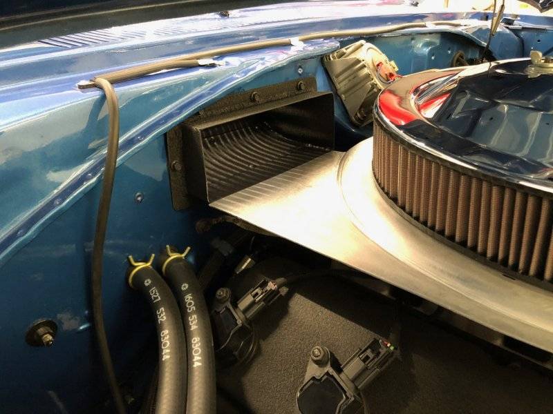

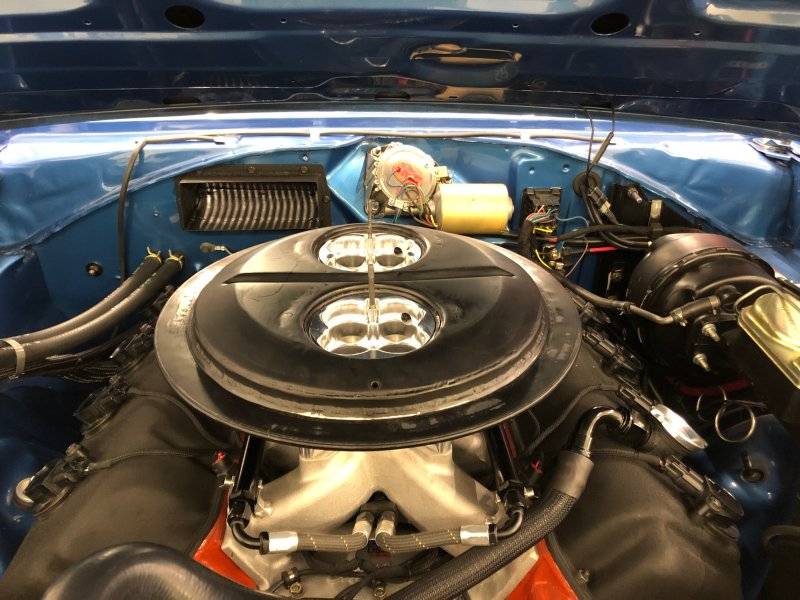

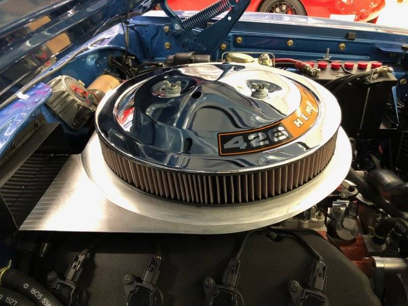

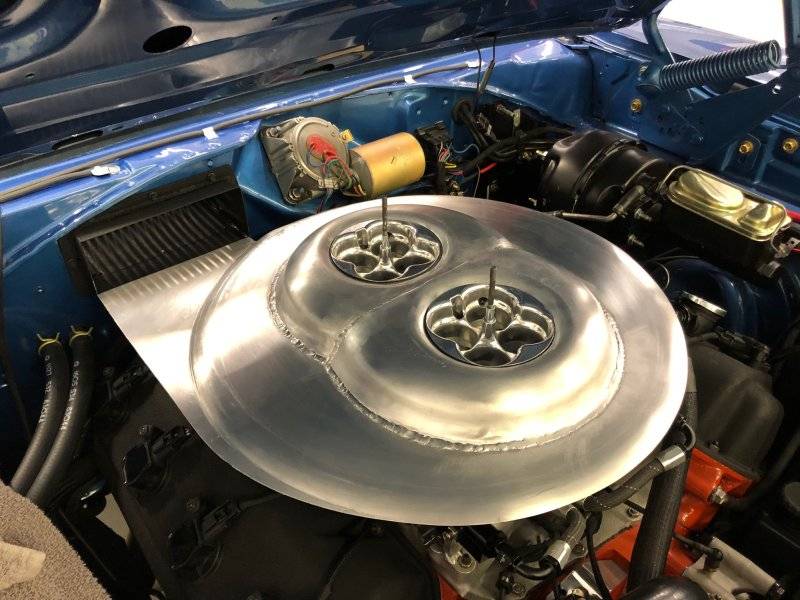

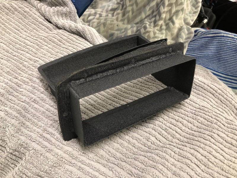

Next matter to address is intake air temperature. Seemed -ok- when I first got it running but it was rather cool outside. In even normal or slightly warmer weather the intake temps are well, not good. Say 50-60deg above ambient.
For months I struggled to make a decision on how I would approach this.
Decided I definitely didn't want a hood scoop.
I thought maybe try to duct from the front/grill area but it's rather tight.
Cowl plenum is logical but I don't really like the look of pulling from the corners (that are direct to the cowl plenum)
Kept thinking the best would be Nascar style but using the area I have available rather than deleting the wiper motor.
What makes it complicated is, at the center of the firewall the cowl plenum is separate/behind and also oddly shaped.
That was a deterrent and I wondered if I could do it nicely.
Finally I decided that was the best solution so that is the way it would have to be done.
