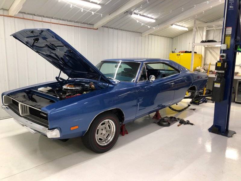

69 Charger. 426 Hemi. EFI E85

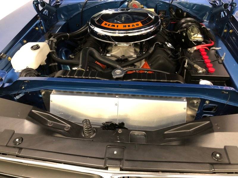

After reading through the old Chrysler testing documents on Aerowarriors I decided to attempt improving some things.

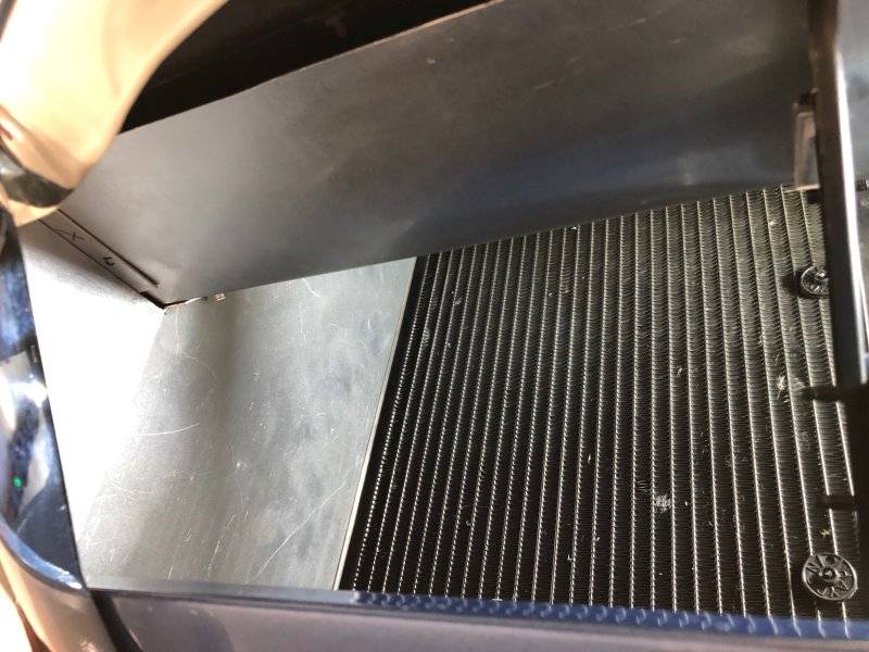

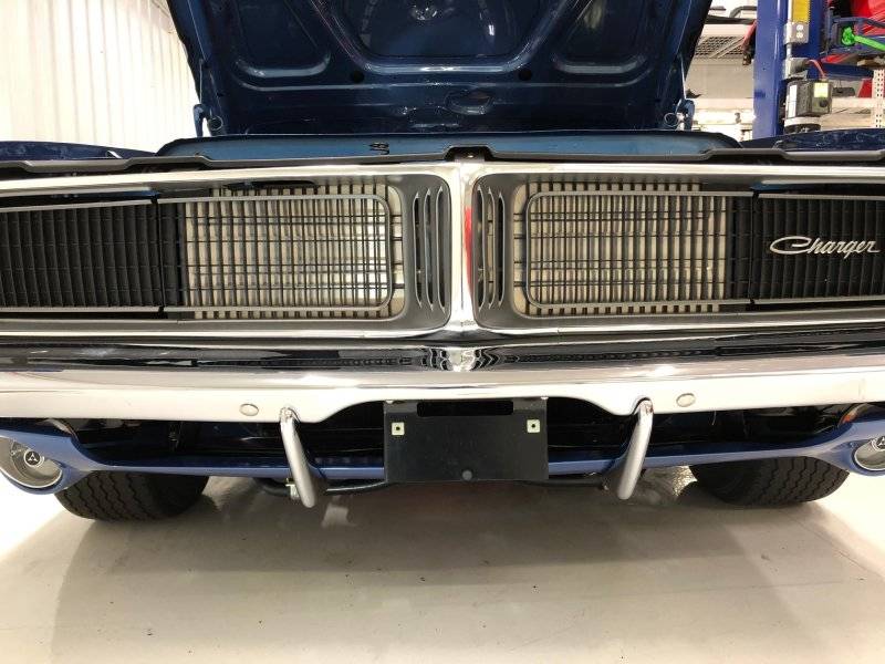

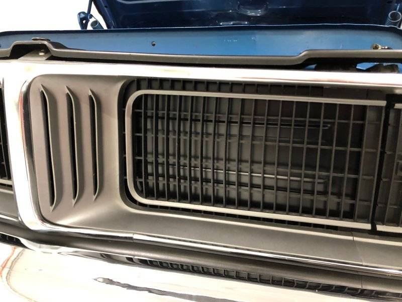

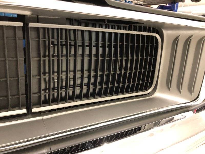

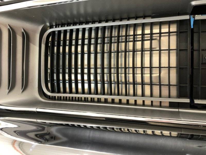

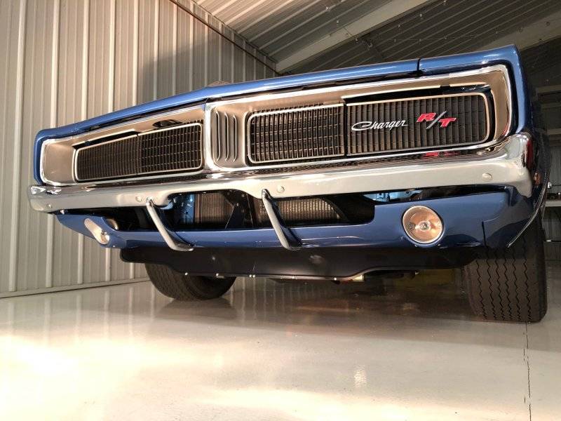

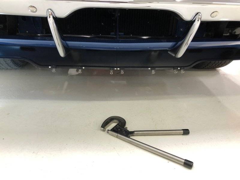

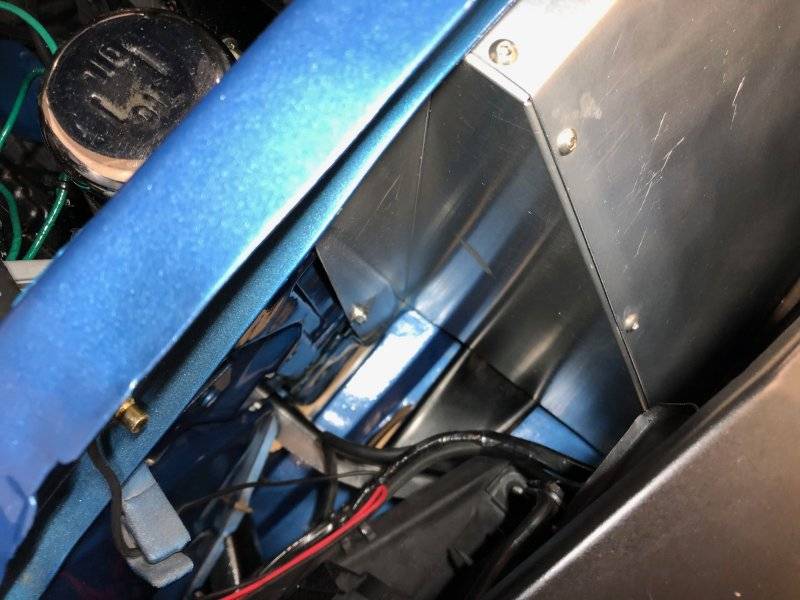

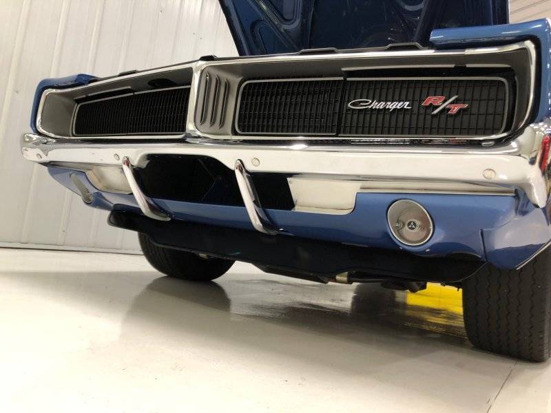

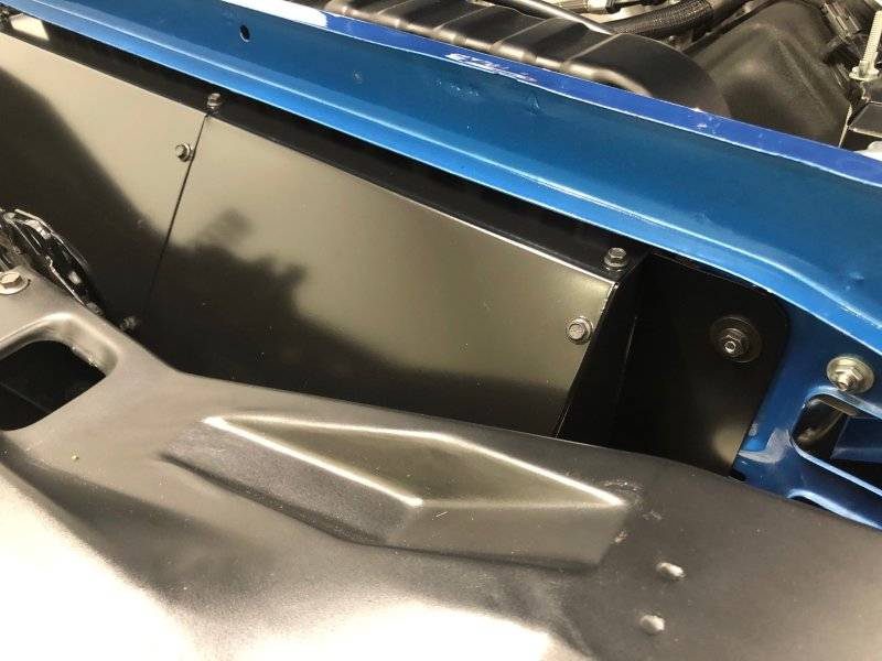

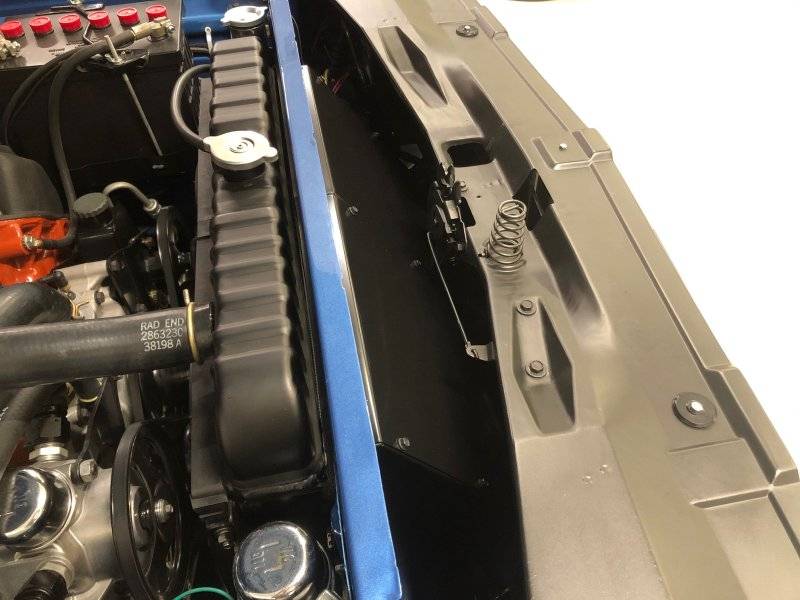

First I made panels to block the grilles so it takes all cooling system air from under the bumper..

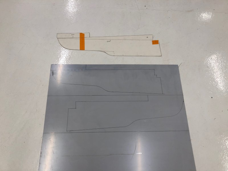

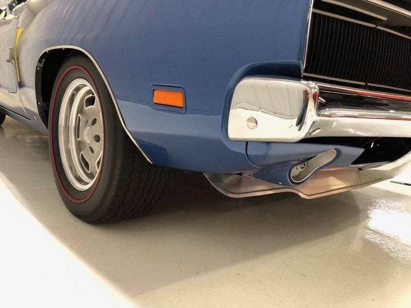

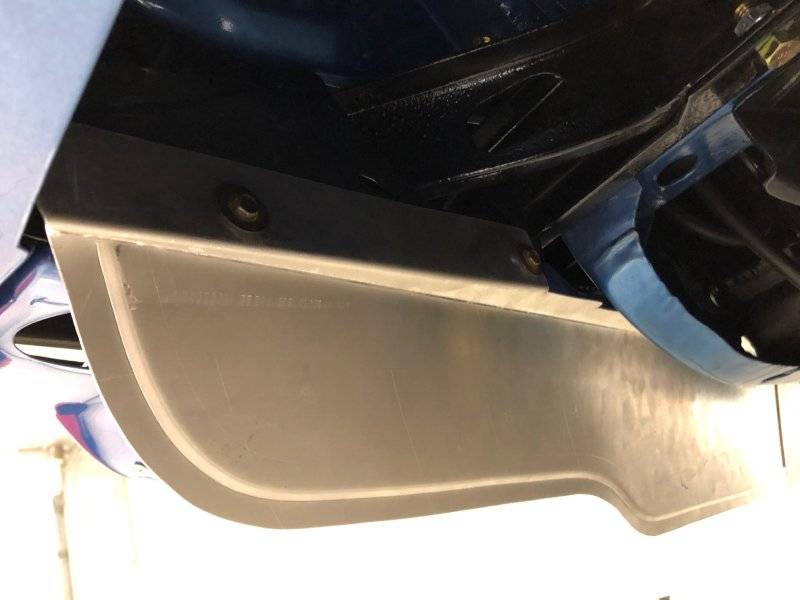

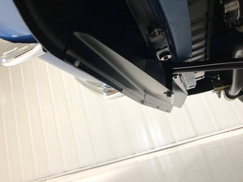

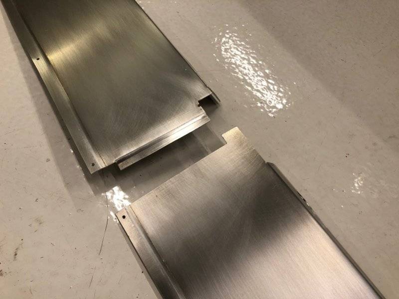

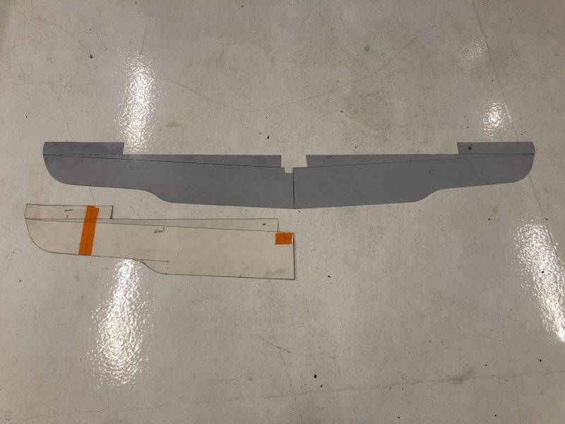

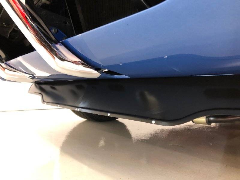

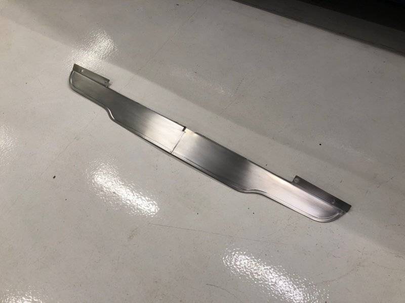

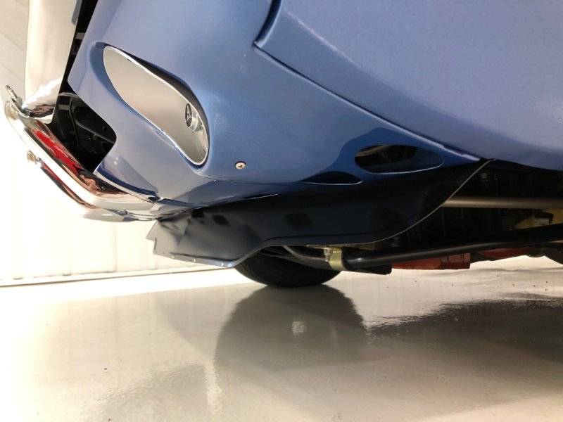

Next I wanted a front spoiler. I tried a Camaro spoiler but didn't love the looks and also thought I would prefer if it was in the recess of the valance rather than drilling the valance and bolting through it.
So, I made one.

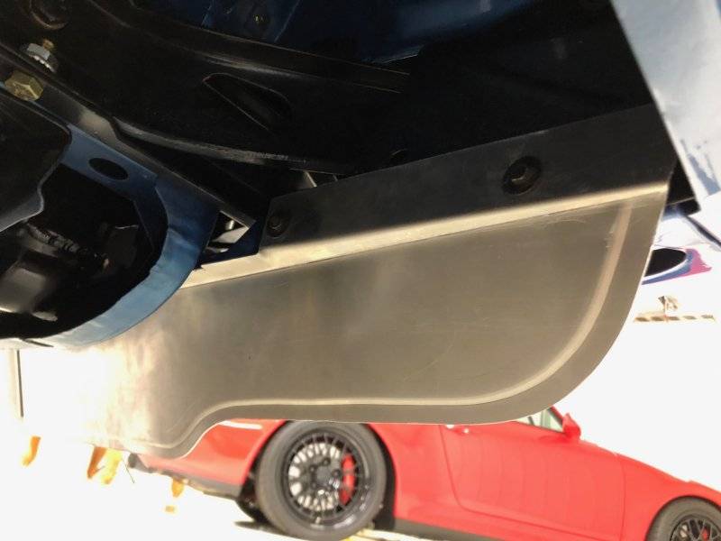

Finished it up with some satin black. Made a brace and attached with solid rivets. (that I will probably paint as well)

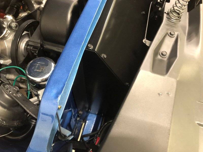

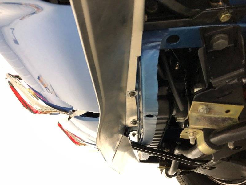

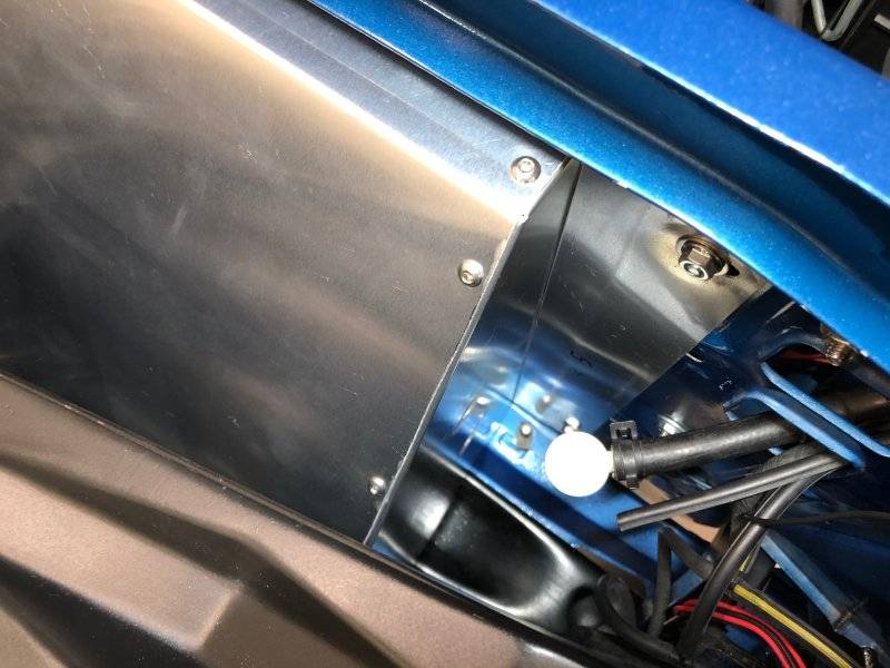

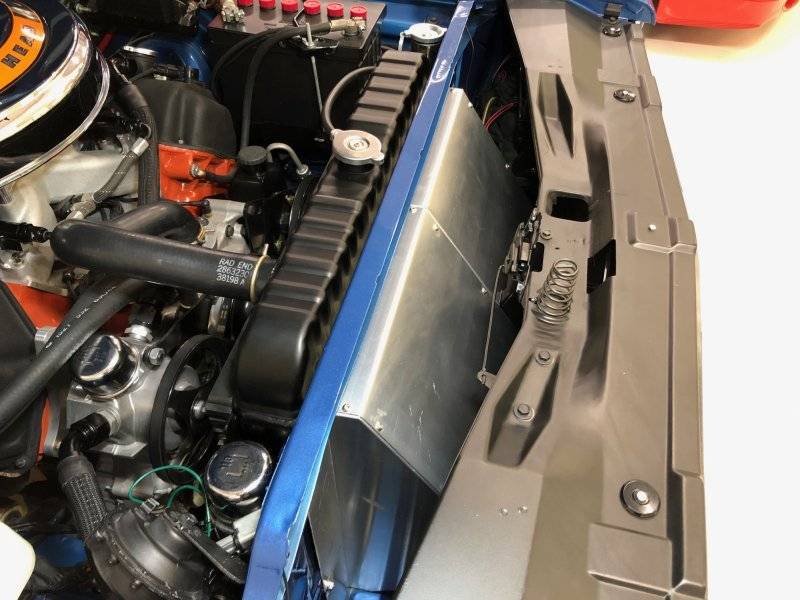

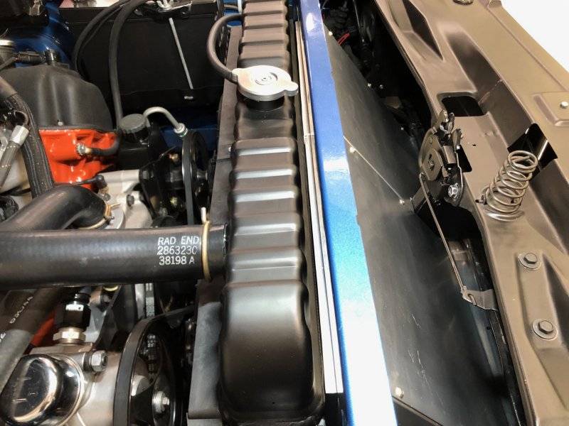

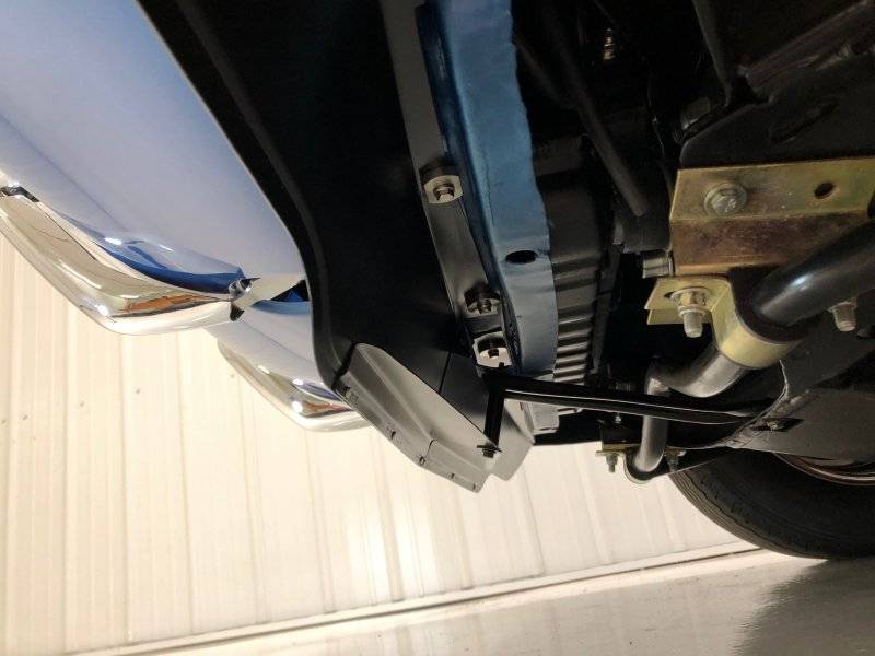

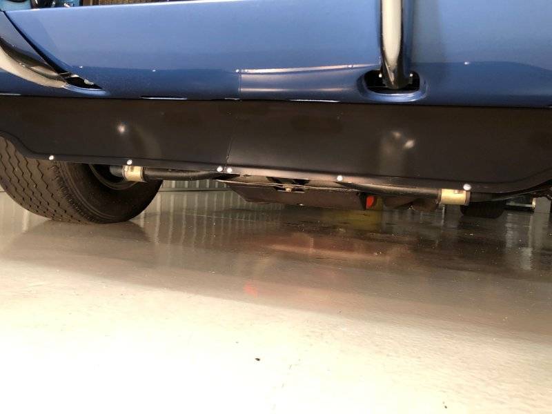

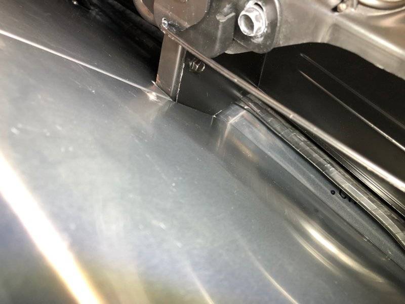

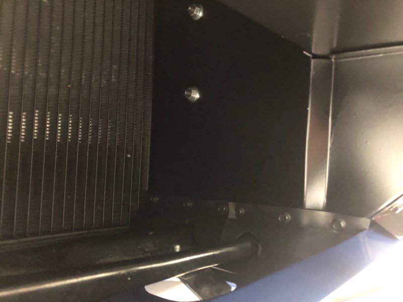

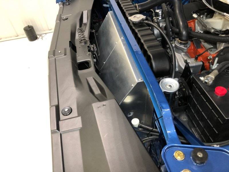

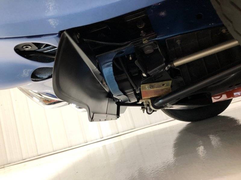

Next was building a radiator shroud and blocking off other lower airflow to the sides. (not quite finished)
Not sure if a -finished- update will really matter as it's harder to see painted but so far seems to be working out great.
86deg outside today and temp gauge wouldn't touch 170 after an hour of driving. (E85 helps for sure)

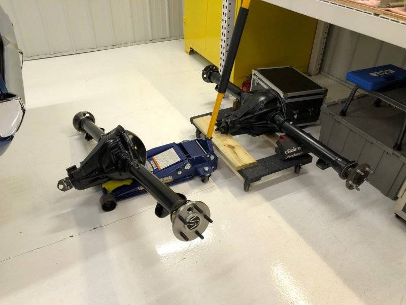

After driving this a bit I decided it needed more gear. Heavy car and high-ish rpm engine. I wanted to go from 4.10 (which I changed once from 3.54) to 4.56.
That would mean new ring/pinion. Differential, axles, bearings, seals and a bit of a suck job with the shims under the diff bearings.
So, decided to just remove the original Dana and order up an S60 with 4.56, truetrac, 35spline axles and mopar pattern housing ends that accept big ford tapered bearings.
I'm now past the 3rd heat cycle so giving it a bit more throttle and loving it. Feels perfect :)

It's a 2.87 first gear
Looking at it another way, with a 7,800rpm shift point it's reaching the same MPH per gear as the same trans with 3.55 gears and a 6000rpm shift point.
