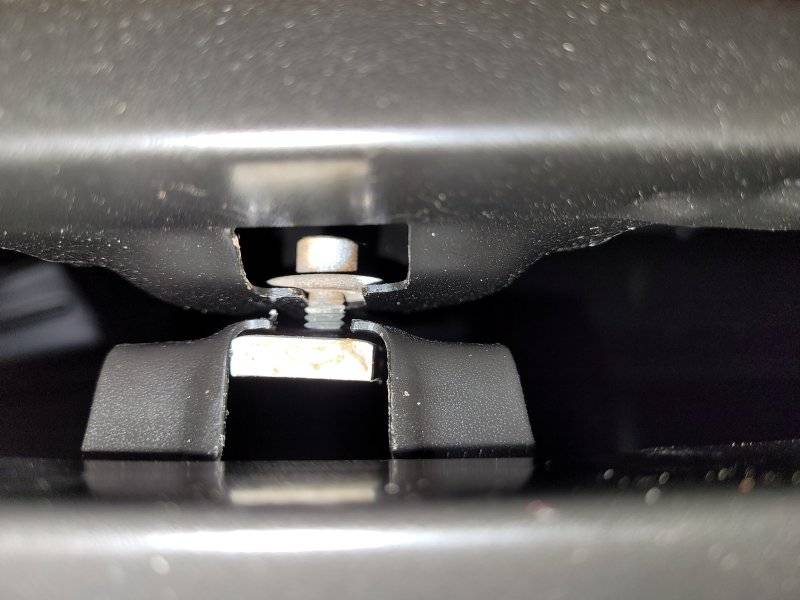

Can anyone tell me where these small plate install? I don't see them on the diagram. Thank you
Drops in the slot to clamp the vent frame. Look down into the "glass" slot and you'll see where it goes.. I'll go look for a picture..
Here ya go... Allen head socket is accessible through the little hole in the inner door panel.
