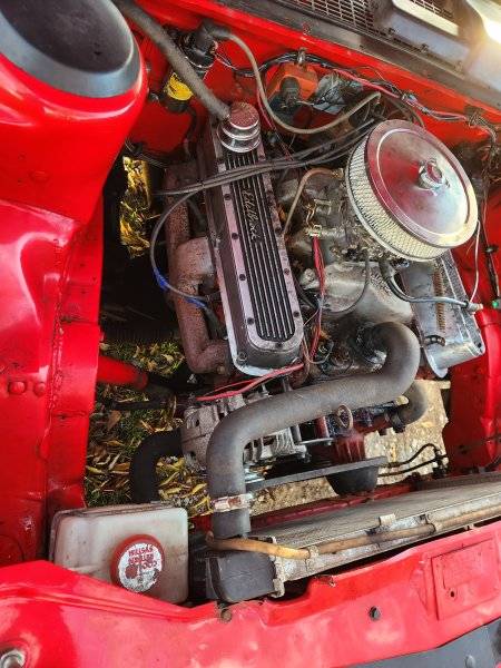

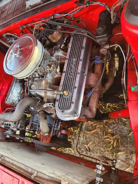

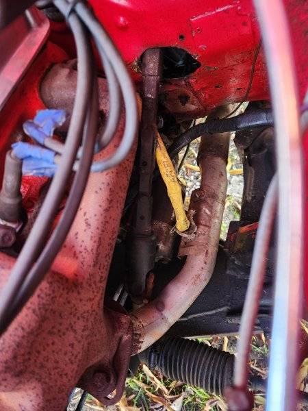

Question. Is a starter the same location in the engine bay between small blocks and big blocks? Pictured is my tight spot with a 340 in a Plymouth laser wanting to go to 440. From what I measured the differences is near the top of the motor like heads? Is the front to back length the same? Also pictured is spool type motor mounts, how can you tell if they are from small block or big block, didn't see numbers on the other set I have. Thank you everyone.

That's what I thought, just double checking. Really trying to figure if a 440 is a easy drop in with this steering
I take it as he means the general location of the starter, from side-to-side and relative location in the engine bay.
Yes. The exact location in regards to the engine bay between the different motors. Trying to see if the starter is going to hit the steering shaft after going through the swap to a big block.

On the steering.... as long as your sector/gear box is in its correct location .You can use d shaft u joints and pillow block bearings to move the column shaft some.
Keep in mind you can't go crazy with 45 degree angles ect. But you can get some room if the D shaft is supported at each splice.
