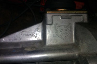

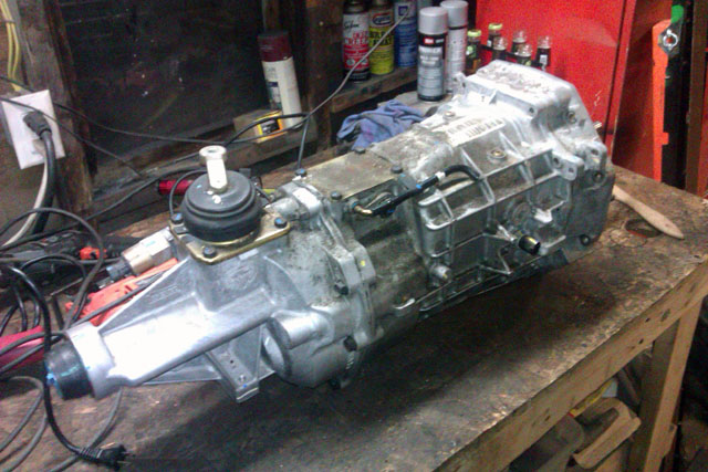

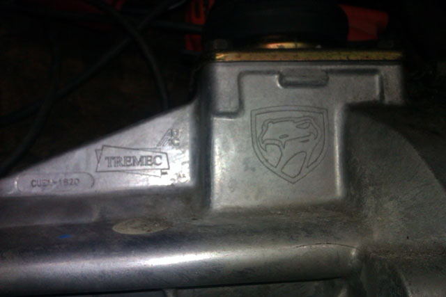

    Not a whole lot done to the Coronet today. Had some running around to do, gas bottles to fill, and scrap metal to buy. After getting all of my running done I came home and started looking around on Craigslist. I found me a sweet little upgrade for the car.
    Yup the Coronet is officially going to have a man pedal. The guy I bought it from listed it today for $1000 and I got it for $900. He told me that he had 3 other people who called him on this trans after me. I think I can believe him because when I see Viper T56's for sale on Craigslist they are gone within hours of the listing. This one is missing the throwout bearing and I'm hoping I can get one for it. I also need to get a manual for this trans because I don't know anything about them. I also figure I'm going to be studying 747 and Khans threads so I can do what they did to make this work for me.

      I can't wait to see the final product myself. As for the trans I'll definitely learn it but master it???????? I did download the manual from the Tremec site and also downloaded a full tutorial from a Viper forum so I should be good.

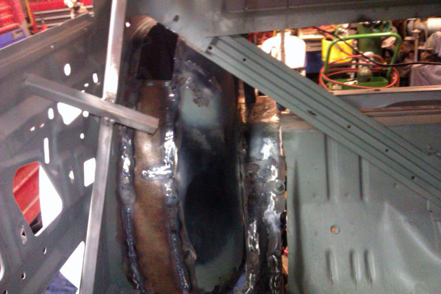

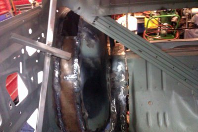

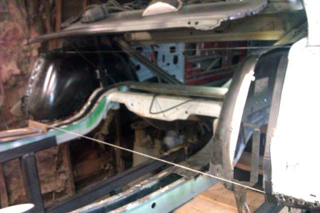

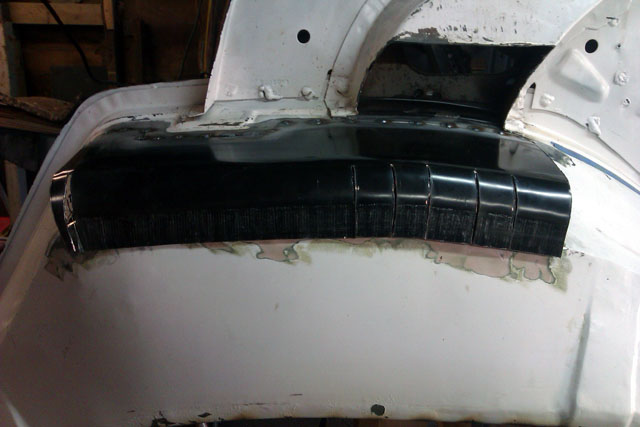

      Now that the spring relocation is done on this side and the frame is boxed it's time to put the mini tub together. I ran string from the left wheel tub to the same place on the right tub so I could line up the back half of the right tub. Right now it's clamped in place. I'll screw it to the frame before tacking it in place so I can add the center strip of metal to the wheel tub.

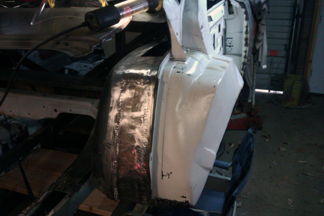

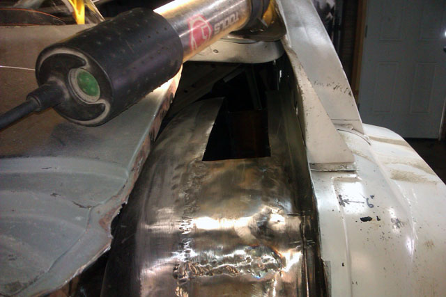

        After school today I made it out to the garage for some welding.
        Got it tacked in place.
        Then finished it off. Now to do the back half.

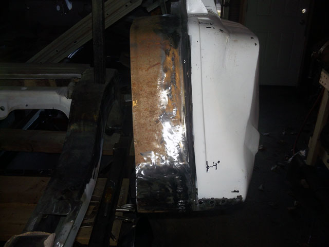

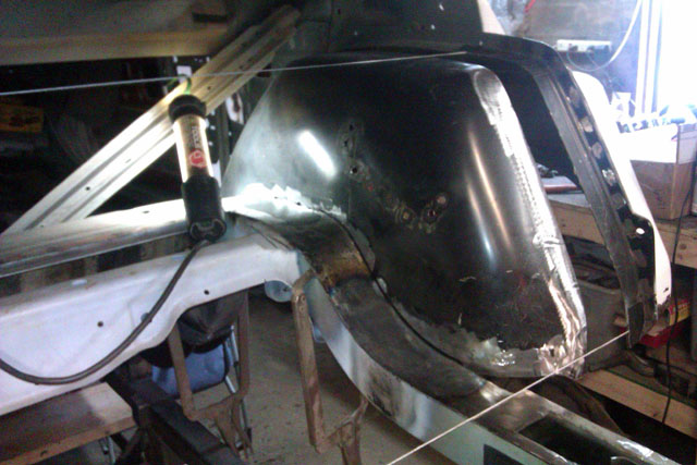

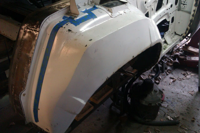

          Ever closer to finishing the mini tub on this side. All that's left is to fit the top piece and this side will be done. I'm also going to redo the outside wheel well to completely remove the hump like hemirunner did. What can I say this site has a lot of inventive and great ideas when it comes to Mopars. Why not emulate some of those modifications and hopefully have an idea of my own to add at some point. :headbang:

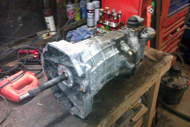

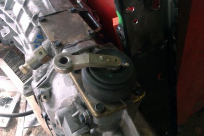

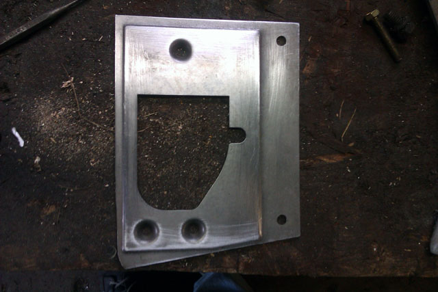

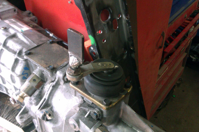

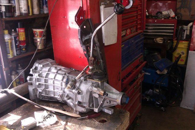

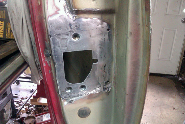

          Switching it up a bit from all the fit, weld, grind on the wheel tubs. :buffer: I find that I have to take a brake from the metalwork, do something else, then comeback to it, so I figured I would tackle one of the issues with the T56. As you can see in the pics the trans did not come with the adapter for a shifter handle and I can't seem to find that piece by itself online. I could buy a complete shifter assembly just to get that piece but I really didn't want to do that when the shifter I have works just fine.

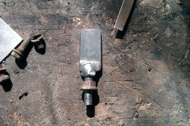

          After going to a few of the larger junkyards in the area in search of the missing piece of the shifter assembly, I came up empty. Since I can't seem to find the piece that I need, I decided to just make it.
          It looks pretty good and locks in place with the jam nut for a solid fit. :headbang:
          A quick mockup with a shifter handle I had laying around in the shop. I will need to find a shorter shifter handle because I think this one would be hitting the top of the dash if I were to use it. Can anyone say ape hanger????? Now to look online or a swap meet for a shifter handle that will look good for my setup.

          When installed the shifter comes out pretty far foward for me, I ended up making an offset handle for mine to land it comfortably in my hand. I say this just as a precaution, I'd wait until it's in the car before settling on a handle.

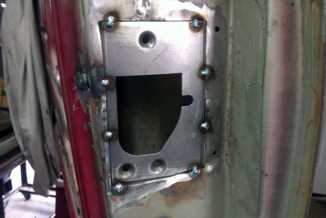

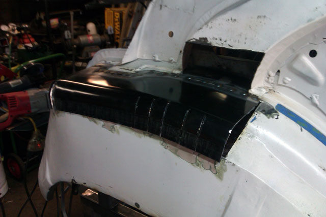

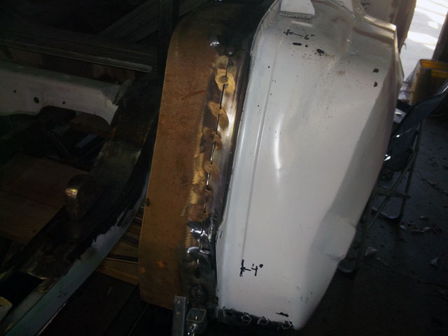

            Been having a lot of school work lately that won't let me work on the Coronet as much as I'd like. I was able to get back out to the garage today and decided to do a little work on my passenger door. Whoever owned the car before me must have loved to beat on this thing. The latch on the passenger side door was virtually nonexistent and a large hole was in it's place. The metal was twisted and jagged like the latch was ripped out of the door. Cracks radiated out from the hole and needed to be repaired. I bought the door latch repair kit from Dynamic Renovations to fix both of my doors. The piece is sturdy just as they said it would be. It's made from 16g metal so it's a bit thicker than the original doors. Here's how it turned out. i think it looks pretty good. (I never think to take pictures before I start the work, just during. :dontknow: )

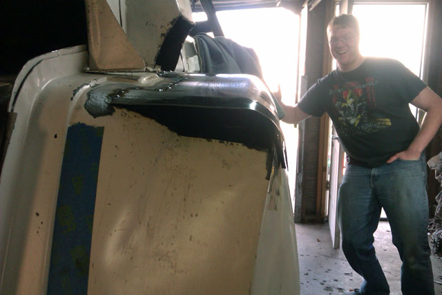

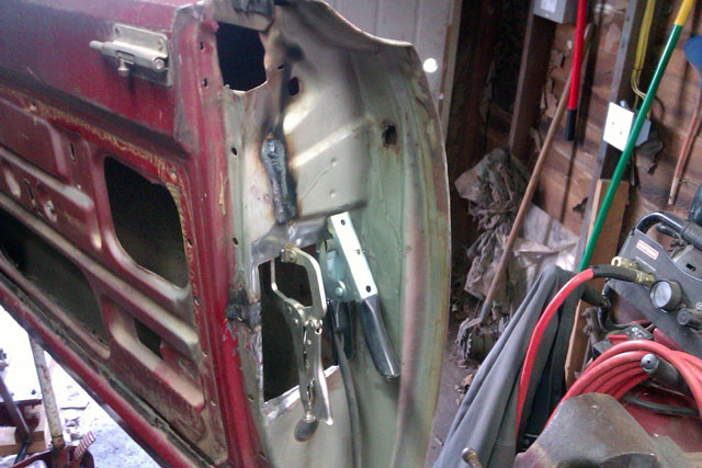

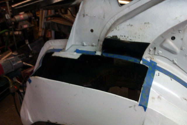

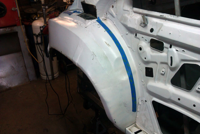

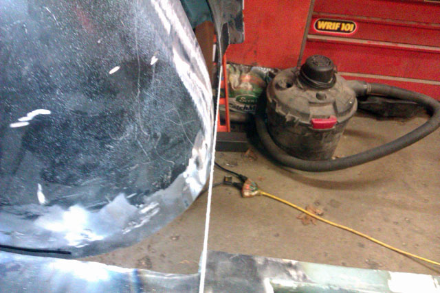

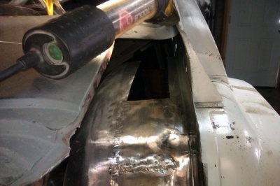

                More work on the Coronet today after the drug test for my new job. Started working on fully removing the hump from the outer wheel well. I figure the best way to do this is to start in the middle and work my way down both sides. I should have done the same with the minitub but it's a learning curve in progress.
                Pics that are close to the start of this.
                Cut out the first section
                My boy likes the idea of MAXIMUM TIRE SIZE!!!!!!!!!! :headbang:
                Hopefully I'll be able to do more tomorrow.
