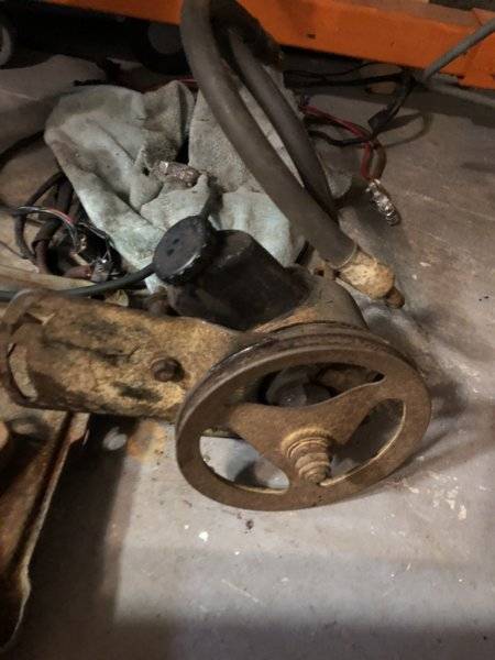

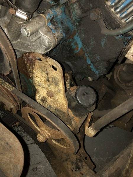

What power steering pump do I have? I need to order new hoses.

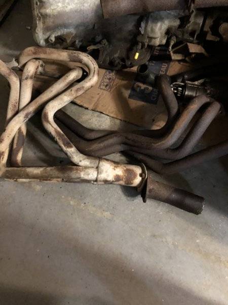

For the headers: the only car I ran headers on was a '75 Cordoba with a 360. If I remember right, the passenger side was easy, but the driver side required lifting the engine and coming up from the bottom so the car had to jacked up high enough so that the header had enough room to stand up as I went up with it.
Well, I finally got those f*****g headers off...remove center link, starter, lift motor... I sure hope there’s an easier way to reinstall them....do I install the motor with them attached?

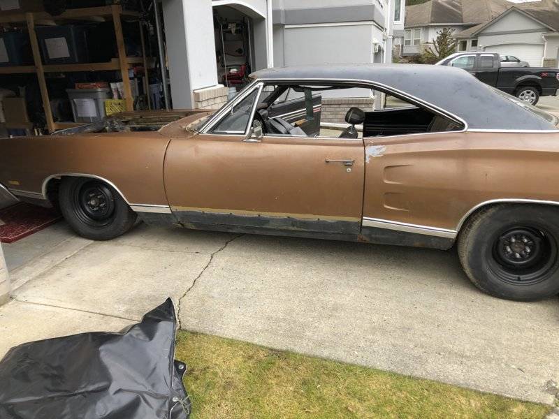

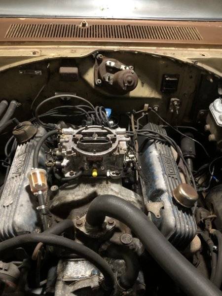

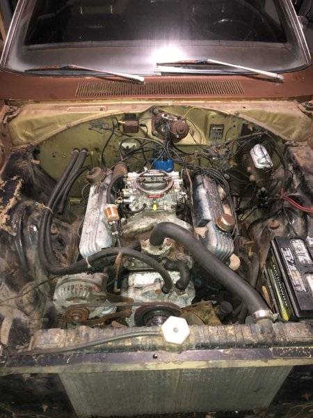

View attachment 904467 View attachment 904468 View attachment 904469 View attachment 904466 So, I’ve had the Coronet home for a week now. I’ve settled on my plan of attack. Like I said previously, the car was running when I bought it, but since I’ve been home, I haven’t been able to get it to start. I’ve basically ordered everything new for under the hood...wiring harness, electronic ignition, coil, plug wires, relays, etc. As you can see in the pics, the salt air hasn’t been nice to the car, everything is covered in surface rust :( Also, the wiring was a complete mess! I figured it’s best just to start from scratch. My only deviation to the original plan is that I’m now going to pull the motor/trans, clean it up, re-gasket, paint and throw it back in.
Here’s some pics.

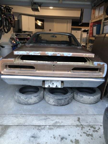

I also pulled the grill and tail light panel out to clean them up. There’s a lot of green mould/mildew on everything. Also, the tail panel was painted with a brush at one time lol. Everything is in good shape, there’s only a couple of broken posts on the tail panel. Since it’s just going to be a driver, I will try polishing it up and painting it myself.

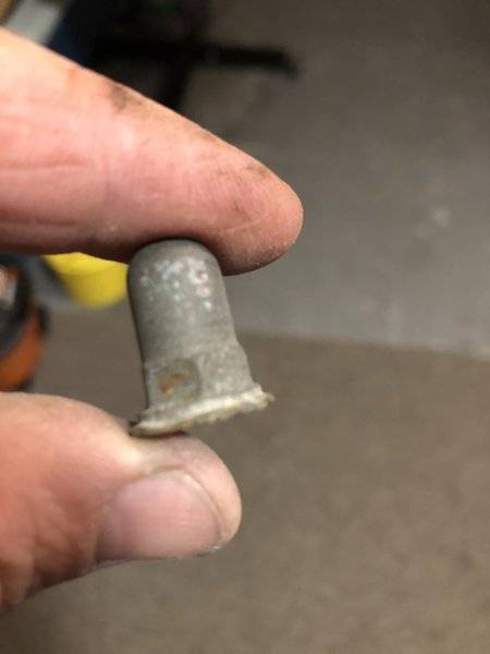

Does anyone know where I can get these pal nuts? They look like they had some sort of rubber gasket or insert. Mostly all rotten away.
As for your pal nut issue, on the last resto I did, I merely cleaned the nuts up and used this (or something similar from 3M, since the product specs don't give a diameter):
3M Calk Strips Black 60 Strips 1 ft each Rubber Caulking Material 08578.
wrap a piece around each "pin" and tightened the nut, squeezing out the excess, which forms the seal.

I'll try that, thanks!

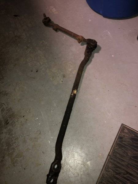

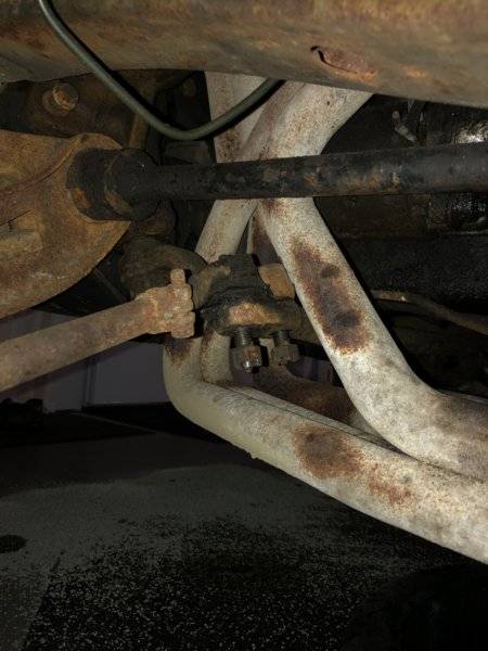

View attachment 905509 View attachment 905510 I started getting everything prepped to pull the motor and trans...first roadblock was that the center drag link went through the driver side header....I got a pickle fork but one of the tie rod ends absolutely refused to pop...I don’t think any of these parts have ever been replaced!
I still can’t get the headers out, can I lift the engine slightly? What’s the secret to B body headers???
Yes, pull the motor mount bolt on the side you need to lift and loosen other side bolt . It should swing up enough to pull header.
Have someone up top watching clearance on other stuff while jacking from below. A block of wood on jack placed slightly over to the side you want to lift

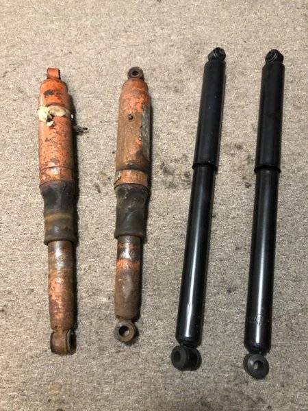

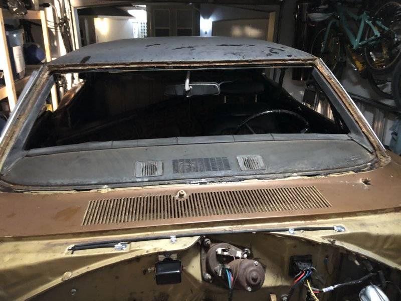

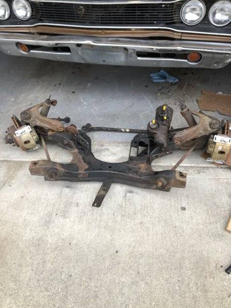

I got the front suspension out last weekend, just about got everything sandblasted just need to do the K member then paint, re-assemble and install. My goal is to get the front end installed in the next week or so, then just wait on the motor. I ended up pulling the windshield and rear glass trim...it’s rusty back there! After much swearing and swearing, I also got the air shocks out of the back and replaced with some shocks a buddy had laying around.

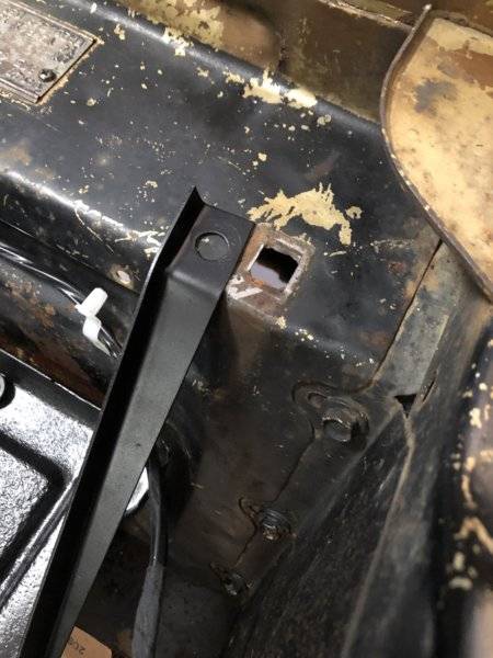

I got the battery tray blasted and painted but not sure how to attach the upper brace to the inner fender...there’s a square hole on the inner fender and my battery was never attached there when I got the car.

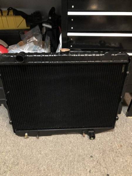

Had a local shop ‘clean up’ the original radiator...it turned out spectacular!! It’s the nicest thing in the car lol

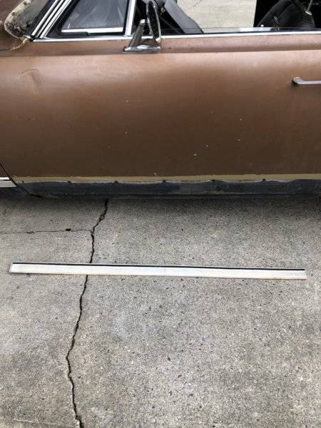

Also, I was able to find the missing door moulding, it was a bit pricey but now it’s all complete. Does anyone know what clips are used or how to take the other door moulding off so I can check the clips?
