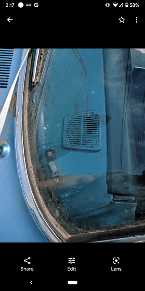

My painter who is going to paint my Dash says the two side speakers have been drilled in... I was completely under the assumption they were stuck from factory.
How would I confirm if my car had this original or not? I have the build sheets and fender tag, would they show?
What about position and placement?
And would my VIN plate be black originally?

I don’t want to speak out of turn but that grill looks like it’s turned 1/4 turn from where it should be? I don’t have any R22 cars here right now to compare.
Interestingly, I have seen a few different survivor dashes and they had the grills mounted in different "clocks". When you removed them there were marks to validate they were always like that. I suspect that since the holes allow it to be rotated that the factory was non specific during installation. Careless assembly that wasn't an issue.
Ok interesting on the grille placement

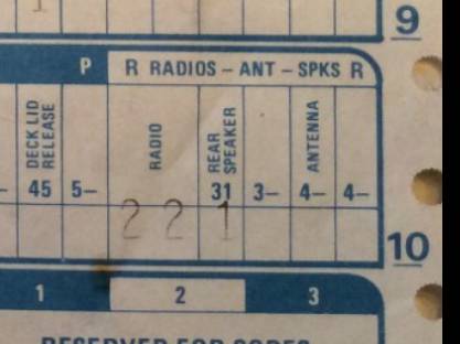

R22 is AM 8 track stereo. The rear speaker was not part of that. But it could be added as an option to an R22 radio. That’s just one rear speaker.
I had a 1970 with R22 and R31 rear speaker

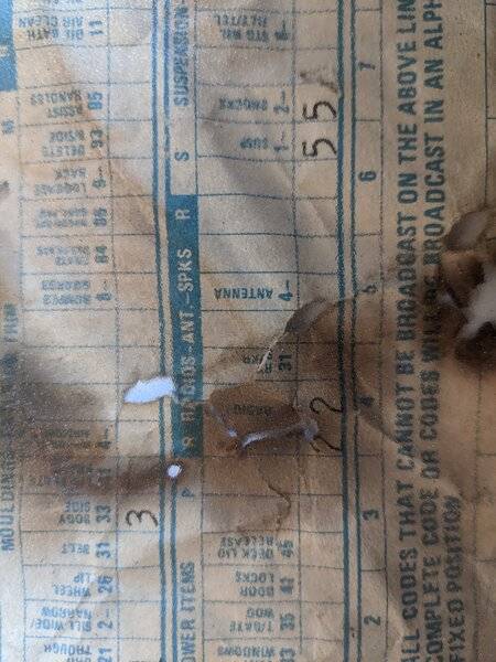

Here is a pic of the sheet

I will post a picture of my build sheet shortly.

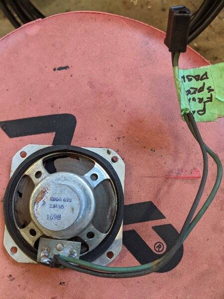

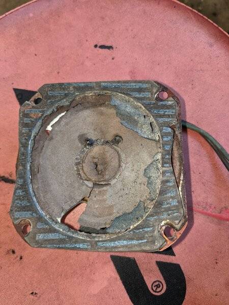

I still have the speakers too maybe I'll post those and look for a date.

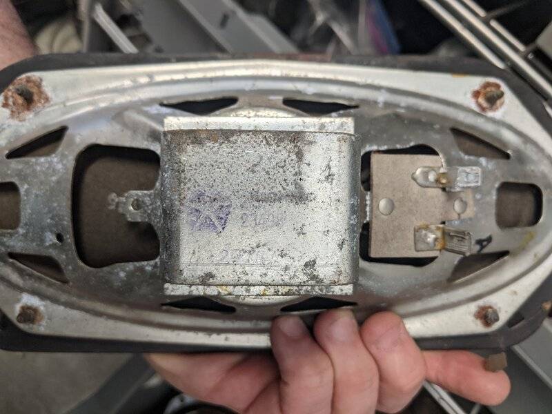

More photos...
They don't have the Chrysler symbol like the center speaker had. Does have the code 22 but not sure about the "R".

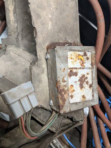

This is the top of my glove box I'm assuming this is the receiver piece you were talking about.
Do they all have this or only if they have the front two speakers?
Only with two front speakers. That is good indication that it came with it. You can't always trust the codes. Plant workers could order a car and then follow it down the line talking to their Union buddies. Hey buddy, help me out and put those wheels on it for me, that radio, steering wheel, etc. The AM/8-Track radio bezel can be hard to find.
