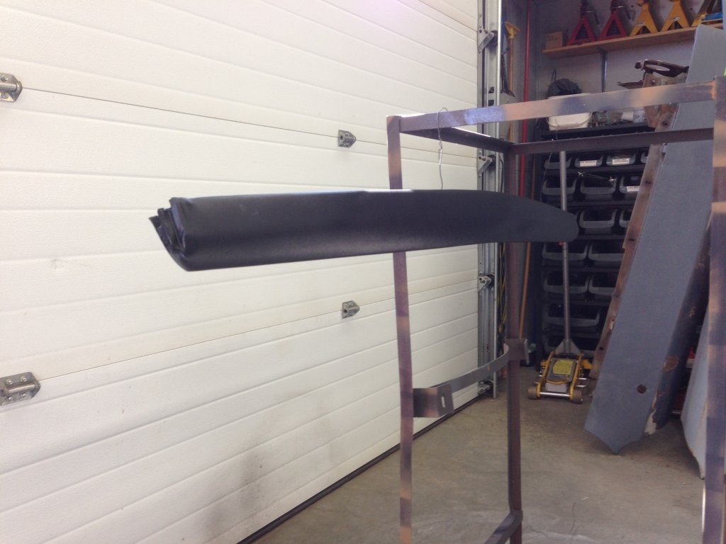

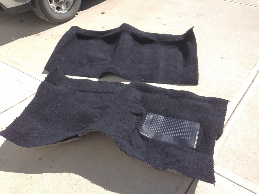

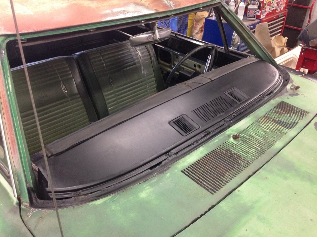

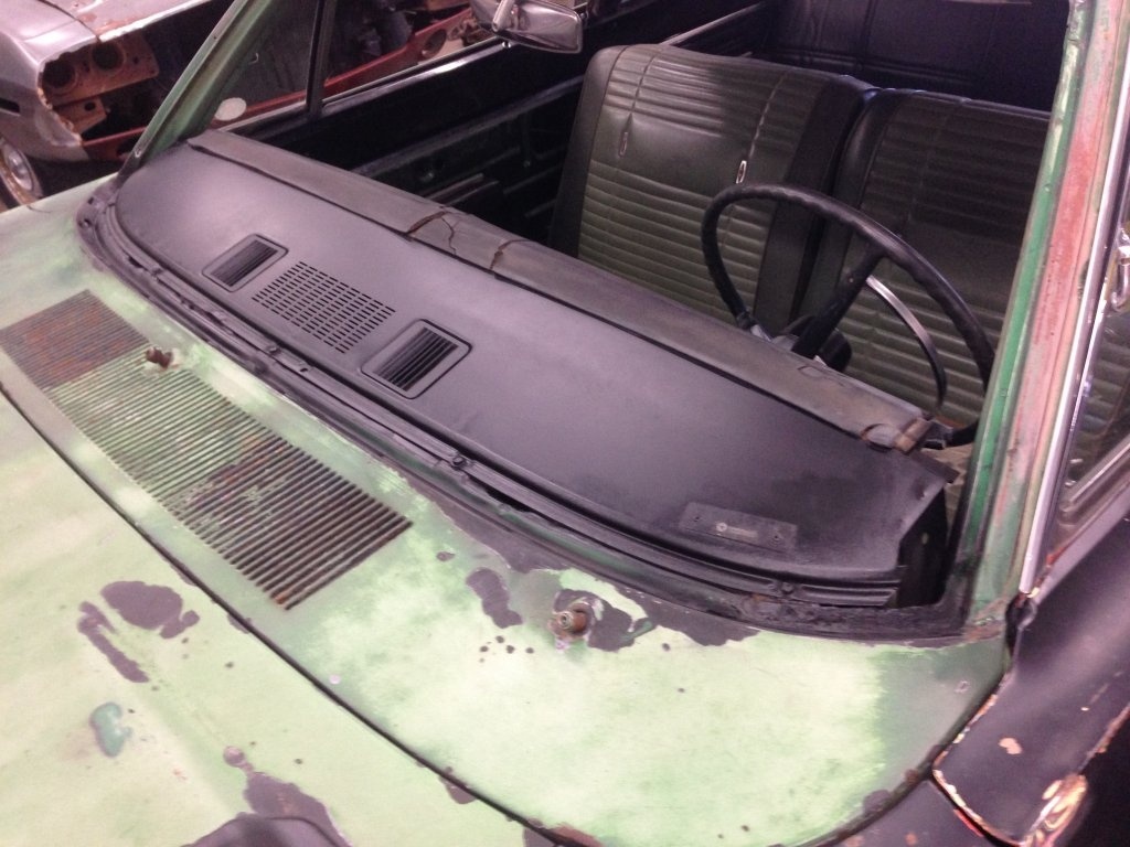

Well, some of the final treats have arrived. I'll admit, I was going to get it on the road without a headliner or carpet or a better dash pad. But While I was driving home from up north I called a buddy and just kept on asking if he had this or that......... :) So, I got new front signal lenses, headliner, carpet, decent dash pad (Painted it today), and the trim for around the back window inside. I will have to make the sail panel boards as the car did not come with any.
