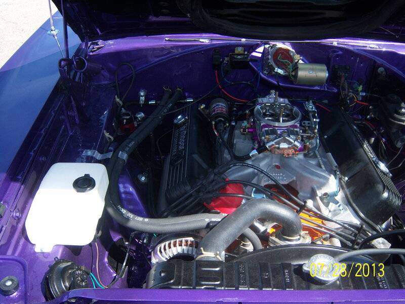

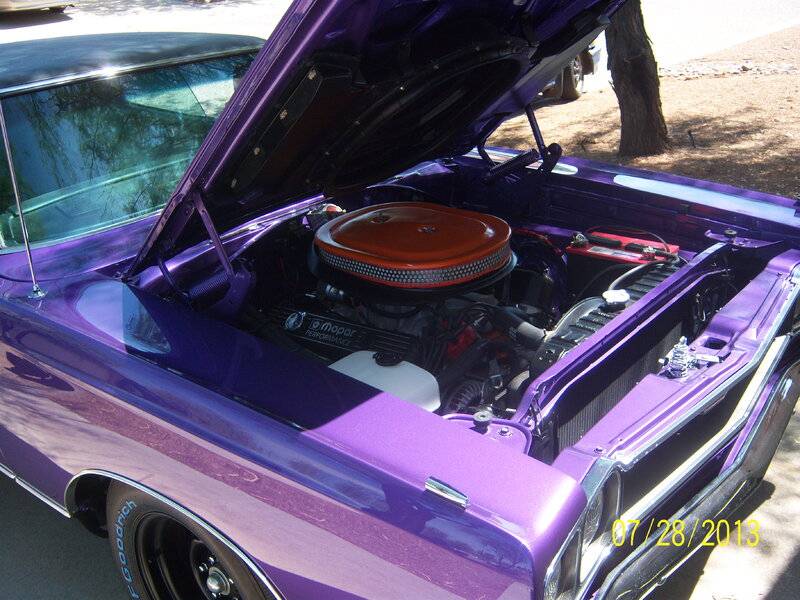

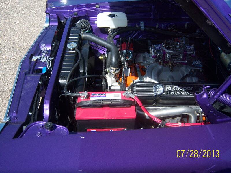

I have air grabber on my 69 GTX. I have a Holley Street Dominator intake on an RB block

Which intake are running? That is definitely not the stock intake.
You quoted the answer. He is running a Holley Street Dominator........

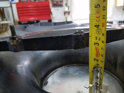

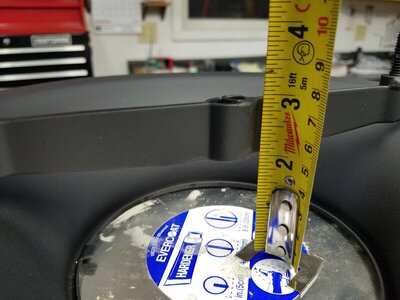

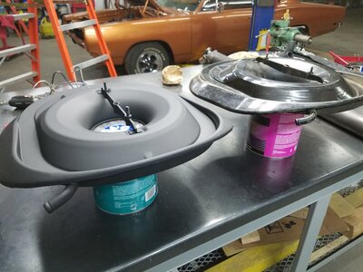

If you dig through my Super Bee restoration thread, I posted pics comparing the 2 base plates.

What hunt2elk said. Airgrabber clearance is TIGHT. You've got "roughly" 1" of increased height to play with + an extra roughly 1" (total of 2") if you have a 383/400 low deck motor and use the shorter 440 airgrabber air cleaner.
Feel your pain. I have a 440 in mine with the CH4B intake. Used a repro 440 base and the lid is line to line with the hood. So going to trim the repro base to fit.
I haven’t fit up the air grabber center section yet but looks like I need 1/2 inch off the base.
