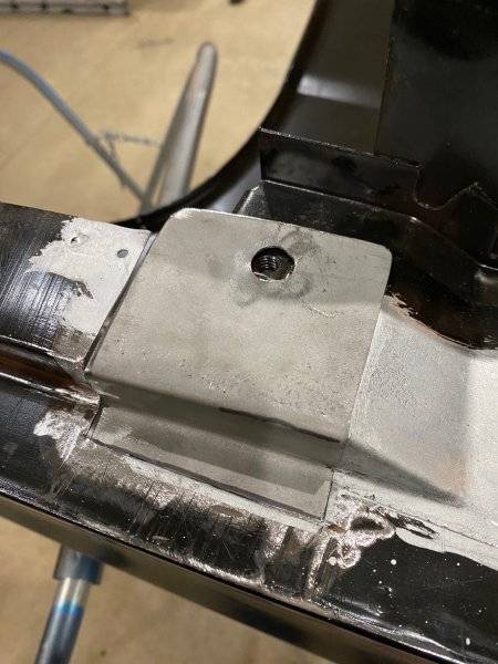

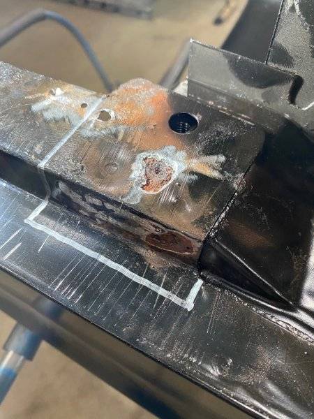

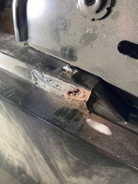

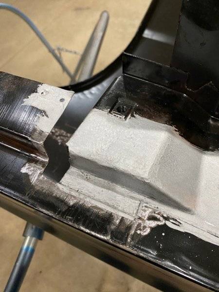

I did pull off passenger fender as I saw some rust bubbling through the e coat. Come to find out there was a previous repair that wasn’t as clean as it should have been. Had to remove fender to radiator support bracket, but I was able to remove and patch rotted area.
All in all I think it turned out pretty good. Most of it gets hidden when the bracket goes back on, but I wanted it to look somewhat professional, LOL.

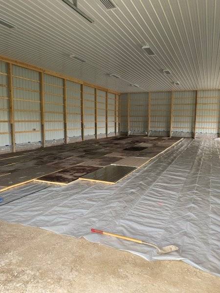

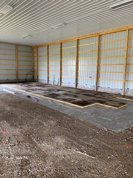

I put the car on the back burner for a while. In addition to playing a lot of golf this summer, I’m also working to get the floor poured in my other building. I built the 60x80 building almost two years ago and the boss finally gave me the green light to put the floor in.

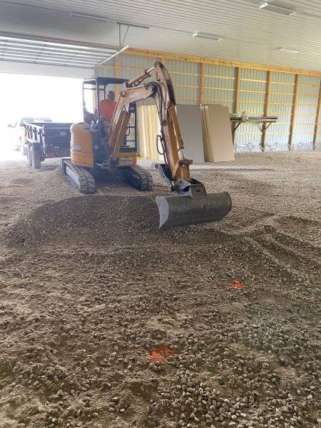

Since I’m putting radiant heat in the slab it’s requiring a lot more prep work. Got my brothers to help get the stone to grade.
Then I started putting down plastic sheeting for moisture barrier and then 2” foam. Fortunately I have a family friend who does commercial roofing and was able to get me some used foam sheets to save some money. I did have to buy some new sheet, but every little bit helps.
I just finished putting all the foam down and will put down mesh next to hold the tubing in place. If all goes as planned the floor will be poured by the end of July.
Wire mesh is down and tubing is nearly all in place. Concrete scheduled for the 29th. I can't wait for this to be done....
Man has the summer flown by. With getting the floor in the new building, two different golf leagues and totally replacing the deck on the back of the house the warm days are pretty much gone.
Here’s some pics of the finished floor in the new building. Already starting to fill the space with the cars my brother and I are hoarding.

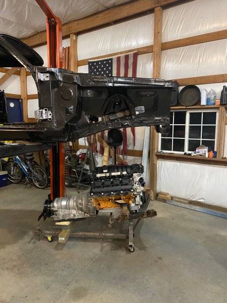

I finally got back into the other building to start on the roadrunner again. I got the engine and tranny put together and mounted on k member. Also mounted the swap cross member bracket.
Then we started to install in car to see what floor pan interferences we have to deal with. Before install, I did grind off unneeded tabs on top of tranny case for clearance.
Surprisingly, the only interference is the vent tube on top of the tranny and the stock cable bracket. There’s plenty of room between engine and firewall as well.

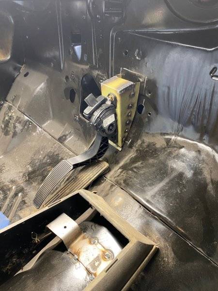

we moved onto mocking up a bracket for mounting the electronic gas pedal. It’s tricky trying to figure out the best angle for it without limiting the travel of the pedal. Here’s a few pics of our first pass on that.

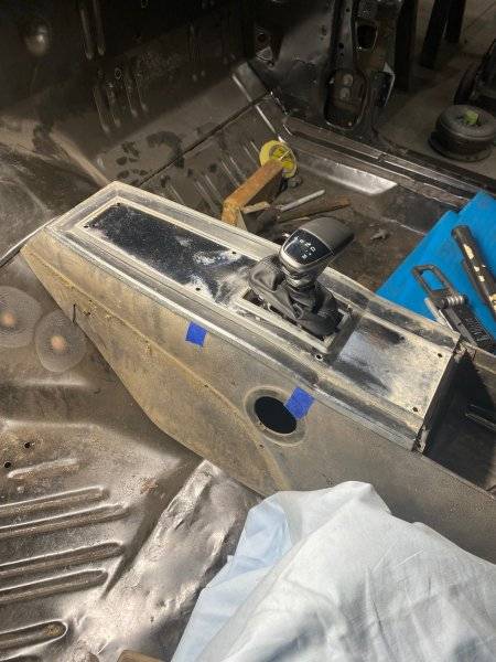

Im also working on mocking up what needs to be done to mount the electronic shifter. The OE center console bracket can’t be used as it interferes with the position of the new shifter. I’ll have to make another custom bracket for that as well so more pics to come once that is figured out.

I was messing around with gas pedal mount again to see if I could improve position so I cut another piece and trialed some new bend positions. I think I like this one better. I had the wife come out and sit in the seat. She gave me the thumbs up so now I just need to box it in and weld the stubs in prior to welding it in permanently.
I also worked on welding and adjusting the center console brackets back into place since we had to replace floor pan. I had to make concessions for the electronic shifter along the way. The original console that came with the car had the *** end broken off, but good enough for aligning mounting holes. After seeing how much new consoles are I just might make a custom one and use the original mounting brackets to lock it down.

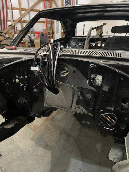

Since I want to hide the engine harness as much as possible we decided to route it through the firewall right behind the intake. The connectors on the wire harness are rather large requiring a 2” grommet and hiding it was my goal.
A friend came up with the idea to modify the firewall so it’s close enough to engine that the injector and coil connectors reach inside passenger compartment. This reduces the amount of main harness that has to go inside the engine bay. So we cut out a section below wiper motor and bent & patched in a new piece.
Just need to punch the hole for the grommet now and then reinstall engine to test out harness fit.

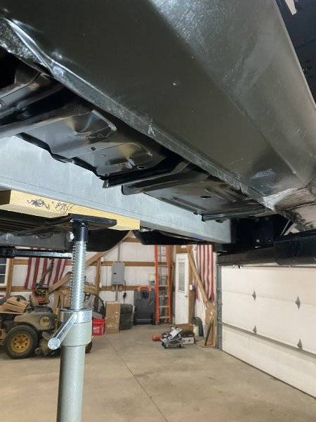

I also bought the frame stiffeners. Starting to get them fit and welded in place.
Made a little progress. Got the grommet put in and harness pulled through.

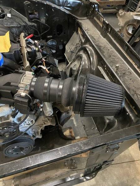

Getting back to the car now that summer activities are winding down. Engine and trans fitment is complete. Last item I wanted to confirm was if fresh air intake would fit without cutting a hole in inner fender. I had to modify K&N kit I bought, but it cleared without removing sheet metal.

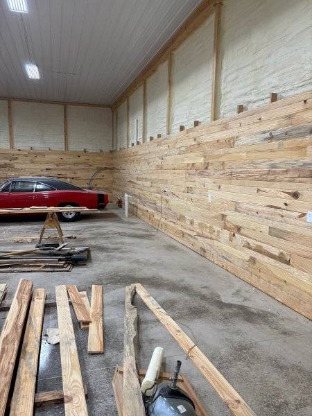

Spent a portion of last winter dressing up my new building. Installed tongue & groove board a little over 8 foot high. Plan is to finish the rest up to the ceiling with white metal, but not sure when that will get done.

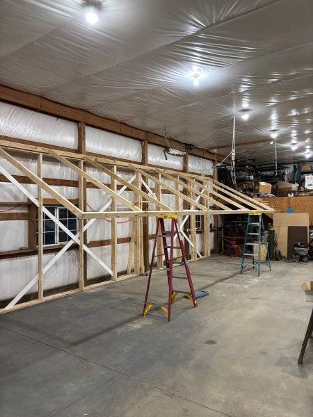

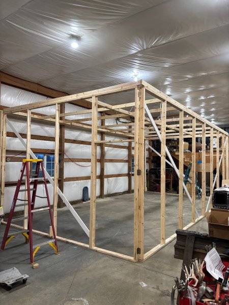

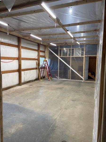

Then this spring we started to fabricate a semi permanent paint booth in the old barn. I found this plan for a "foldable" paint booth I liked as it doesn't permanently tie up all the floor space. When a car is finished, I can collapse the booth against the wall and regain the floor space as needed.

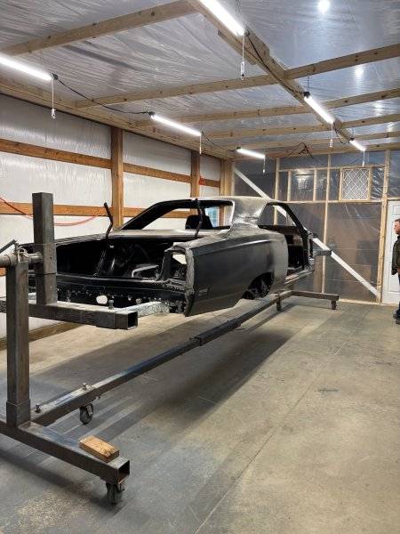

It provides a lot more room than our previous setup which is nice. We got the roadrunner on the rotisserie and put in the room.
Now I'm going back over the car to dress up any areas prior to shooting epoxy. I have to get final color shade picked out so I can shoot bed liner material and single stage over the epoxy on the bottom of the car. I hope to get back to regular work on the car in the coming weeks.

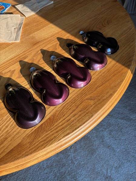

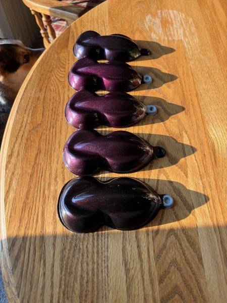

I was able to get another sample of paint to try. It's an improvement, but still a touch darker than I like.
In picture below, the sample labels are as follows going left to right.
Sample 1 - First color sample of base coat sprayed on black sealer.
Sample 2 - Second color sample of base coat sprayed on grey sealer
Sample 3 - Second color sample of single stage sprayed on grey sealer
Sample 4 - Second color sample of single stage sprayed on black sealer
Sample 5 - Odd ball color sample that was way too dark

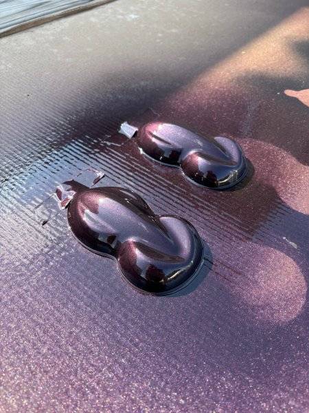

Here's another view for comparison.
I'm happy to see samples 3&4 match really good between the base coat and single stage on the grey sealer. This tells me they should match on black sealer/epoxy as well.
As I have black epoxy I plan on using, I think I need to lighten the paint a little more to avoid having to spray grey sealer over he epoxy before shooting single stage on the under carriage and engine bay.
