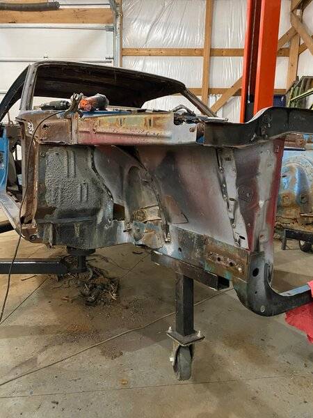

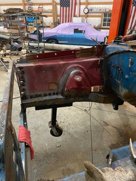

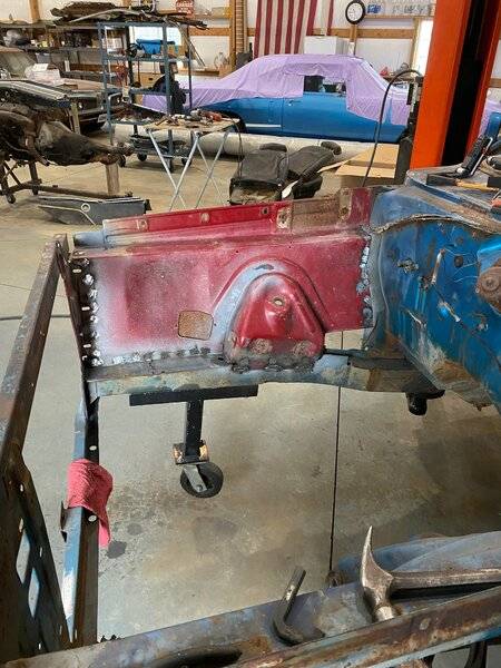

We moved to front passenger inner fender and radiator support that was heavily damaged from previous wreck. I looked at picking up either a used or new radiator support piece, but my brother had the idea of just converting another good piece by cutting out middle section and rewelding it together. I figured what the hell i’ll give it shot. I don’t think it turned out too bad and all the dimensions match up for the opening and cross car checks.
Once that was fabricated we needed to replace inner fender and shock tower. Fortunately all the damage was above frame rail so no replacement needed on that. Those pieces came from same donor section.

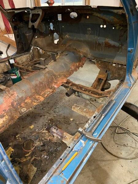

Next I moved onto cutting out the front floor pans to see how bad rear sections of front frame rails and cross member were. There a few small areas that will need patching, but overall they are salvageable. We left the center section of pan in place until it comes back from dipping just for support.

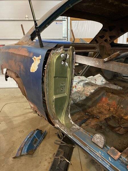

Tonight I moved onto passenger door jamb. This was heavily damaged from impact at some point. It was hit hard enough that the latch mechanism tore away from sheet metal and they just blobbed some weld on to try and hold it in place.
Based on the amount of rot and bondo in the quarter to jamb area I knew it needed replacement. Again, I had a good donor piece from another car so I removed the bad jamb.
I’ll work on cleaning up spot weld areas tomorrow night and prep putting on replacement jamb.

Replacement jamb welded into place. Everything lined up good so I should be to go.

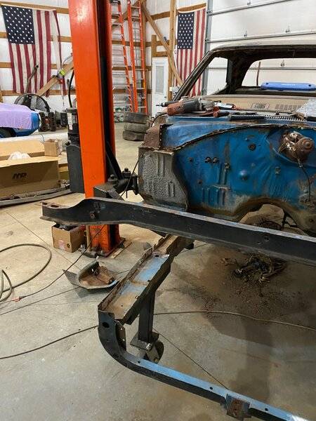

Moved onto the drivers front frame rail that was completely rotted out under shock tower support. Had a donor frame rail and support from another car so decided to cut out bad section and replace.
Replacement rail spot welded into place now. Just need to double check dim’s and tweak as needed before finishing up welding. Getting closer to having certain areas addressed before sending to dipper.

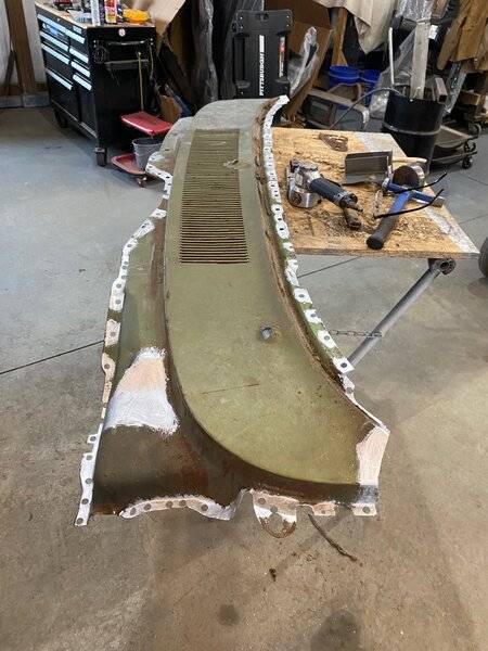

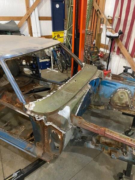

More progress pics from this week. First I needed to repair rusty area on driver inner fender behind hood hinge.
Then I replaced cowl with one from donor car that was in a lot better condition.

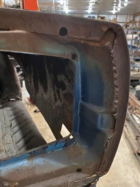

Moved to the back of the car and decided to remove dutchman panel as it had a lot of rust holes in window channel and the bottom corners above troughs. Had a replacement panel I bought at bats several years back so I figured I may as well use it.
Need to tweak some areas before panel will drop in place, but it appears it will work nicely. Ran out of argon so no welding till I can get the tank filled on Monday.
Progress has been slow going as of late. Based on the amount of metal I’ve been removing due to rot, my brother thought it best to get the frame jig done and under the car before I get too carried away.
Since his charger is way more solid than this roadrunner, we used his car to set up the jig. Took some time to get everything fit and bolted/welded into place, but it turned out good. Will be handy for keeping frame rails in position on this car as well as future projects.

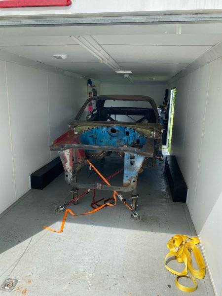

Got pans installed just in time to take car to dipper. I’m looking forward to seeing how it looks when it’s done there.

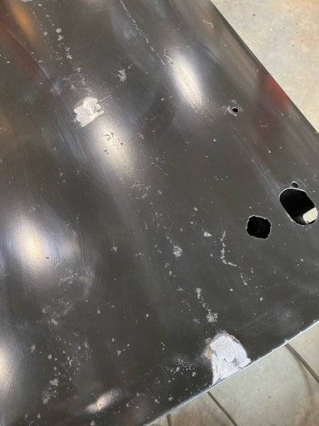

Until body is done at dipper, figured I’d start welding up trim holes on doors and fenders that aren’t needed.
