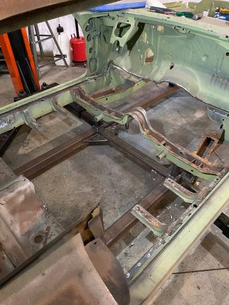

First thing on the list was cutting out front floor pan. All the frame rails are in excellent condition. Nothing like the rust issues I had on RR.

Before we install new pan we cut out a section of firewall that was rotted pretty bad. Looks as though the heater core was leaking or something causing the firewall to rust out. Going to fab a new piece and spot weld it in.

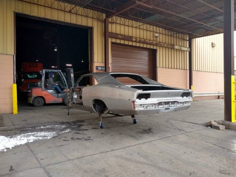

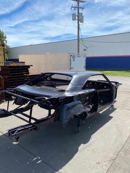

Picked up the runner today from the dipper. It turned out as expected, only a couple of spots that need some repair before hanging new metal.
Well upon further inspection, there are a couple areas that are worse off than I thought. Driver side rear frame rail is shot. Too many pin holes along it to try and repair so it’ll need replaced.
I also realized now that the inner and outer wheelhouses are welded every 1/4” or so versus the normal spot weld distances, so it’s going to be difficult to just replace outer on that side. I’m already planning to replace both inner and outer on driver side so I may as well get the other inner.

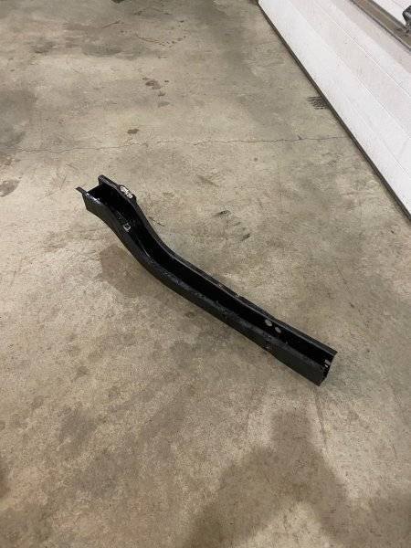

Finally got driver side rear frame rail replaced. Also cutting out and patching a few other smaller areas that were thin.

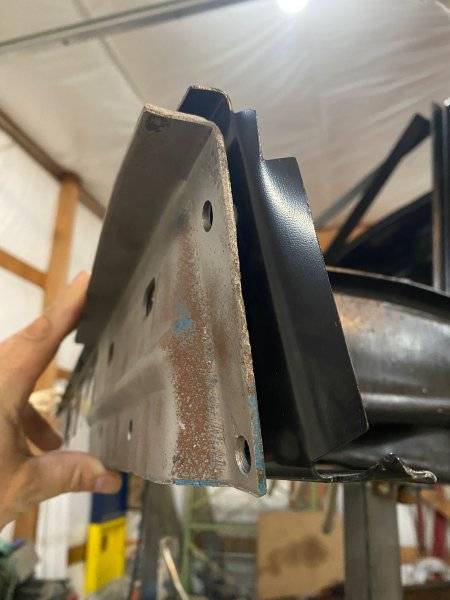

Wanted to weld on bumper reinforcements to new cross member, but there’s a significant gap at ends. AMD cross member not stamped at correct OE position??

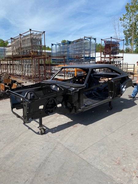

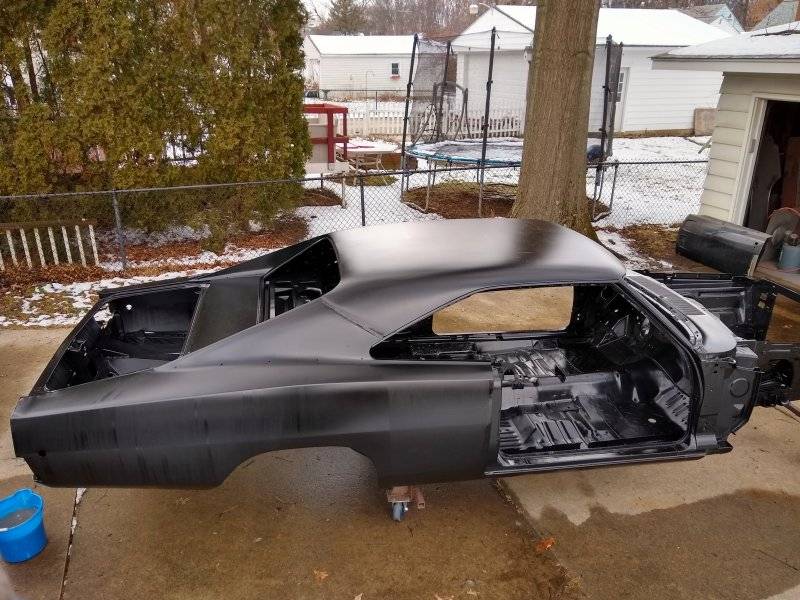

The car looks great! The metal replacement part of the project is tedious but very rewarding. Looks like we had our cars dipped and e coated at the same place...
Yes, same place. Across the highway from Detroit airport.

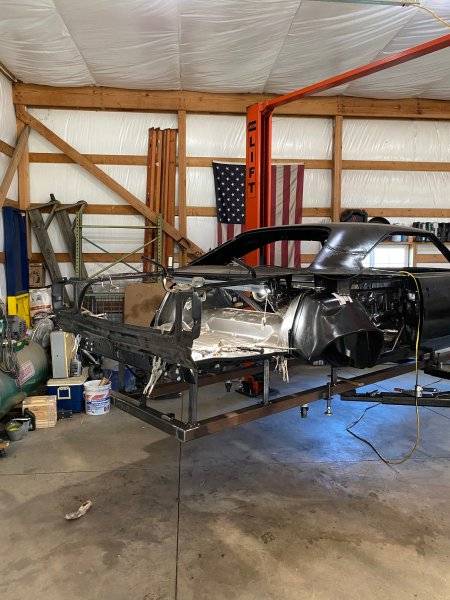

Process of fitting new metal has begun. Lots of tweaking remains, but making progress.

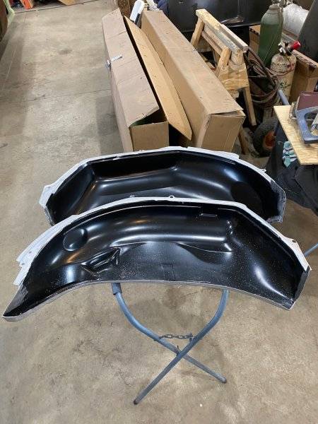

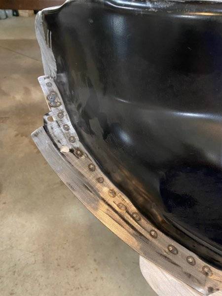

Progress update. After fitting wheelhouses, trunk floor, rear panel and quarters, we drove tech screws into each panel as locators before removing so we put back on in same location. We then pulled everything off to start welding.

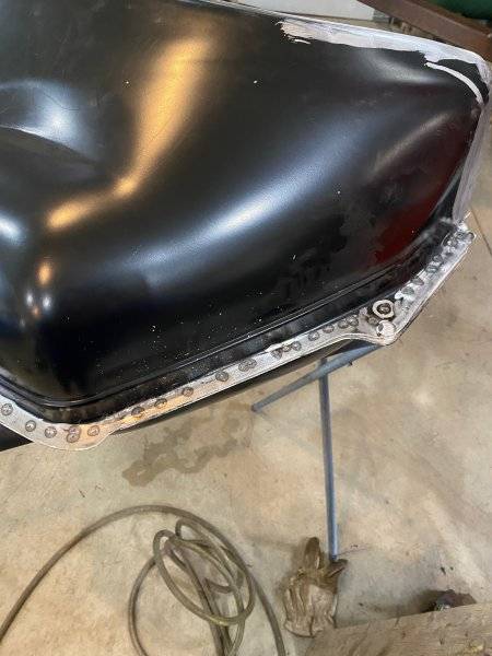

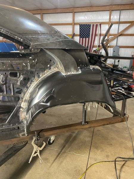

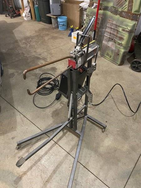

Started with wheelhouses , cleaned metal, applied weld thru primer, installed screws and welded. We were fortunate enough to know someone who has a spot welder so we used that.
The spot welder made it really nice for marrying up the inner and outer wheelhouses. It saves a ton of time obviously.
Then we used screw locations to mount back on car and wire welded in place.
Next step is to prep trunk pan and weld in.
Your project is coming along nicely. Looks like we’ve done just about same amount of work as each other. I also used a spot welder on my wheelhouses. Saved a ton of work and time.

Did your friend make that jig himself for the spotwelder? It's a pretty cool idea using the foot pedal to activate the spot welder and putting pressure on the welds to hold them tight. Impressive.
Yes he did. He’s a lot more advanced with doing metal work and fabrication. Just glad to know him and be able to borrow.
