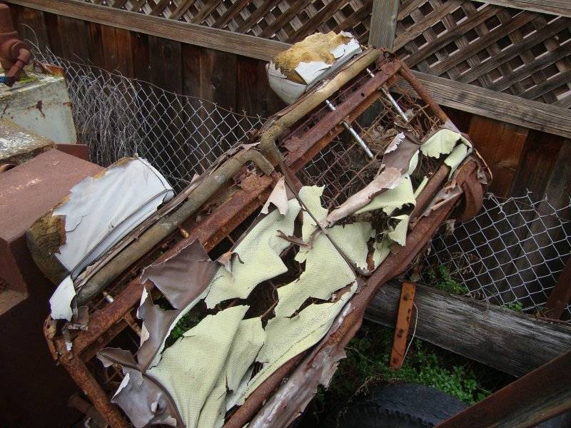

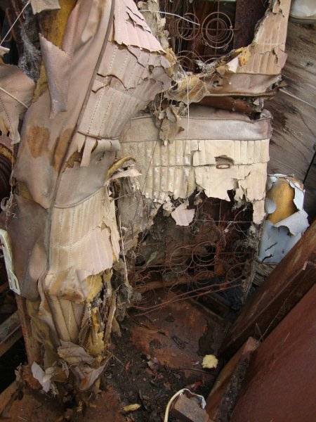

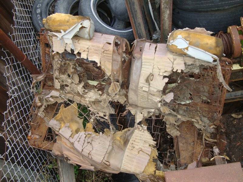

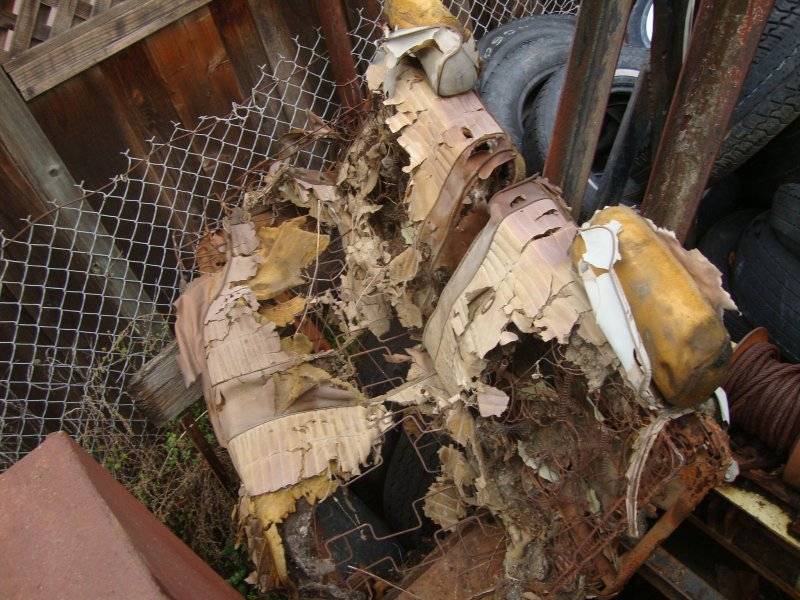

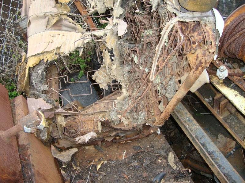

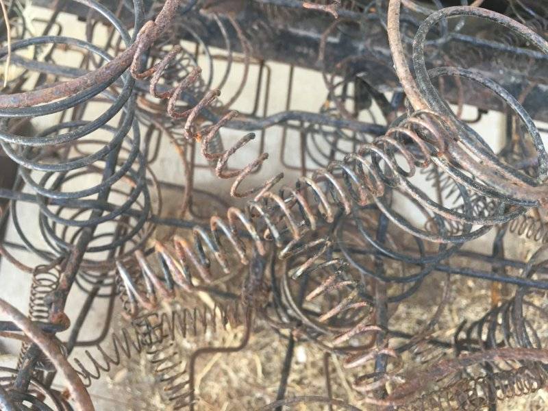

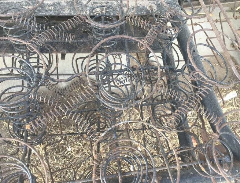

I posted a very similar post a while back, but never really got an answer. I am looking for the cross (connector) springs for the upper seat backs. Tried a few spring suppliers, but nobody had what I was looking for. Is there any alternative to Springs? These are what I am looking for. There is a total of 24 per seat back. So I would need a total of 48. The springs are approximately 3 1/2 - 4 inches long x 1/2 diameter.
Any help is appreciated. Thanks

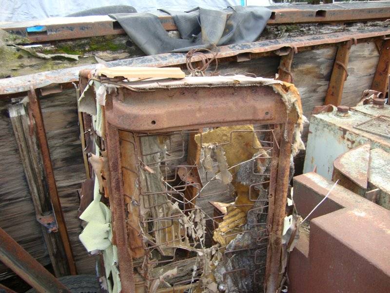

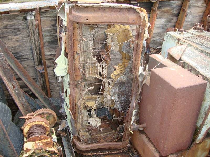

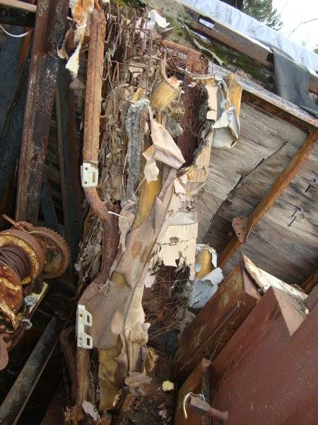

Could get a Mopar bench seat say a C body and get whatcha need
I am not sure if they would be the same......
but I have a 68 or 69 4dr front seat that could be dissected for parts. I can take a look for you hopefully tomorrow.

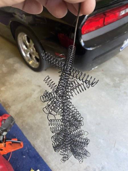

I ordered McMaster Carr compression springs and made my own for my 68 Road Runner.
Part number 9662K22, 36" long .500 OD .404 ID
I bought 6 packs and replaced most of mine three years ago. Just need to cut to length you need. Holding up great.

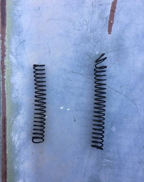

These are the springs I went with. Worked out perfectly. These have to be as close to original as there is. Thank you again for all the help.
These are the springs I went with. Worked out perfectly. These have to be as close to original as there is Thank you again for all the help.
No problem, glad they worked for you as well.
