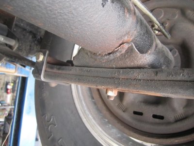

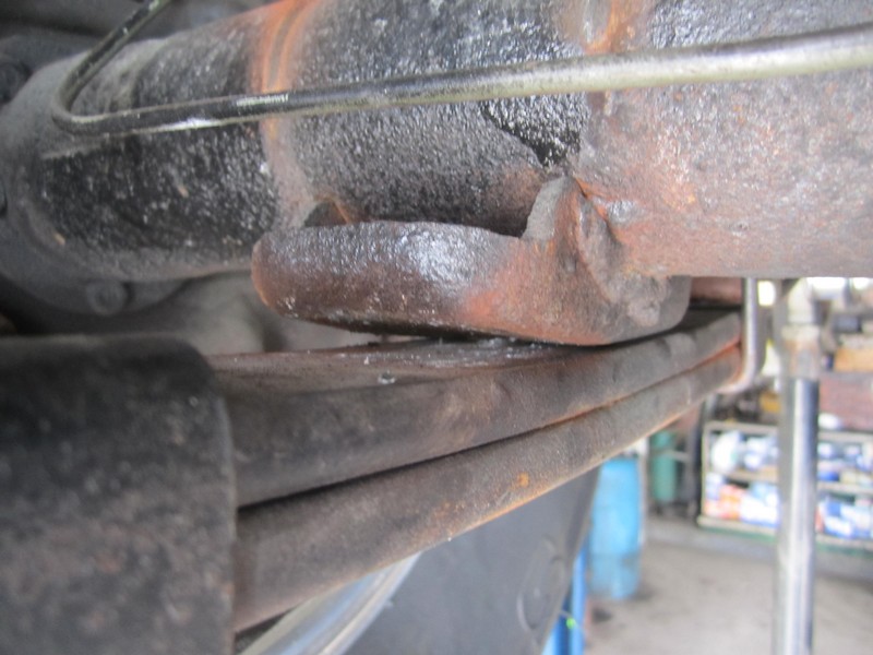

Take a good look at the rear spring perches,had the same issue at South Mountain Dragway.
Bent up the left spring perch!
