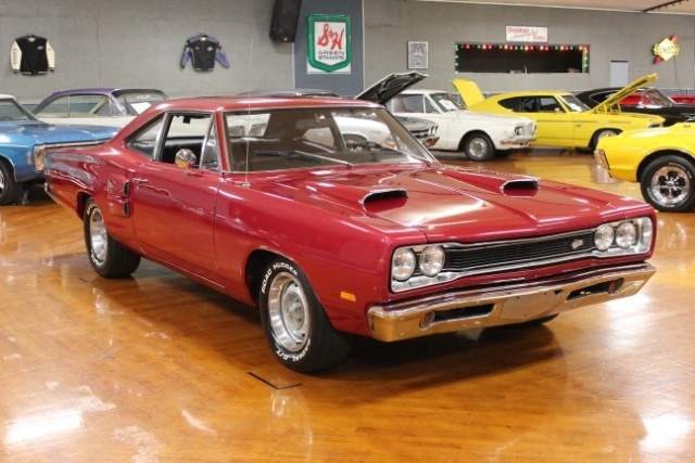

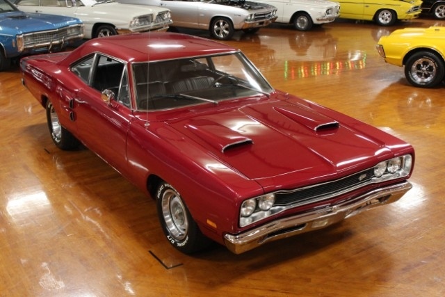

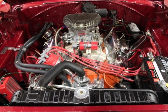

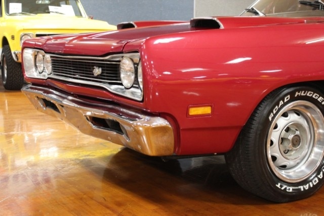

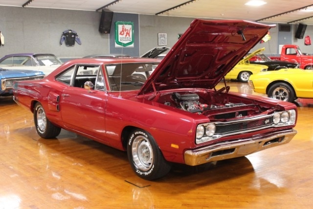

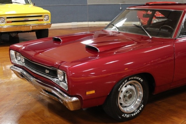

Btw, here are some teaser pics...
that car looks far from original.
there is a fendertag that should list the major option codes that came with the car.
the vin will just identify the model,engine size and plant that it was built at.
post up the numbers and someone here can decode it for you..
Yes, it has been re-painted and restored as needed. Fender tag under the hood correct? Is it the tag on the left next to the engine?
repainted and modified..lol
restored means back to original.
the rims and under the hood are far from that.
the fender tag is on the drivers side inner fender under the hood.

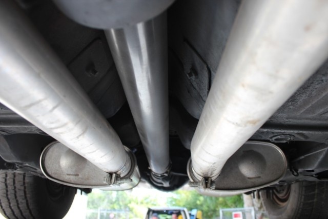

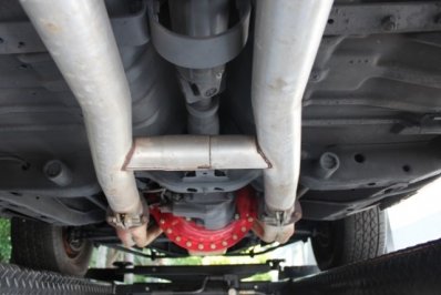

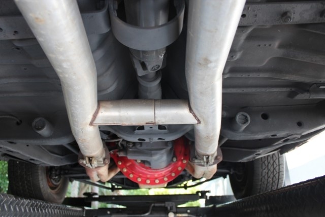

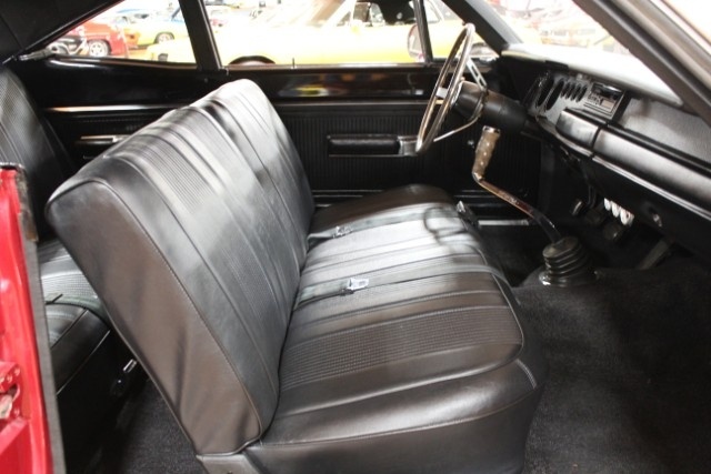

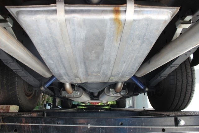

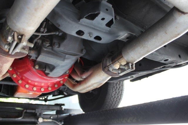

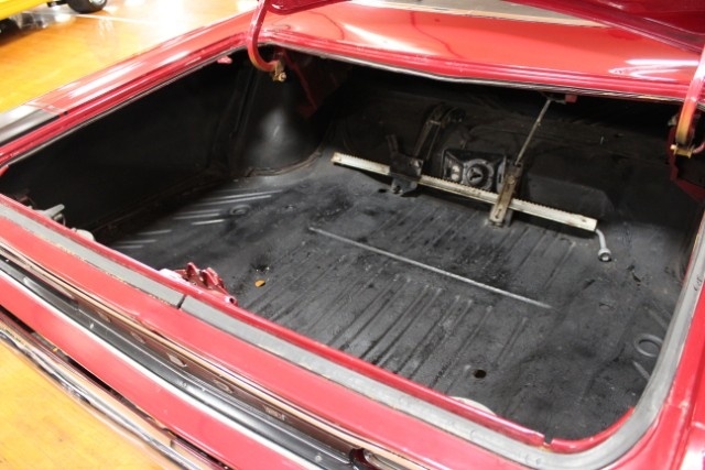

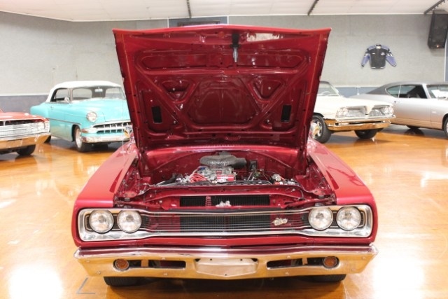

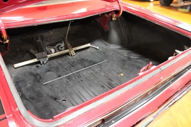

Sorry. Semantics. Yes, restomodded. Not the original 440 for example. Here are some more pics..
Front Seat Passenger Side.jpg Hood Up 2.jpg Hood Up.jpg Inside Trunk 2.jpg Inside Trunk 3.jpg Left Front Fender Lower.jpg Left Front Fender.jpg Left Quarter Up High.jpg
I would take one of those cheep mini cameras you can buy and view on your phone and put in every open hole in the frame and in any small space. Especially where there is no fresh black undercoating. If that undercoating is very thick & soft. It's hiding something. Do they have a history of the restomod? Will they give you the name of the shop that completed it?
