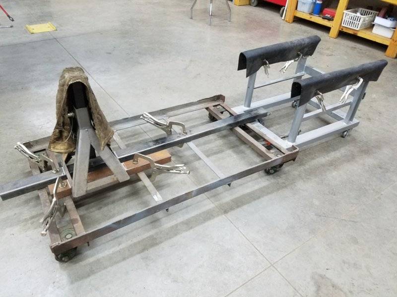

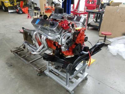

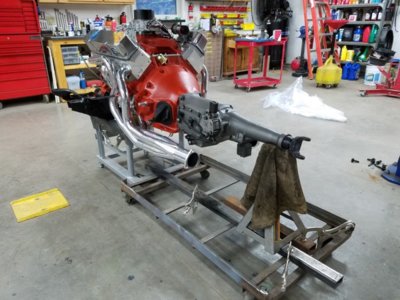

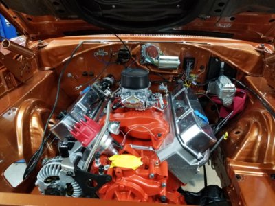

Very productive Friday afternoon and Saturday for me. Another first for me on this car. Decided to install the motor and trans from underneath. Cobbled up a roller from one of my engine stands and clamped another cart behind that. Doesn't look pretty, but it did the job. I will say, if the suspension is apart, this is definitely the easiest way to install a motor. Don't have to take the hood off, worry about scratching paint, no working over your head to install the flywheel, clutch, and transmission. And the header install is the smoothest install I have ever done.

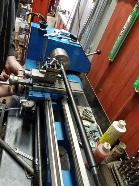

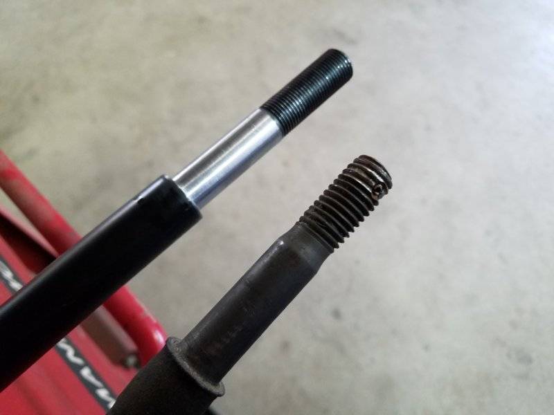

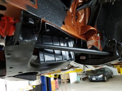

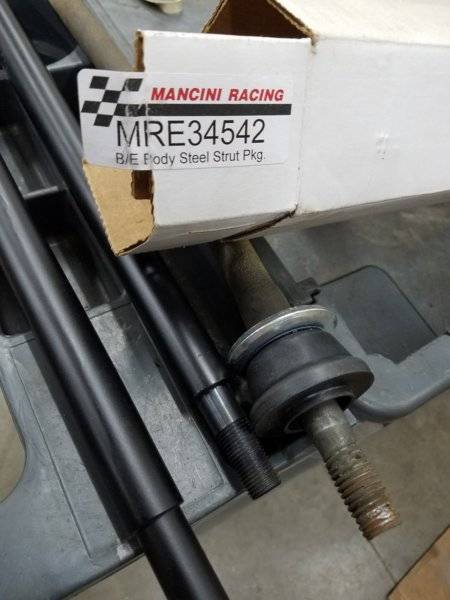

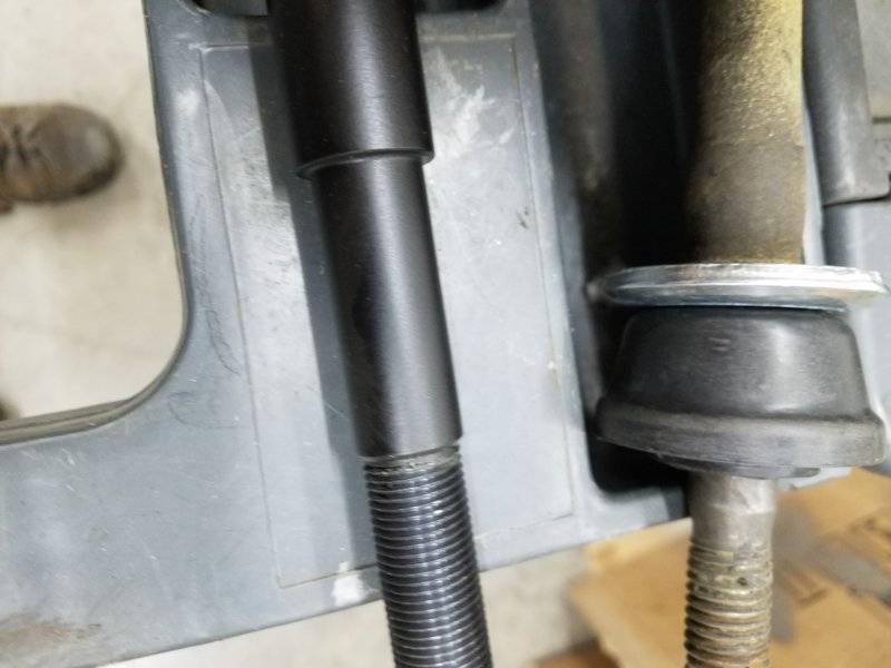

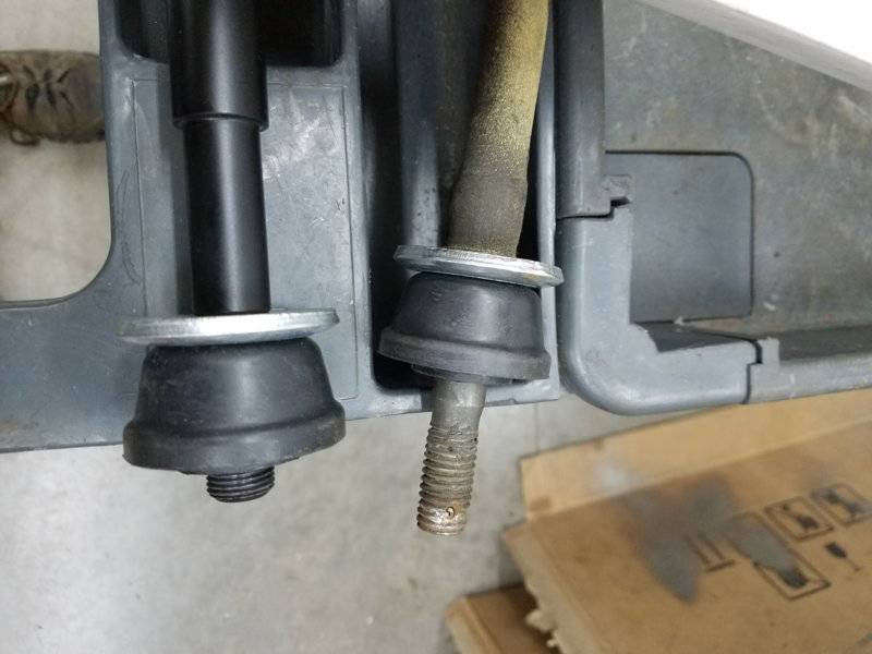

One of my original strut rods was bent, so instead of finding another used one I decided to get a new pair from Mancini. Advertised to fit as stock except thicker main shaft. I blasted, primed, and painted them last fall and set them aside. Go to install them today and low and behold, they wont fit. Everything was fine except the area where the bushing goes was to big. Had to find a friend with a lathe and take .060" off. This is the way things seem to go for me on these old cars. Spent a good chunk of the day just getting strut rods and lower control arms bolted to the car.

Installing the engine from underneath is the way to go; I did the same on the Coronet. BTW, where did you get the plastic splash guards and rivets?

super job hunt, what brand headers you have and how do they fit? what motor mounts did you use? is it a good fit with ramcharger and intake? thanks
TTI headers and they fit great. One spot on the passenger side where they are real close to a boss on the bell housing. I always just grind a tad off that for good measure. This is the 4th car I have used TTI's on and every one has been touching there. Other than that, ample room everywhere.
Moroso solid mounts.
I just ordered a 440 ramcharger air cleaner base because I didnt want to cut my original 383 one. I knew this was going to be an issue because the Weiand intake is 1/2" taller that stock.
