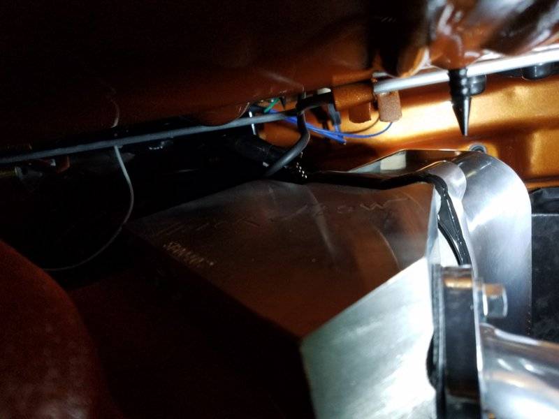

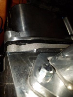

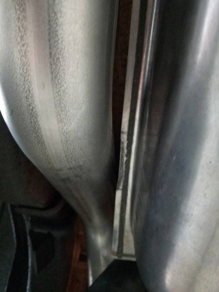

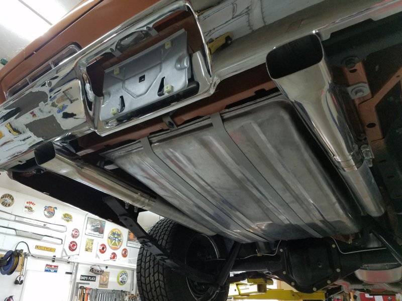

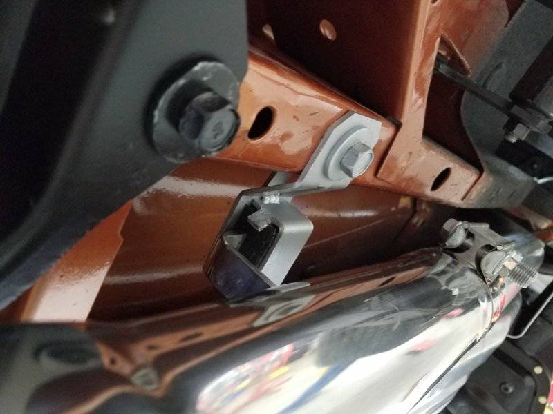

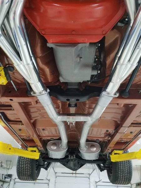

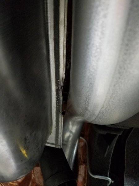

I also had to bend the gas tank flange to clear the 3" exhaust. Not much room back there.Also the first time I have used TTI's 3 inch exhaust. Definitely a lot tighter than their 2.5 inch stuff. Worst area is the tailpipe to gas tank area on both sides. Ended up bending the flange of my tank for better clearance. Otherwise, it fit real nice. I always cut off the ends and use Accurate tips because I like them better. One note with TTI exhaust is that they don't make the correct rear hanger, so they send a Charger style instead with all their 68-70 B body kits. I got the right ones from Mega.
View attachment 903085 View attachment 903086 View attachment 903087 View attachment 903088 View attachment 903089
There sure isn't. Did you insulate your fuel line on the high side of the passenger pipe?I also had to bend the gas tank flange to clear the 3" exhaust. Not much room back there.
Stop this madness.. you're making my car look bad!![]()
I did on mine, I also plan to put some on the gas tank next to the tail pipes.There sure isn't. Did you insulate your fuel line on the high side of the passenger pipe?

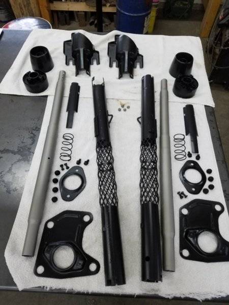

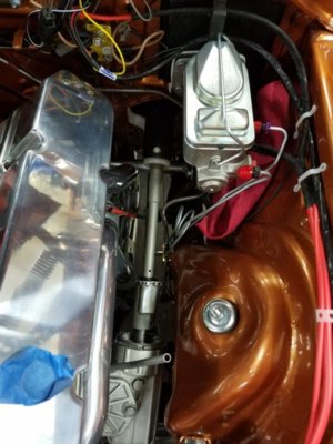

I have a spare upper column bearing if you want it.Forgot to take pics of the steering column rebuild except for this one. The car came with power steering sector, but I am not positive that is what it was born with. I like manual steering better, so that is the route I went. Painted them the correct textured black. Ended up with enough pieces to do 2 of them, so I have a spare.
One was good and I bought a new one for the other column, so I should be good. Thanks for asking though.I have a spare upper column bearing if you want it.
One was good and I bought a new one for the other column, so I should be good. Thanks for asking though.[/QUOTE the bee is coming very fast,you are serious about finishing your car,looking at your steering column parts,mine did not have the little spring, is there anyone that sells those,how important are they to to column? thanks
I was just searching for info on these bearings. Mine is shot in my 68, turning the steering wheel is like nails on a chalk board ! Do you still have this ? Or a part number for me to look up ? ThanksI have a spare upper column bearing if you want it.
It's in a box in the garage. PM your address.I was just searching for info on these bearings. Mine is shot in my 68, turning the steering wheel is like nails on a chalk board ! Do you still have this ? Or a part number for me to look up ? Thanks
hunt,did you install mufflers so they will touch the floor or did you leave a little space between floor and mufflers.thanksIt's in a box in the garage. PM your address.
https://www.megapartsusa.com/proddetail.asp?prod=123-SCB656
You never want any portion of your exhaust touching any part of the body.hunt,did you install mufflers so they will touch the floor or did you leave a little space between floor and mufflers.thanks
Fully agree.You never want any portion of your exhaust touching any part of the body.
