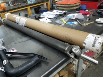

    On a positive note, the new Strange driveshaft showed up.

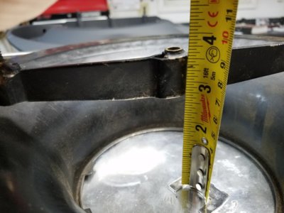

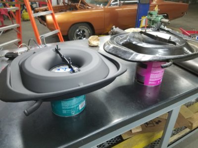

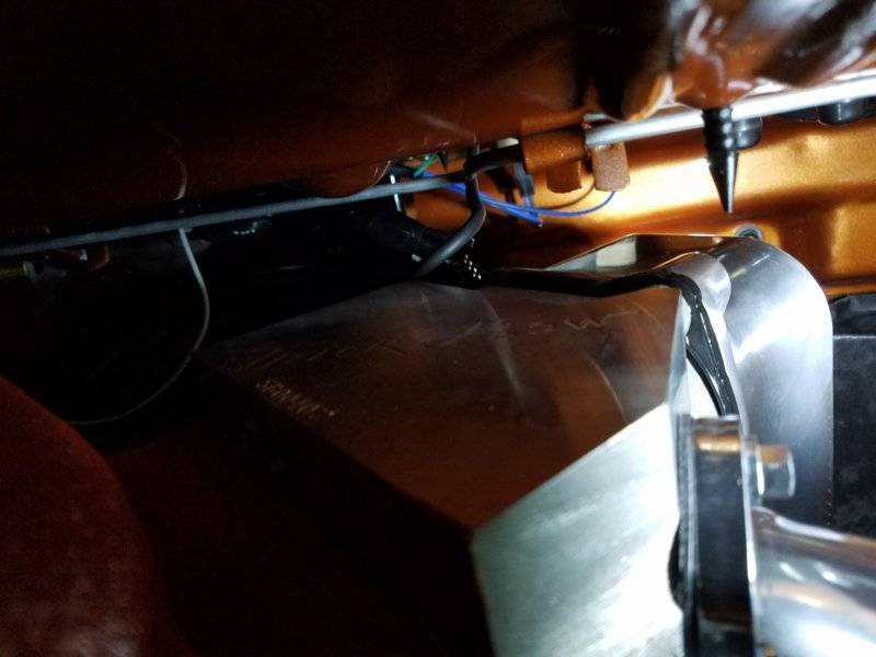

                  The correct 440 air cleaner base showed up from PG Classics today. So if anybody is fighting with hood clearance with an aftermarket intake on a Ramcharger or Airgrabber hood, the 440 base measures 11/16" shorter than a 383 model. To wore out from work today to find out if it will work with my Weiand intake, but hopefully will find out this weekend.

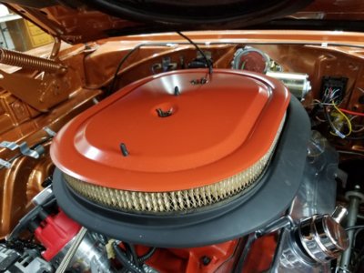

                    Looks to be 1/2" more hood clearance. Is that right?

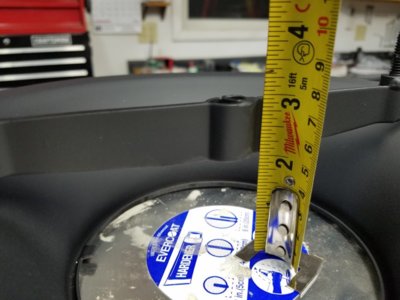

                    The measurement from the crossbar to the carb mounting point is 11/16" shorter on the 440 model. However when I compare the measurements from the carb mounting point to the base where the bottom of the filter sets, it is only about 7/16" in favor of the 440 model.

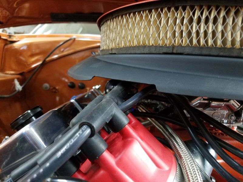

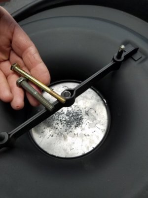

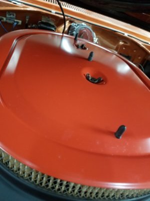

                      Just got done playing around with the air filter setup. I first had to bend the 2 small tabs on the base up and then drill out the bolt hole sleeve for 516" to fit my Quick Fuel carb. I used the thin style carb base gasket instead of the 1/4" model I usually use. Also used the PG top cover instead of my original because it is not formed quite the same and is a tad shorter when installed. Used some dumdum on the lid to check clearance. I have 7/8" in the center high spot, making me very happy. I could even put my thicker carb spacer in if I want seeing as though I am running solid motor mounts. These measurements are with a 400 block, solid mounts, and a Weiand Action + 8008 intake. They would be very similiar if using a standard Edelbrock Performer as that and my intake are about 1/2" taller than stock.

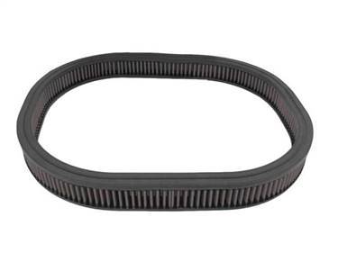

                        Have you had the chance to compare the paper filter to the K&N filter height?

                        I have not. 2 filters came with the car, but I will need to buy something else. I thought somebody said K&N quit making the oval filters?

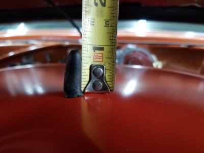

                        I have a K&N, I could measure it tonight if you like? I think they are very close to OEM.

                        69 GTX FBBO Gold Member FBBO Gold Member
                        Messages:
                        6,165
                        Likes Received:
                        5654
                        Joined:
                        Apr 6, 2013
                        Location:
                        Milo, Iowa
                        Local Time:
                        4:36 PM
                        • Thanks! Thanks! x 1

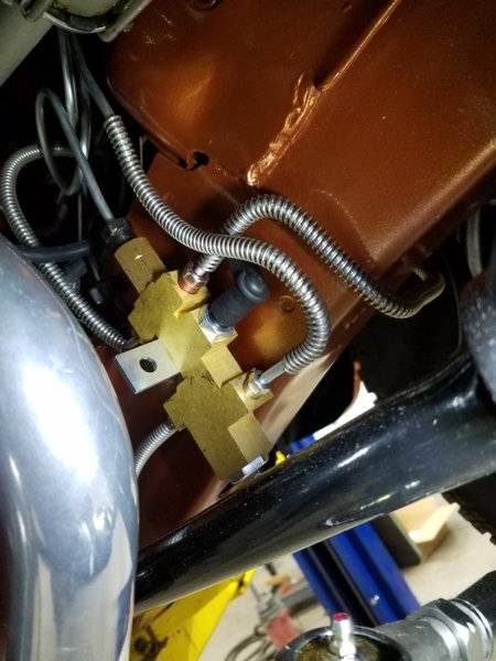

                          Success!! A proportional valve back in place AND dry. But get this. When the new valve came I decided to take it apart to be sure it wasn't bad also. This one had a burr on the top nut that would have prevented it from sealing. So I used the new body along with my first nut. Just crazy how poor quality control has gotten on parts nowadays.

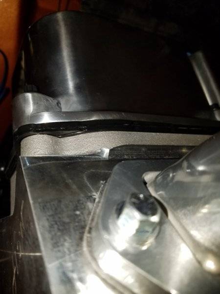

                            Oh, don't get to excited yet. I think I have a leak on one of the welds of my brand new Miloden Road/Race pan....
