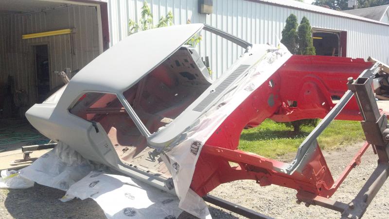

The new shoes for the Bee were delivered this week. I still don't have the shell/body home yet to put K frame or rear end back beneath it. Every week, I'm getting $100 off of draw #2's bill. It's all part of the contract. I'm guessing I should have it back in 2 more weeks. The owner of the shop is doing the work now. What I've seen looks real good. I may go get a pitcure or two today, since its been a week.

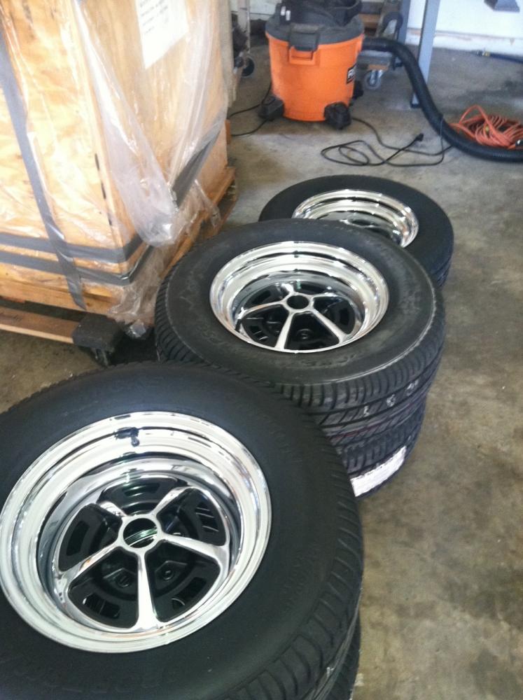

What size tires and wheels are you running, what name brands.
MAG 500 15X8 5X4.5 4.5RS $137.95
MT SPORTSMAN S/T P275/60R15 $139.99
MAG 500 15X7 5X4.5 4.25RS $137.95
MT SPORTSMAN S/T P225/70R15 $122.99
Mickey Thompson

So.. Heres a picture.. Saturday June 1. Two more weeks for color? PLEASE!!!!!!????? On a better note I get $900 off of the second draw when it does see color for being 9 weeks late (if I get it back bynext Friday)

Just an update... So.. Heres a picture.. Saturday June 1. Two more weeks for color? PLEASE!!!!!!????? On a better note I get $900 off of the second draw when it does see color for being 9 weeks late (if I get it back bynext Friday)
Good to see you got a discount & performance clause written into your Body Shop/Paint contract, it helps keep them on their toes, if they stall too long, they get much less profit, make for some motivation... I make it a practice when dealing with any type of outsourced labor of any kind, I do it allot in my business with construction projects or you get guys/subcontractors {also fabricators are notorious for stall tactics}, some who seem to get lazy, right after the 1st couple of big draws & start to tapper off in performance... Your cars looking good, hope they follow thru in the next couple weeks & do a great job for you...

Here is where the car is: The shell on the rotisserie is been blocked several times and ready for paint. The 2 doors, 2 quarters, trunk lid and hood are in epoxy primer. One front fender has 2 half dollar size dings on the top. The hood has about a 12" x 1/8" crease in the middle but not over the center line. The doors need very little and the trunk lid needs very little.
