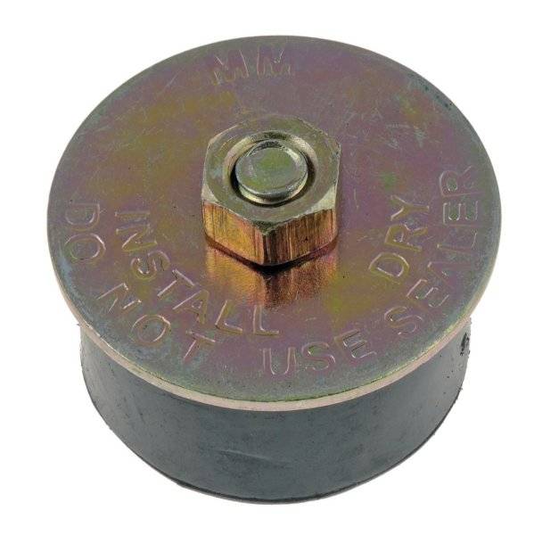

Like mentioned above get the old one out and install one of these….

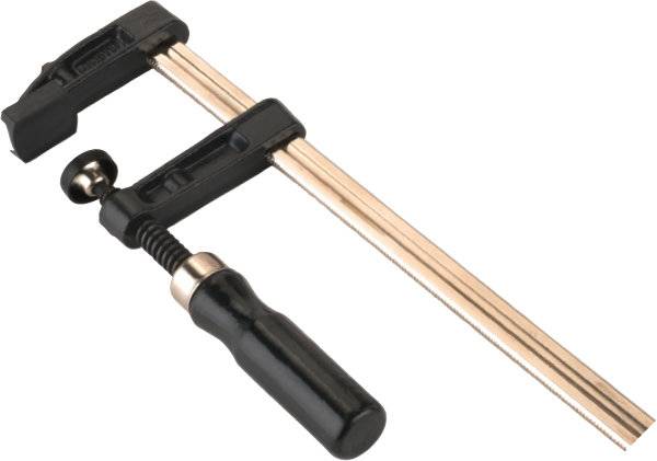

As for replacement, a long carpenters clamp from one end of the head to the other.. a socket to fit inside the plug and then crank it into place.
That or a 2 x 4 across the firewall and a crow foot pry bar pushing on a socket.. pushing on the new plug.
I have thought about the rubber plug but I thought it was only of temporary use? Like to get you home from a road trip one time? thoughts about a rubber plug for spring cruising? been a 2 year project, I would love to finally get a spring cruise out of her?
"a 2 x 4 across the firewall and a crow foot pry bar pushing on a socket.. pushing on the new plug"
I was thinking about something just like this!
Great suggestion Dads, similar action to my okie jackscrew solution! I'll remember that. It doesn't (shouldn't?) take much force to press in the new plug.
I had a friend of mine use one for YEARS on a block that was cracked and welded on the side near the core plug. He was afraid to put a steel plug in there from the weld job going right into the core hole with pins there. NO issues at all and was street car that he raced it for many years with that in it.

This is a perfect example of why I refuse to install brass freeze plugs in a motor. If they are not installed properly and perfectly, this is the result. I ONLY install steel freeze plugs, with the proper Heinkel/Loc-Tite product to seal them. Install the rubber plug as it will be the easiest fix, quite honestly, will last quite a long while, until the rubber starts to dry out. I would assume, by that time, you will have pulled the heads or motor by then. I would suggest you keep an eye on the other brass freeze plugs as the same could happen to any of the rest of them.
This is a perfect example of why I refuse to install brass freeze plugs in a motor. If they are not installed properly and perfectly, this is the result. I ONLY install steel freeze plugs, with the . Install the rubber plug as it will be the easiest fix, quite honestly, will last quite a long while, until the rubberproper Heinkel/Loc-Tite product to seal them starts to dry out. I would assume, by that time, you will have pulled the heads or motor by then. I would suggest you keep an eye on the other brass freeze plugs as the same could happen to any of the rest of them.
I understand "install dry" so I should drain coolant below this level and blow out with compressed air and dry out with a hair dryer and, for days after sitting? It has pumped out a lot of coolant (2nd time She has bled out in front of me, same mechanic failed to tighten a transmission hose clamp and it blew out (small town no one else wanted to do this job)), my poor Birdie

I would not be that technical with it.. Lower the level and make sure it's clean and install and refill and drive it...
I am going to do the rubber for now and source 340 heads for a winter project. I pulled the heads on my 1972 Olds 98 455 in 1977 so I think I can do it on a LA.
I also ran a rubber plug for years without issues.....and recently installed one on my Durango
