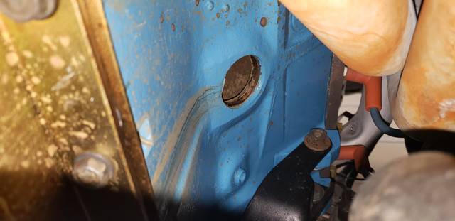

Drips of water on the garage floor after I parked the car. This is on my fresh 505 engine. The short block was assembled at the machine shop. The engine is fantastic by the way. Pulls like a freight train! I have only put about about 40 miles on it so far before this.
So, a freeze plug on the passenger side is missing. Coolant gone, freeze plug blew out somewhere during the drive. I got on the car about 2 miles from home, I can only guess that is when the freeze plug came out. There were no leaks prior to this drive. I am super pissed at the machine shop that put the short block together. I hope there is no damage to the new engine.
I am ordering a set of Milodon brass freeze plugs. Any issues with these? Anything brand better to use?
For sealant , what is the best to use on freeze plugs?
Loctite #540 is the best, but it's expensive. My second choice is Permatex. #1. Just don't use silicone. The Milodon hardware is as good as any you'll find. Brass is better than steel.

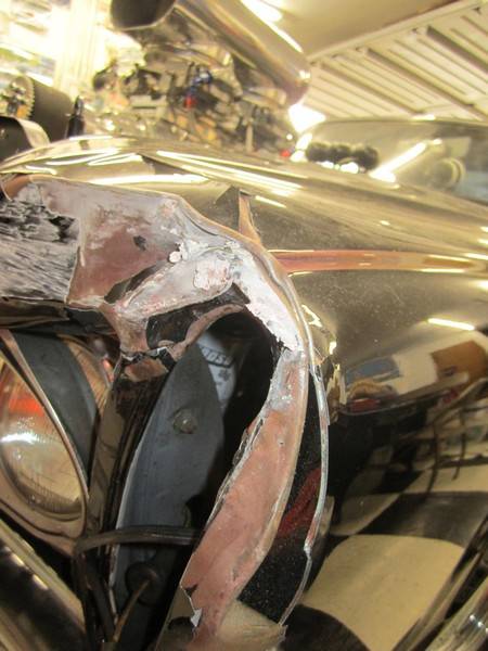

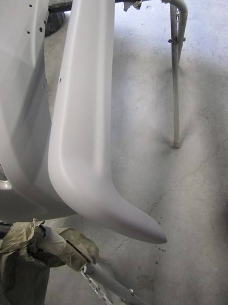

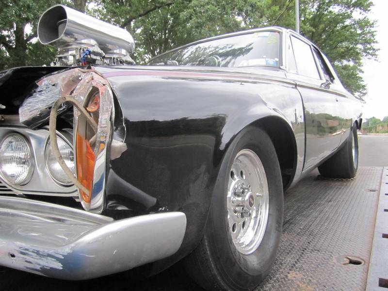

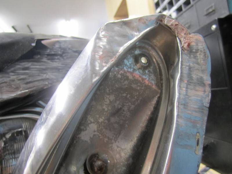

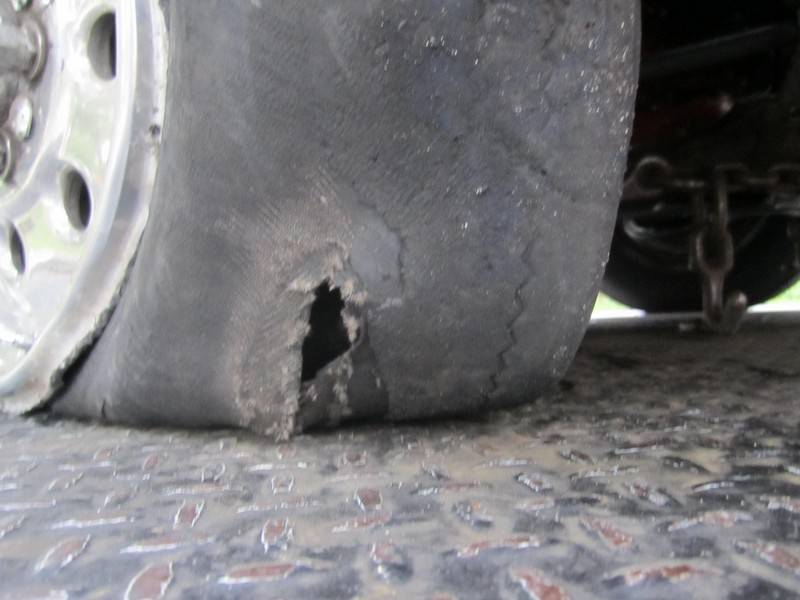

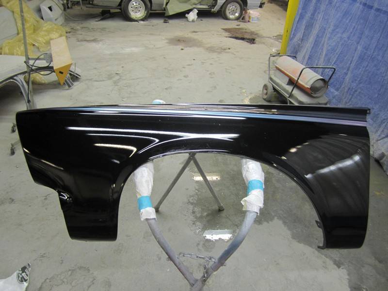

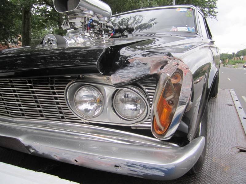

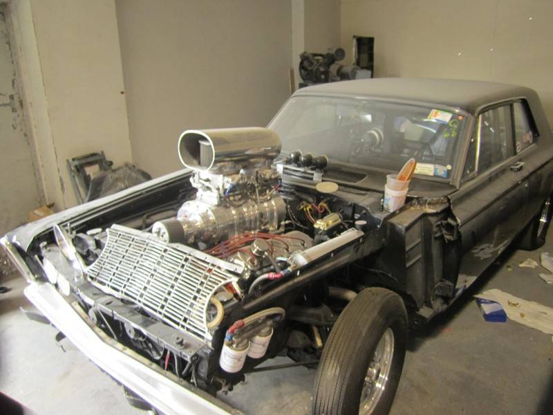

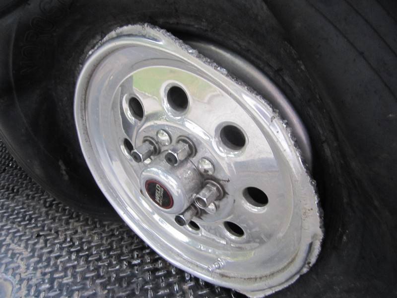

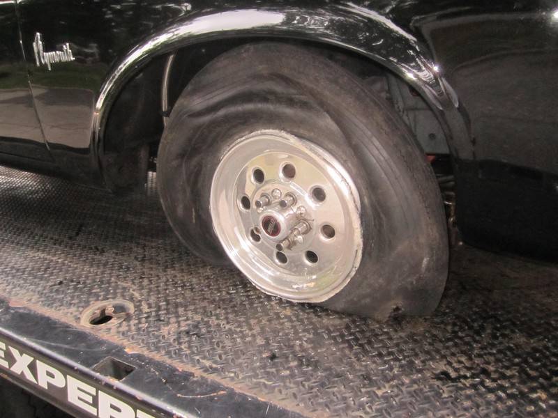

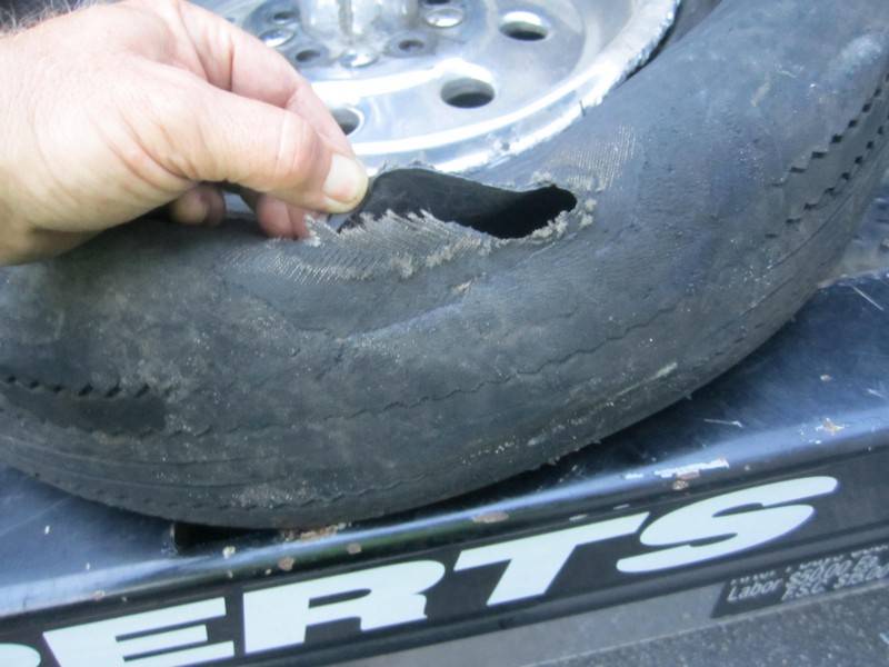

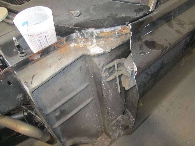

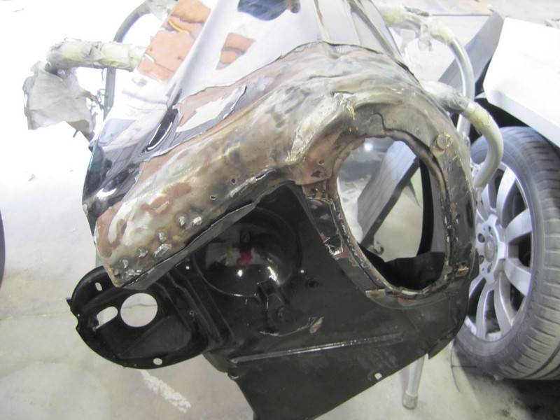

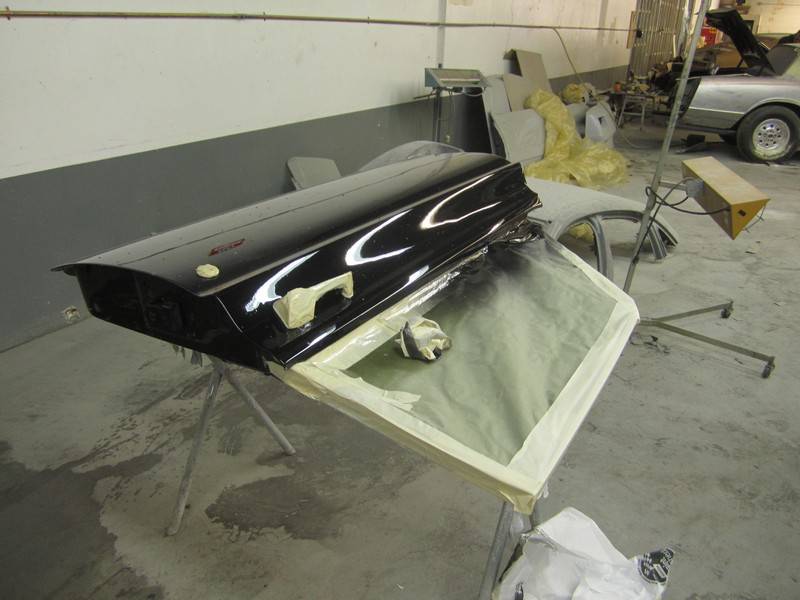

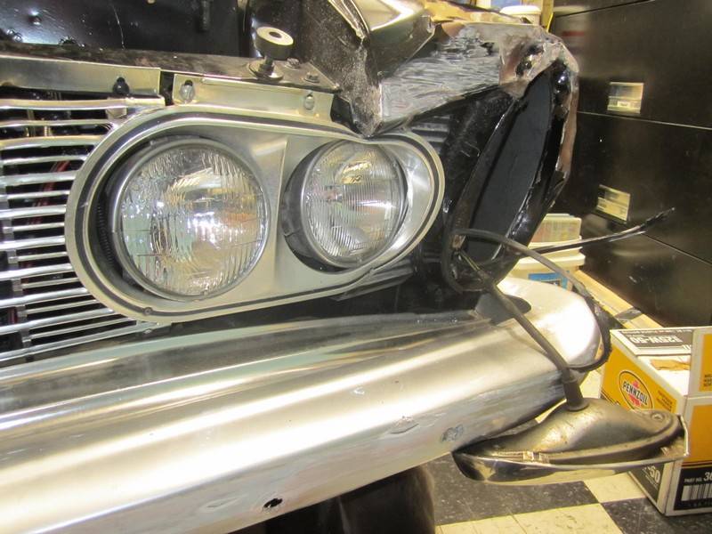

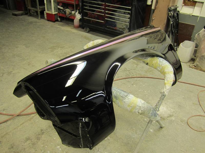

I blew a right rear freeze plug on my 9 second license pass.Car rotated left and I tagged the wall.Went over the stripe sideways and still went 10.80 @ 87 MPH.
You are a lucky guy !!
7.28.13 184.jpg 7.28.13 185.jpg 7.28.13 188.jpg 7.28.13 189.jpg 7.28.13 190.jpg 7.28.13 194.jpg 8.18.13 034.jpg 8.18.13 035.jpg 8.18.13 038.jpg 8.18.13 061.jpg
That buffed out nicely!
Glad you weren't hurt!
Right?
At least it's one of the "easy" ones to replace.

Core plugs shouldn't "fall out". Rust out ,yes. Cylinder pressure in the coolant system, possibly. Either the block hole is damaged or the plug wasn't installed correctly. The lip of the plug should be below the chamfer of the block hole. it needs to be square in the hole. Sealer may help weepage due to pitting, but it wont hold it in.
