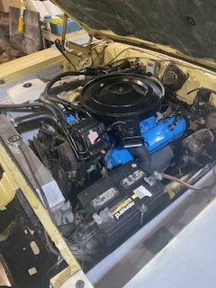

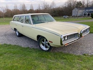

I'm trying to find someone in northern Ohio willing to tackle the rebuild on my 70 Coronet wagon's 383. It's developed a rod knock so while it still runs, it's not happy. The only issue is that I do not have the equipment to pull the engine which is why I'm running into trouble finding a shop. It seems no one wants the whole car - just the engine.
I'm in the Cleveland area but beggars can't be choosers!
Any recommendations?

Very clean looking car. The more you can do will save lots of money in the end. This is only if you have room at your place to do it. You will have to spend money for a hoist. Got one from harbor freight not bad price. Hydraulic cylinder to make it lift Eazy Peezy. This where you find out if you really have friends or not. :lol:
Curious. How did you determine it has a rod knock?
I agree, and that being an unusual car (Nice by the way) could possibly be an original mileage car. If it still has, by chance the original timing set. Losing a couple teeth on a nylon gear sounds just like a rod knock. Think I would do a stethoscope ck to pinpoint location of your sound. Just a thought.:popcorn2:
And a few people have had the fuel pump come apart.
Thanks gang...I hear you...I need to get the engine out of the car. I have a cherry picker and a fairly full compliment of tools so I will look into what it'll take to remove the engine. My expertise is with six cylinder Continental Red Seal engines in older Kaisers and removing them seems much simpler - remove the dog house and lift the engine enough to clear the frame. Pulling a much heavier eight from the Dodge will obviously take more effort.
Question for the group - should the engine and transmission come out together? Any tips or tricks to do the job right the first time?
About 25% of the initial rod knock diagnoses in my experience turn out to be a torque converter bolt.

I posted this video on FB of the engine running and the noise it's making. To answer a few questions - I checked the flexplate and it's not cracked or loose, the fuel pump is new and the noise increases with engine rpms. Give it a listen and feel free to comment.
