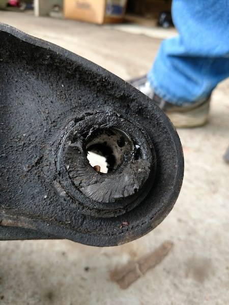

On Mopar torsion bar suspensions, the "load" is on the LOWER control arm. So, those bushings will always take the wear first. The UCA is sorta a "follower" arm. When rebuilding these suspensions, the LCA bushings should be the first thing to replace, you'd be surprised how shot they can be !

vlpJUzrmB7X64mbTQPlfGhZwn2DaMmaY5CmWX7wJUBLO-LsNF_MVr4KEcfStfoM6fQmvroos=w678-h903-no?authuser=0.jpg
Information, please? So I can keep an eye out for stuff like this during disassembly...
What would a potential fix for this be - new K frame?
I doubt it if the bushings just went recently it should be fine.
Now if you drove it for 30,000 miles well then that would be a different story.

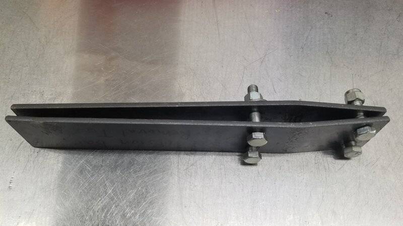

If the torsion bars have never been out, they will likely be very stubborn. You will almost certainly need a torsion bar removal tool. I made my own:
It is simply two pieces of thick steel with four holes drilled through it. Not shown, but I also wrap the bar with old inner tube material (rubber) to protect the bar from nicks. Then tighten the heck out of it. You can see by the bends mine has been tightened a bit! :D
It may help to actually go to the back of the bar and hammer it IN a little. This to jar the bar loose from where it has likely "bonded" itself to the LCA pivot. Use penetrating fluid also where the torsion bar enters the LCA as well. Then beat on the tool as close to the torsion bar as possible to beat the bars out. Use a BFH (big **** hammer) to shock it loose. Note that there is a left and right bar, so don't mix them up.
